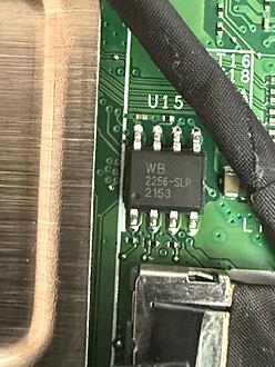

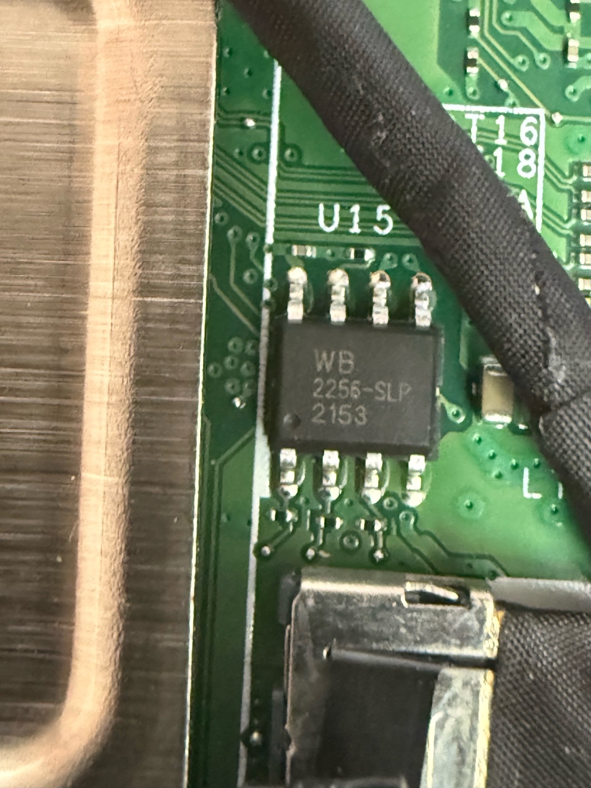

                        #51
                        Click image for larger version  Name:	8CAADFF6-399B-4265-98D0-62A5C4C2E617.jpg Views:	0 Size:	477.0 KB ID:	3714343
                        just one quick question so i wont do something terribly wrong, is this the main 32mb bios chip? cant read it with a programmer, i can read the other chip just fine but not this one
                          • 21620
                          #52
                          That`s not a bios chip, it`s a mosfet,voltage regulator or something..
                          • hoaca388
                            Badcaps
                            • Jan 2022
                            • 12243
                            #53
                            No. this is not a bios chip.

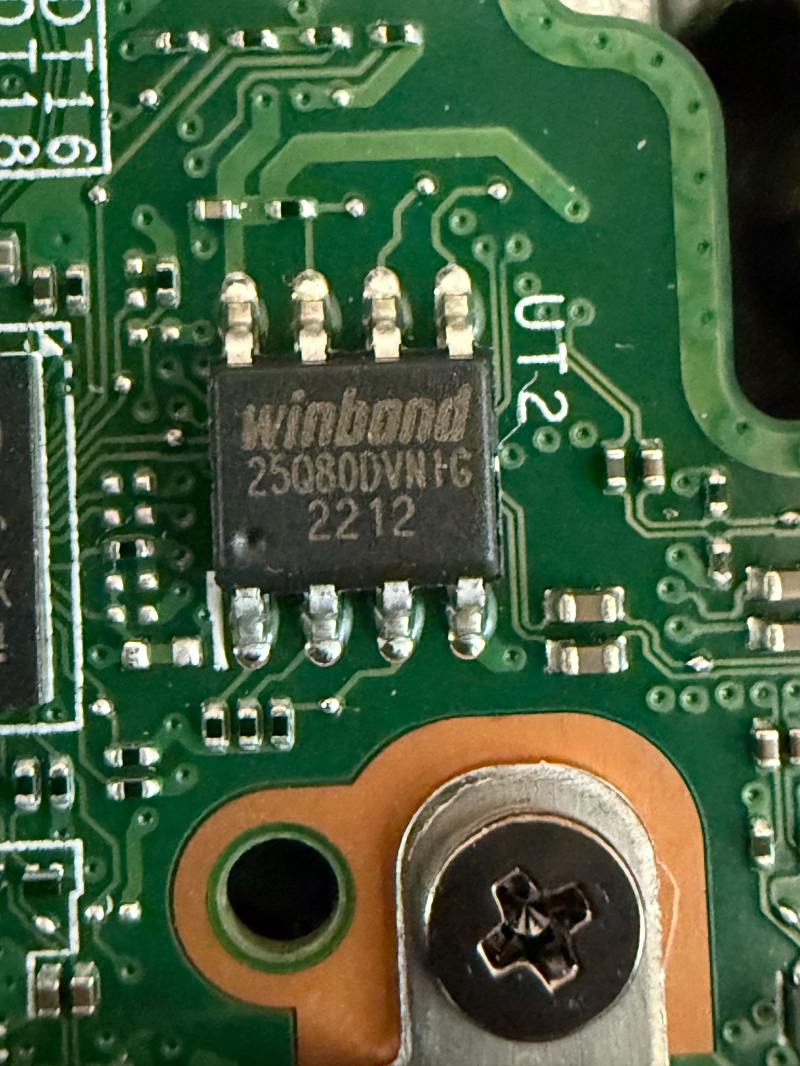

                              #54
                              ok so here is another one:
                              from my info this one is to small to be a bios chip, but i may be wrong. just to be clear we are talking about 15 G2 ITL. I dont see any other chips unless they are hidden under tape or something.
                              • davidk35
                                • Aug 2025
                                • 5
                                • Slovenia
                                #55
                                ok unless i am doing something terribly wrong. pin 1 and 8 meassure 3,24v, pin 4 out goes to ground. this is for sure not a mosfet
                                  • 21620
                                  #56
                                  That`s a 1MB firmware chip, not the bios
