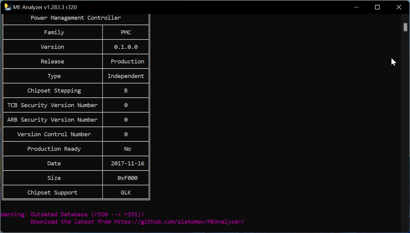

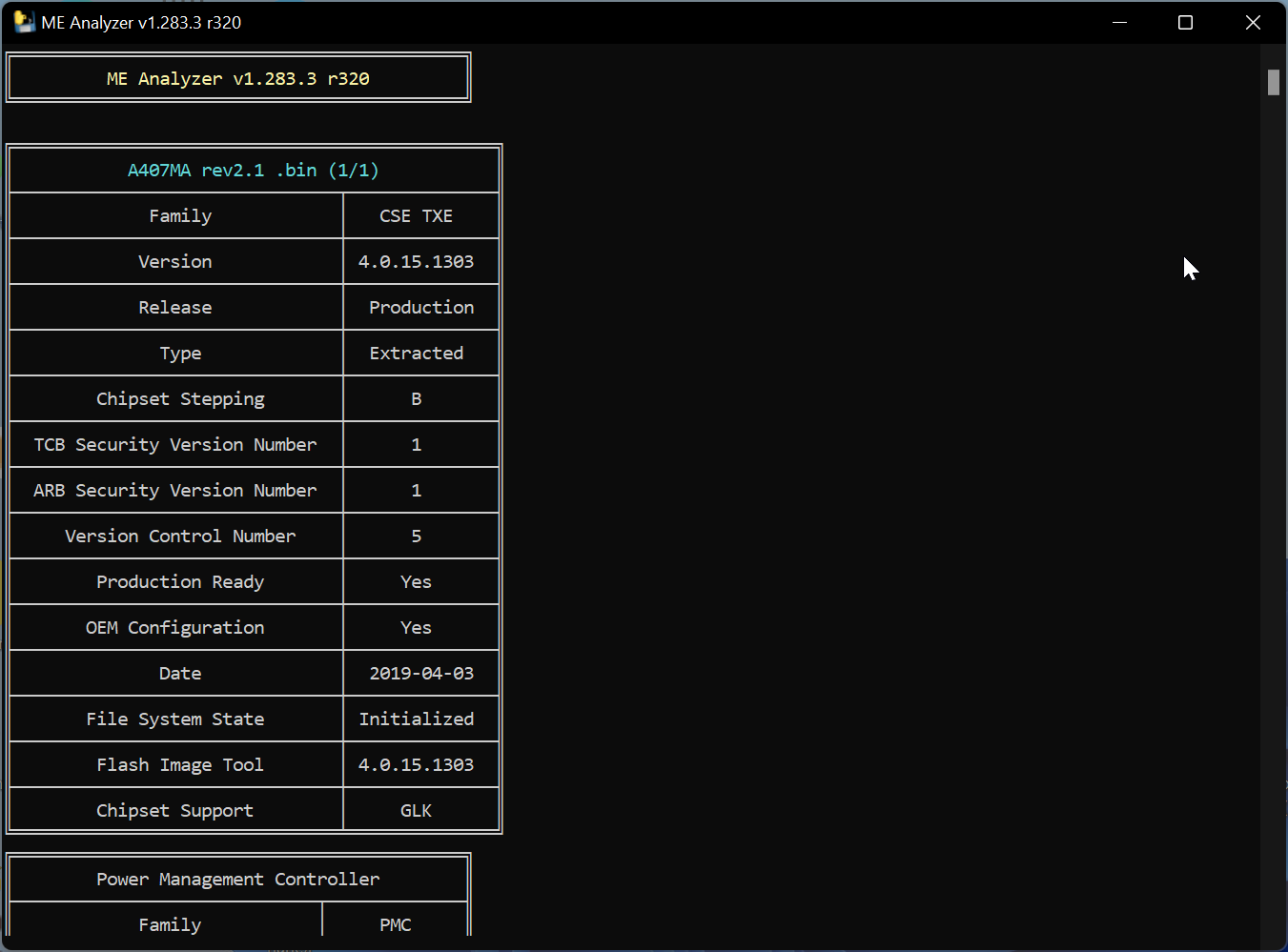

    Hello to all bios master, please i need help to fix the laptop.
    it's Asus A407MA-BV002T the current state is locked by password, i tried to follow the instruction from badcaps sticky threads but it doesn't shown anything similar after checking 'amitse'.. the region is blank.
    And after checking with ME Analyzer turns out the File System is error.
    The IC is 25Q64FWSIQ. Bios dump attached.

    No issues with the ME Analyzer here, perhaps you need to update the version:

      Thank you. it turns out outdated like you said.. thank you so much. i guess the stikcy thread need to be updated for clearing the pass, because there is no 08 like they said. i'm stuck because of that. simple solution.
      Thank you
