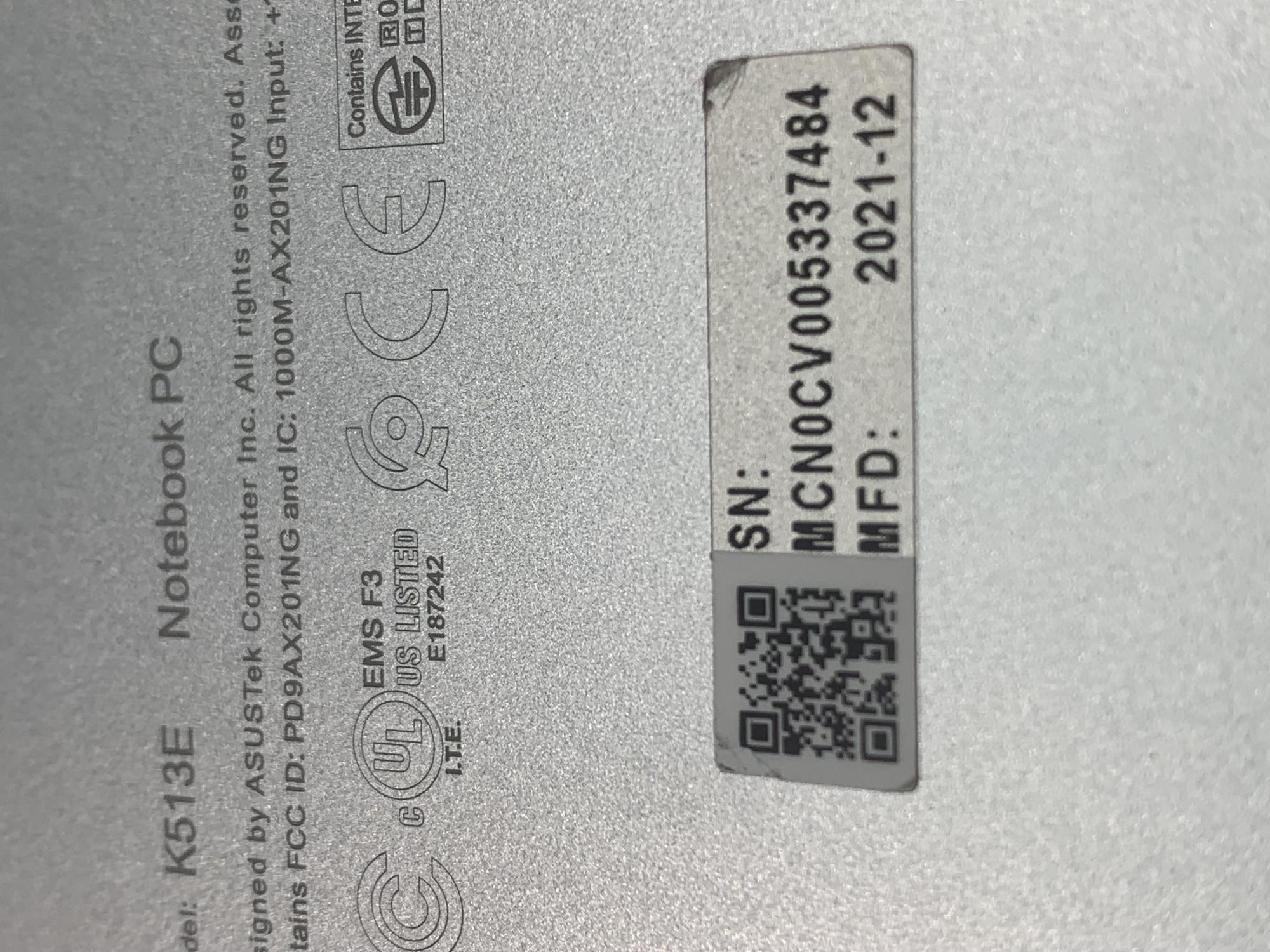

    Hi guys!
    I have this laptop which is turning on but has no image. I have attached the bios dump but I can't seem to find a working one. I also read a similar thread mentioning WBT.exe v314 but no instructions on how to use that.
    Can you please help me with a working binary that includes the DMI info from my dump? Or kick me to the right direction to try and add the DMI section myself? I used HxD on my dump and found the serial on multiple places so I am not sure what to copy.
    thank you very much in advance!

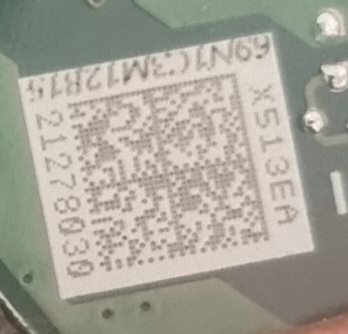

    Post the laptop serial number,also post pictures of the square white QR codes on the motherboard.

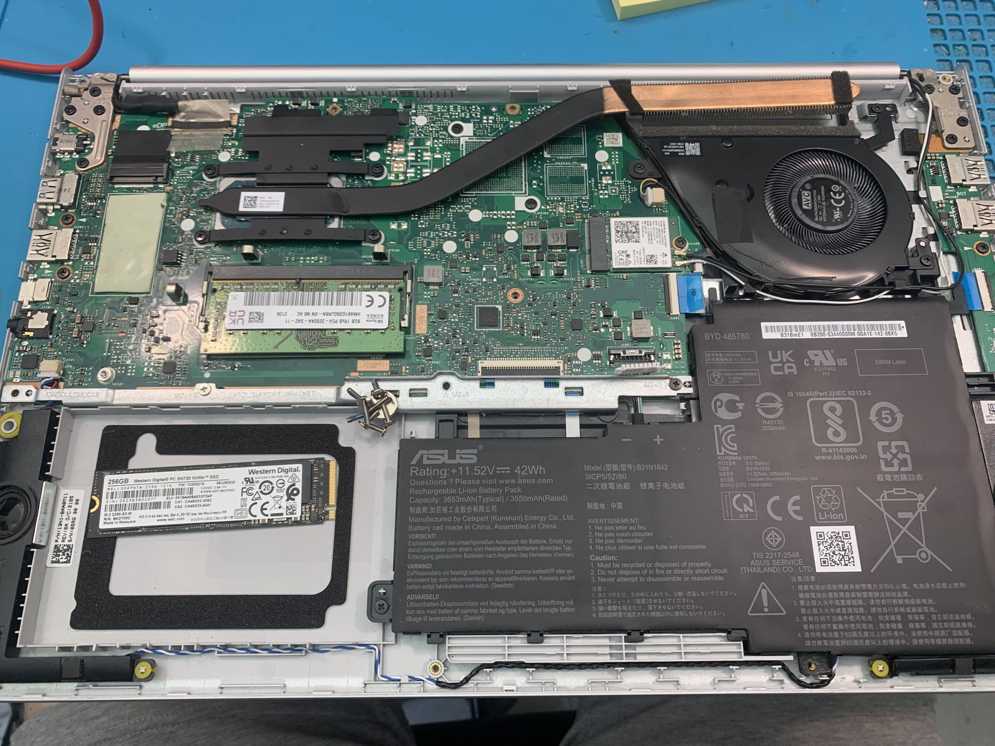

      Re: Asus K513E no image, bios dump attached
      I hope this helps!

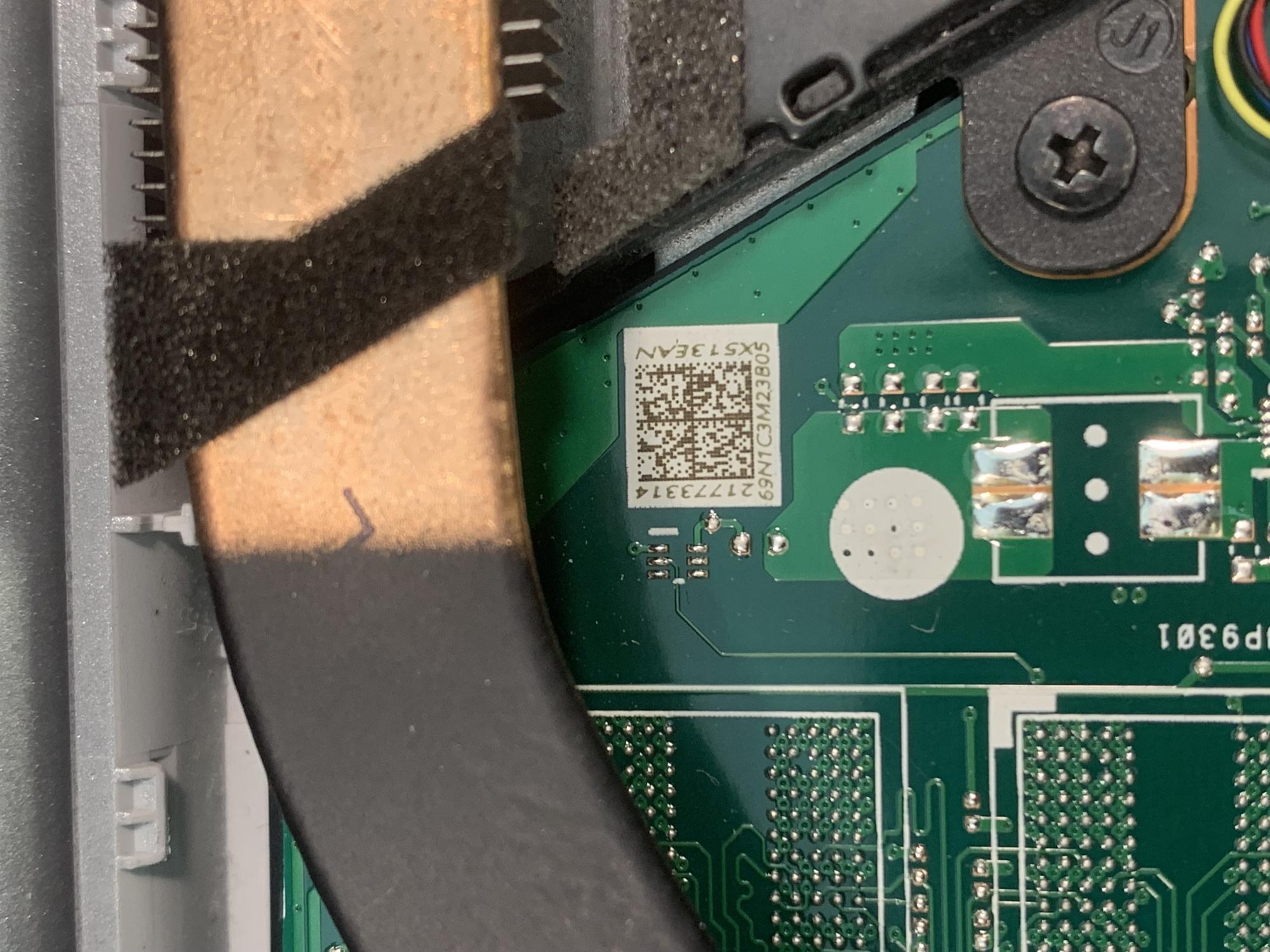

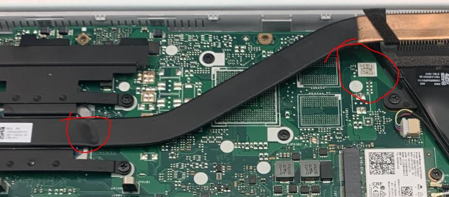

        There`s a QR code just above the wifi card.Did you bend the heatsink up,it has a big dent in it .That could be the problem ? .
          I saw the damages HS it wasn't me (I think that is not the problem, hs still works to a degree).. I try to be very careful with anything I try to fix.

            Use engineering X513EANF1302 bios attached in this post:

                DMI is not a problem for the moment, the bios at the link should work as is, it's an engineering bios for your board, and if it's not booting with it, your problem is not bios related I'm afraid, if you're sure the chip is properly programmed and soldered to the board of course.

                    No. there's no point in trying to flash X513EAF1313 bios. You can see at image with the barcode - X513EAN
                    The F1 in the bios name stands for Asus engineering bios.

                        Yes, inspect the area surrounding the bios chip, and be sure you've programed the chip as it should, use verification. After programing the chip read the content and compare the files again.
                        BTW here's an older version of the bios for your board if you want to try one more file:

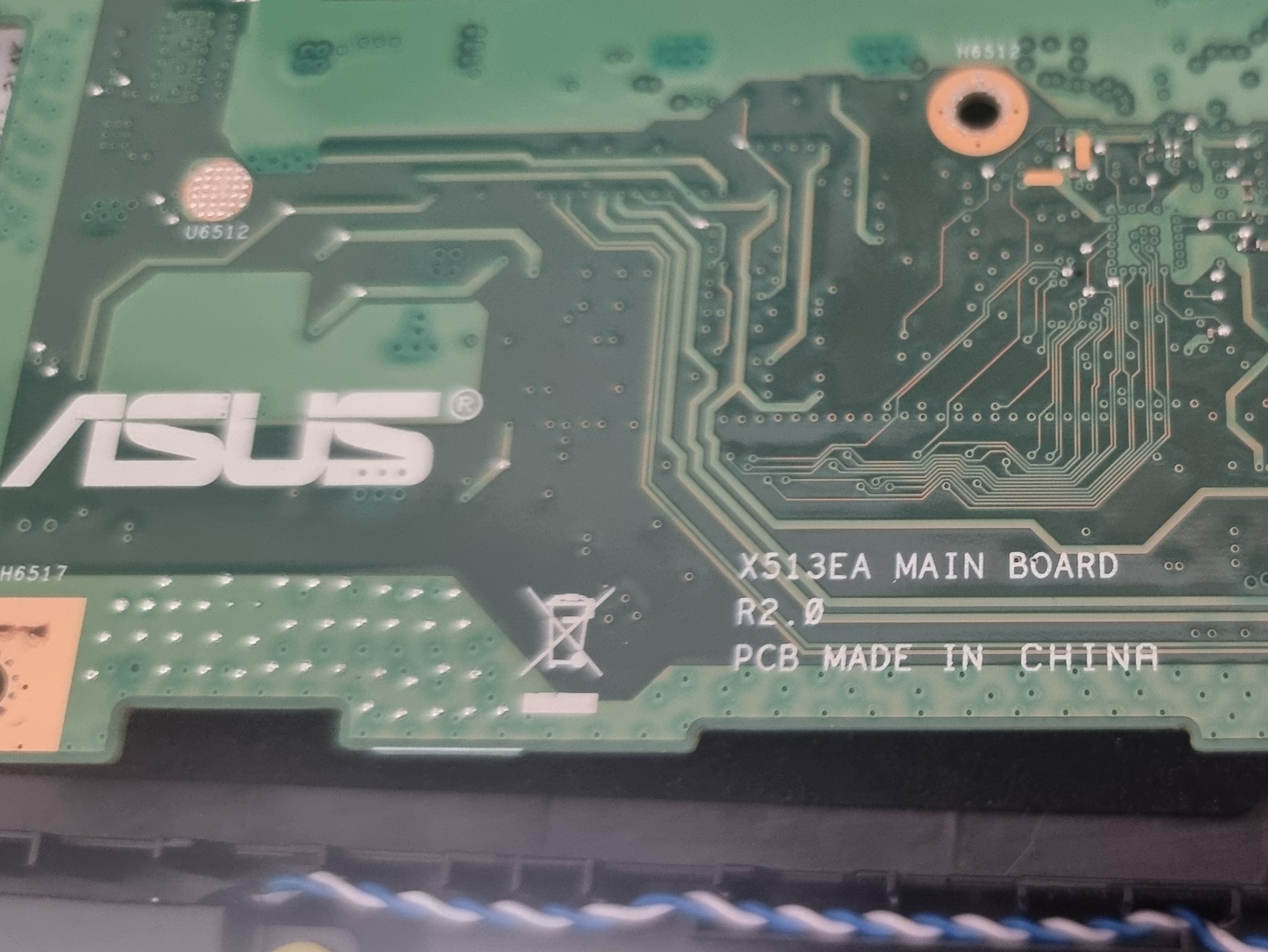

                                Hi
                                Asus K513EA Rev 2.0
                                Black Screen, 2x White Blinking Bios (Chip Gigadevice 25B127DS)
                                Do you have Bios, i'm tested differents Bios with CH341 ( setting with GD25Q128B) but nothing works Soft: NeoProgrammer
                                Thks for Help
                                Serial: 24M / M7N0CV22T82730D

                                  Hi
                                  Asus Vivobook K513E No GPU
                                  Problem Black Screen, 2x White Blinking Bios (Chip bios Gigadevice 25B127DS)
                                  Serial: 24M / M7N0CV22T82730D on Asus Website when i write this Serial i have :
                                  • Model: S533EA-BN1311T
                                  ​but i look chassis it's write K513E
                                  QR code Motherboard : X513EA
                                  do you have any idea? and the special Bios.bin?
                                  thks
