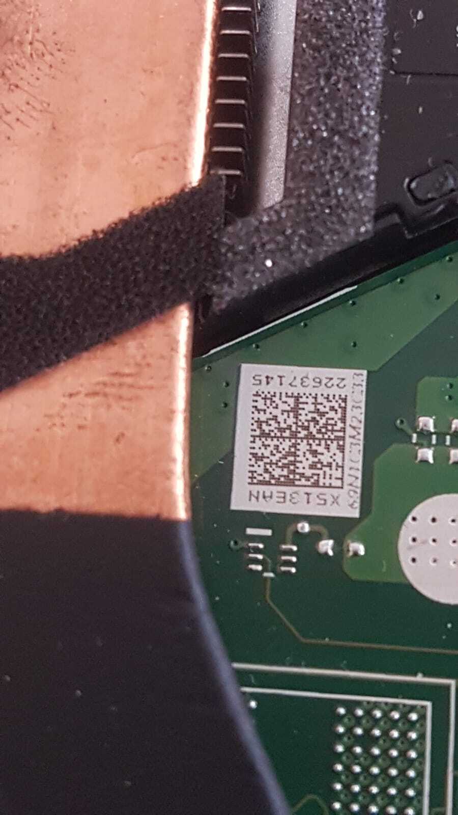

            Hi, I'm new here.
            I have black screen on my vivobook and I've try the bios in this thread but no luck.
            Model K513E
            SN 36M N8N0CV06222832F
            MFD: 2022-08
            • peste
              • Dec 2016
              • 13357
              • ROMANIA
              Originally posted by huracaniki
              Hi, I'm new here.
              Model K513E
              MFD: 2022-08
              post the contents of the bios chip even if it is corrupted..motherboard model,etc..

                I've opened the laptop and get this pics.
                thanks
                • hardware1
                  • Sep 2021
                  • 2946
                  • N/A
                  thanks
                  Where is your original backup? We need the file that was on the chip before you tried the other one from this thread.

                                  • peste
                                    peste commented
                                    Editing a comment
                                    post merged..next time look for a thread with the name and model, motherboard model of the laptop, and post there, if you can't find it, then make a new thread..

                                  #37
                                  Originally posted by terrapigui
                                  please i need bios of asus vivobook K513E
                                  serial N8N0CV062148329
                                  thanks for all
                                  motherboard model???
                                  post the picture here, with a white square (QR code), inscribed on the motherboard ...see post #28.

                                    • peste
                                      • Dec 2016
                                      • 13357
                                      • ROMANIA
                                      #39
                                      sorry
                                      thanks for all
                                      you have everything you need at post #22...X513EANF1302
