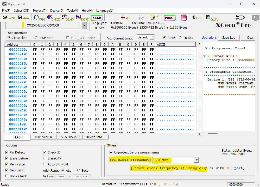

              • m1ch43lzm
                • Mar 2019
                • 787
                • Peru
                Originally posted by RCCBUBC
                Hi everyone,
                Need help with the bios file.
                Keyboard lights up but black screen.
                FA617NSR-AS71-CA
                Serial: S7NRKD008787286
                Try reading the BIOS chip again, if using a clip lower SPI clock frequency to 4-8MHz, cannot extract DMI data from your bad backup...
