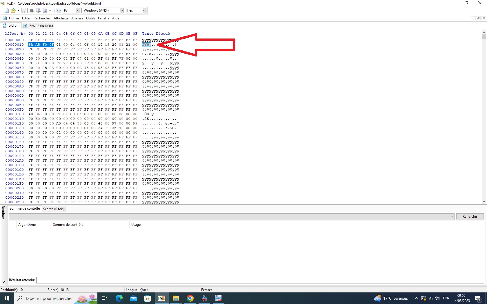

    zip file 9dcn34ww is orginal exe file i got from lenovo with sn of laptop and file ZIWB2304 is 9m rom that i extract from orginal bios exe file...i cant edit this file to 8m rom....

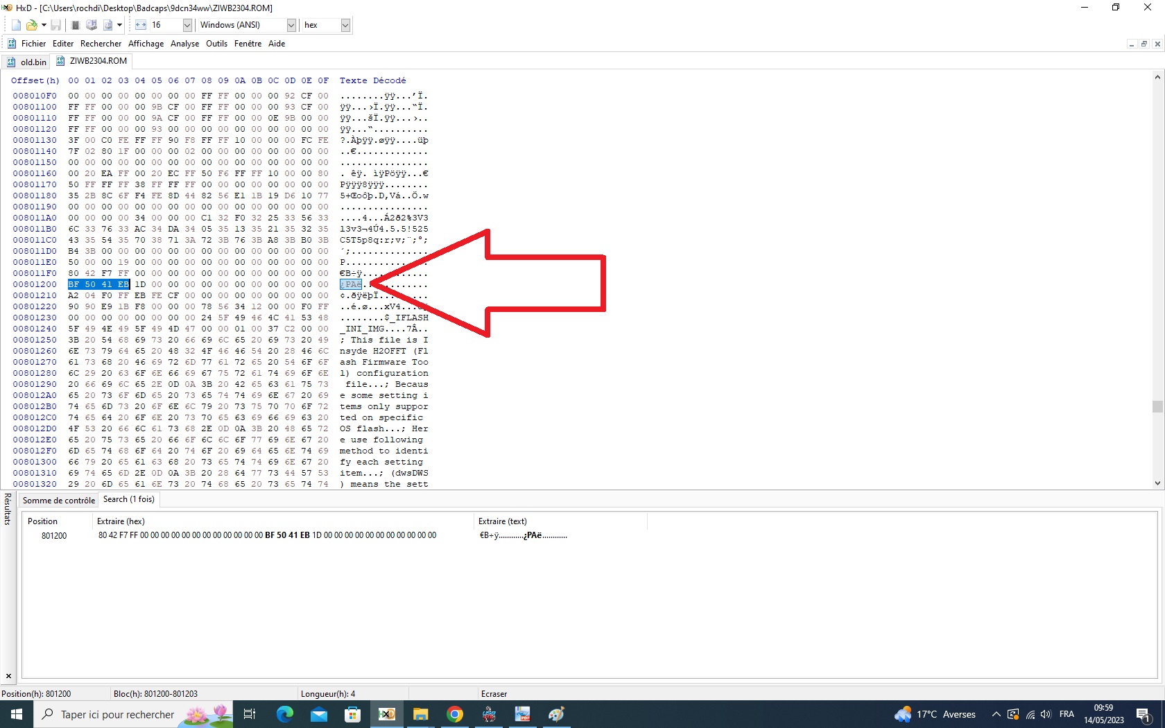

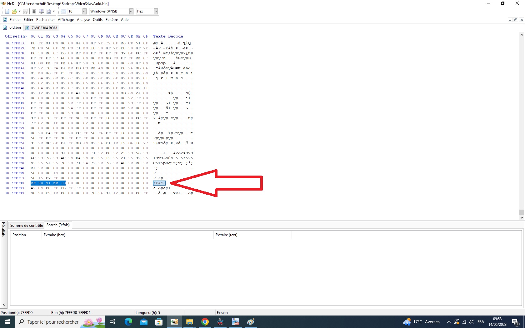

      Easy steps
      Open the main bios and 9m extracted from 9dcn34ww.
      From main select at second line = 5A A5 F0 0F ( Z¥ð) ans search for it at the 9m file...you find it than delete all the lines before to be match the begining of your main....that's your header
      Same thing with footer , select BF 50 41 EB 1D ( ¿PAë) and search for it at 9m ,...you find it than delete all after.

        thank you so much for your time and guiding....i will try it....many thx again.
