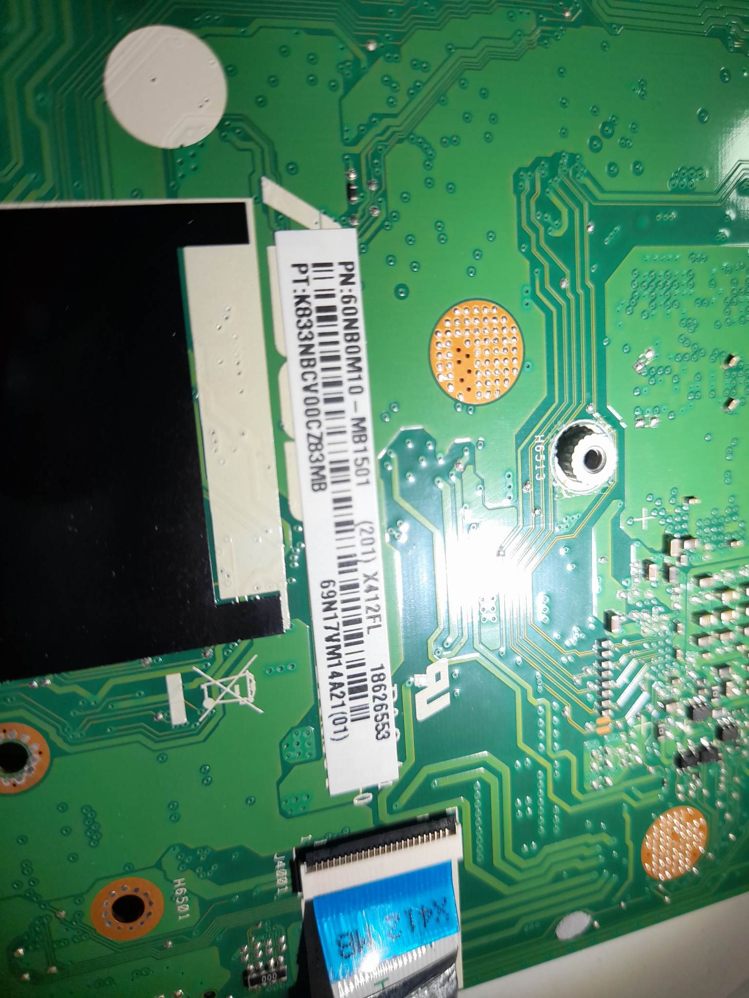

          Re: Asus x412fl rev 2.0
          and here is the white barcode
            • 22279
            This thread shows how to ID the correct bios version from the model on the barcode sticker -> https://www.badcaps.net/forum/showthread.php?t=96604 .The bios version you need is x412fl
              https://www.asus.com/ph/supportonly/...helpdesk_bios/ does this one?can you please extract ec also
                • 22279
                Yes thats the right bios update.It needs extracting from the zip first, then use UEFITool to extract the body, then open the update with a hex editor,it is only a 7MB update so it needs editing to the right size. Then make a copy of your backup and open the copy and the 7MB update with your hex editor, merge/copy the 7MB over the last 7MB of your backup copy, then copy the DMI from your backup to the backup copy.Finally you clean the ME firmware then its ready to flash. The EC region is at the start of the 7MB update, if the EC file size is 128KB select 0-1FFFF as the off-set ,copy and paste into a new file,then save it.
