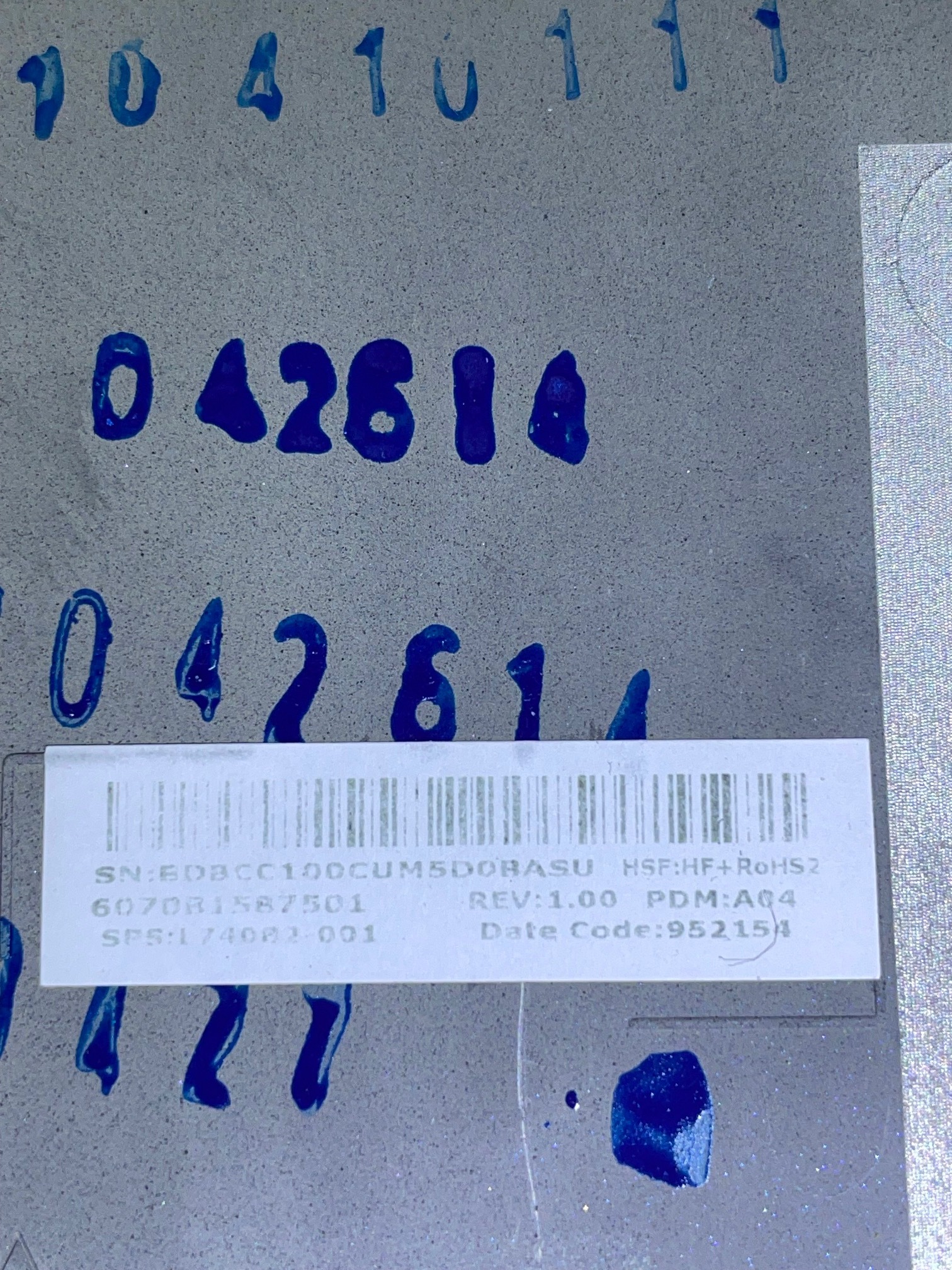

          hey guys need your help. i have the same modell with a startup password. Already read U366 and ran it through RCUnlock but its still there. What can i do to get rid of it?
          SN:EDACC100CUM5D0BASU

            The serial number is wrong, Check again and post the correct one!

            Sorry but the sticker is hard to read. Here is a picture for proof. I hope that´s fine?
            EDIT: Sorry but there is nothing on the outside or anywhere with the serial number
            EDIT2: Got it 5CG0248HCN
            • Vesko356
              Vesko356 commented
              Editing a comment
              This is not the laptop serial number. It's printed on the outside of the bottom cover!

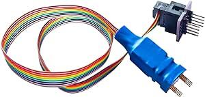

              I did verify that i read it properly 3 times. Chip looks like someone was there already. Should i just use a Clean BIOS then?
              • Vesko356
                Vesko356 commented
                Editing a comment
                Of course not. Once the laptop is on and running, obviously the bios is fine (even with a password), you just need to read the chip properly, besides if you can't read it correctly, you won't be able to program it either.
            • highping0r
              • Nov 2019
              • 15
              Ok, first time using one of those clips. i put it on and read the chips 3 times and always same result. I guess i have to desolder like i was doing before and post the dump again.
              • Vesko356
                Vesko356 commented
                Editing a comment
                That would be the best approach. Using such gadgets almost always means a bad result.
                Also, it is necessary and very important to have a good and verified bios backup before doing any other experiments.
                You should read the chip at least twice (even better three times) and compare the contents between the dumps.
