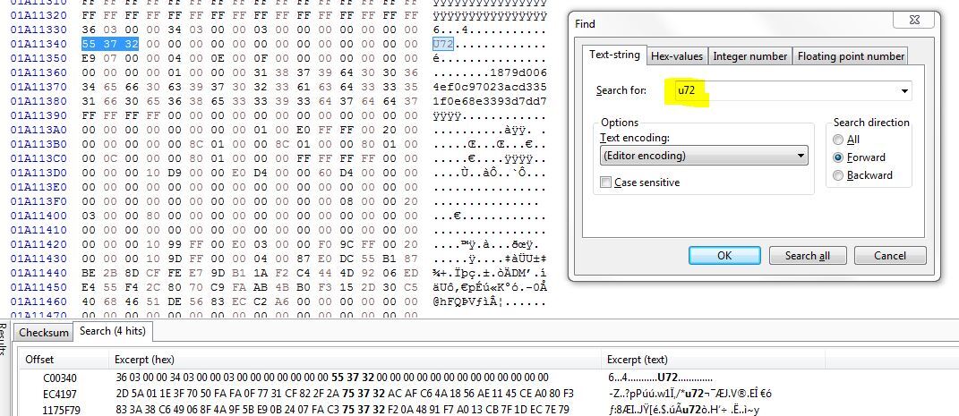

              I noticed there's a lot of unlock request for this model HP ProBook 440/450 15.6/14 inch G9
              The patch won't work if the bios version is latest. use this bin flash both it won't work if you only flash the main you should Flash Both!
              first boot press f10 apply factory defaults and restart, 2nd boot reset security settings to defaults and exit.
              use BCU and put your original DMI
              This bios is extracted from hp website so its fast boot this would work in 2 models 14 and 15.6 inch they have the same bios.
              To determine your BID use any hex editor and search for the BID. Ex: U72

                #109
                thank you but
                I can't tell if it's U72 or U85
                  • 22206
                  #110
                  Originally posted by lenain31
                  thank you but
                  HxD hex editor - https://mh-nexus.de/en/hxd/

                    #111
                    thank you very mutch
