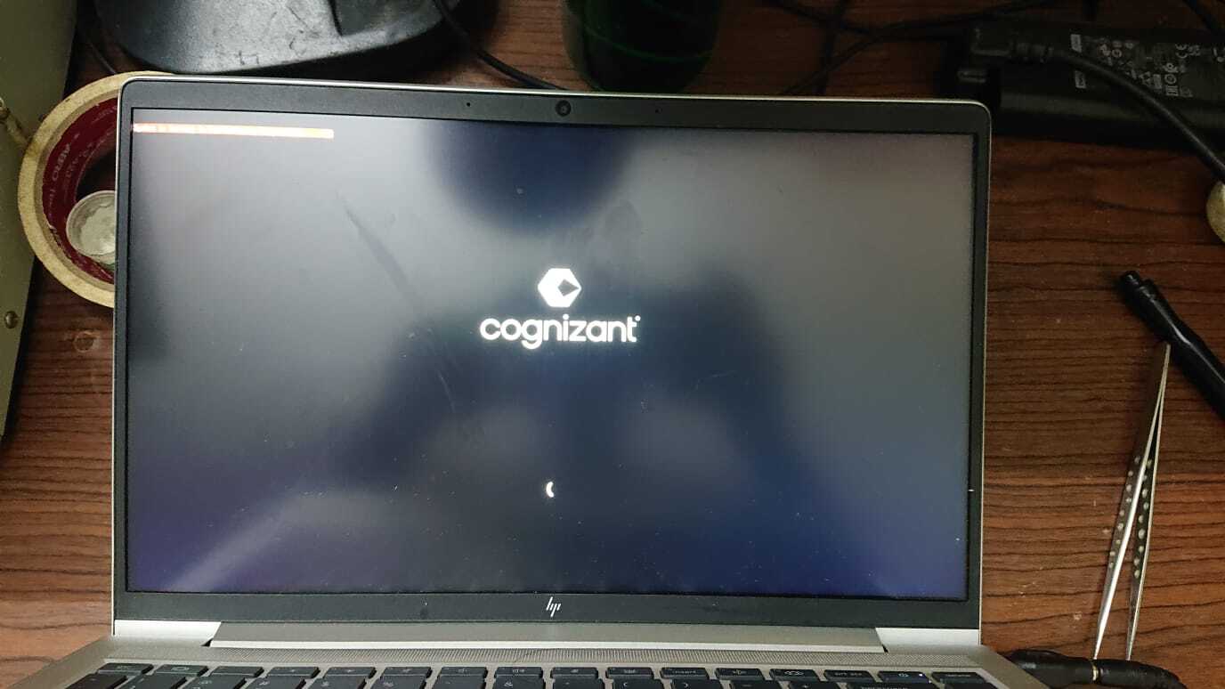

      MODEL : HP 640-G9
      Part no : DAX8SFMB8B2 REV B
      SN: 5CD32081Q8
      problem: this laptop working fine but ( HP LOGO ) NOT present ill attached the image and bios file spi
      please anyone remove this logo please
