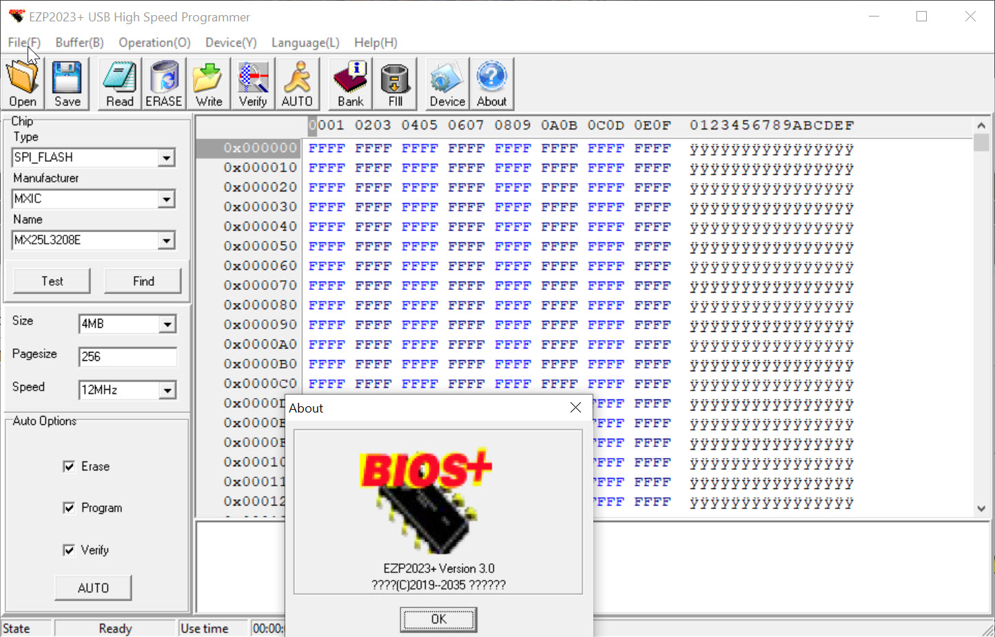

    Hey, I'm trying to remove the password on my HP Elitebook 845 G7, so I have the two chips
    bios: MX25L25673G
    EC: 25Q256JVEN
    With EC I programmed the new edit bin file with ezp2023, everything worked, but when I erase MX25L25673G, the data is not completely erased. I'm going crazy, what should I do? Thank you

        Just downloaded the software but unable to find this chip in their database.
        Which version is your software?
        See a speed setting. Configure to use the slowest setting and try to erase it again.

          i use the equivalent "MX25L25635E" (everyone uses this with this chip). I already tried erasing at low speed, but it didn't help. Software version 3.0

            Erase the full chip. Then read it back and post the memory dump here.
