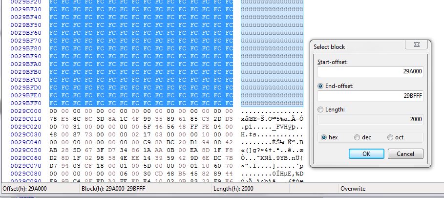

                          DMI offsets 29A000 - 29BFFF
                          You can use the bios in post #2 replacing the DMI from your backup.

                            Yes I saw those offsets but my problem is when I look at the bios in a hex editor I cannot find the 29BFFFh offset. Only the start one. So not sure why this bios is diffrent. The last 29B entry in the original bios is 29BFF0.
                              • 22159
                              Re: Lenovo g50-80 80e5
                              Originally posted by ebyte64
                              Thank you.
                              Offsets in your original bios Put your cursor on the last FC it will be 29BFFF .The first FC on that last line is 29BFF0
                              • ebyte64
                                • Jun 2023
                                • 51
                                • South Africa
                                Ah! I see where I went wrong.
                                Thank you so much.
