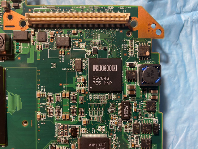

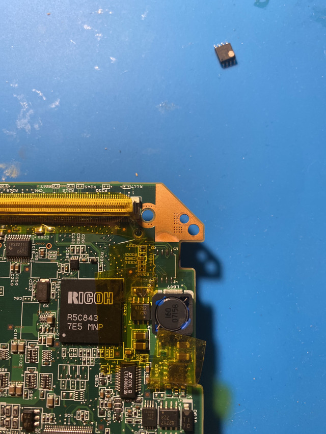

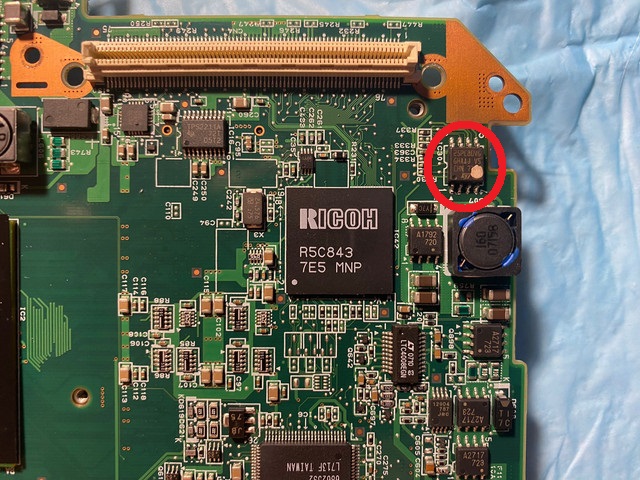

      I got huge problem because I didn't see any another chip thats looks like bios flash. I also didnt see on any site chip for this kind of motherboard ….if I will put here photos of my motherboard…
      here are some photos of motherboard I will make better when I will arrive to home

        Re: Panasonic CF-19 MK1 request unlock bios
        Look the attachment.
          I made dump exacly this chip if You look at this chip You can read that is 25PE80VG. I desoldered it and made dump on table. So if this is not correct chip so please help me find corect one…

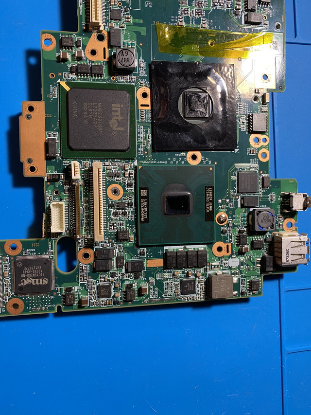

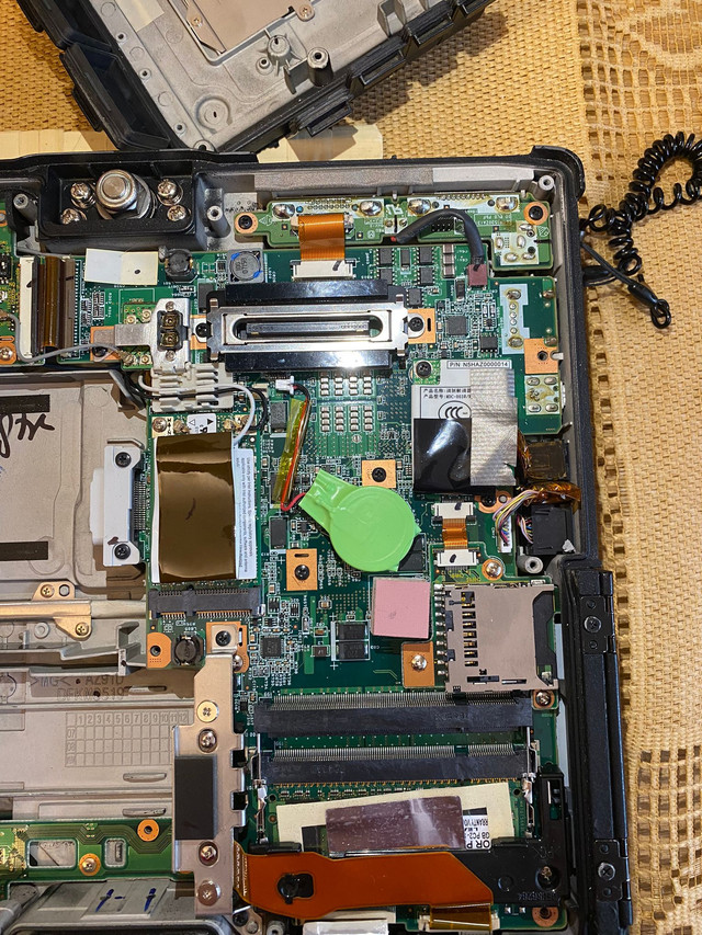

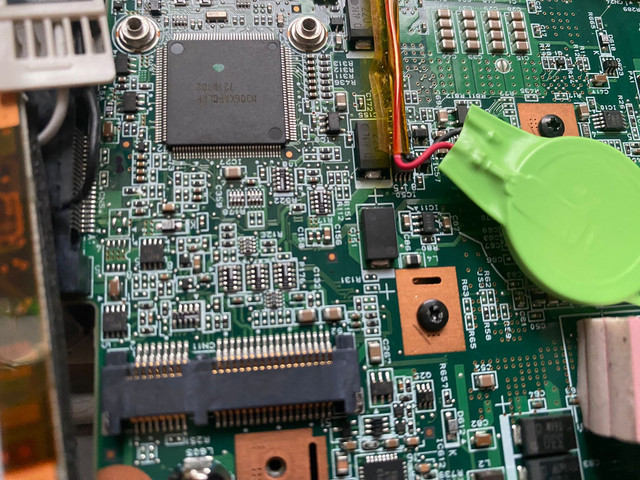

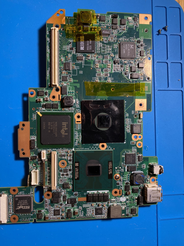

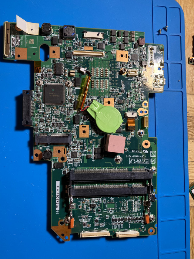

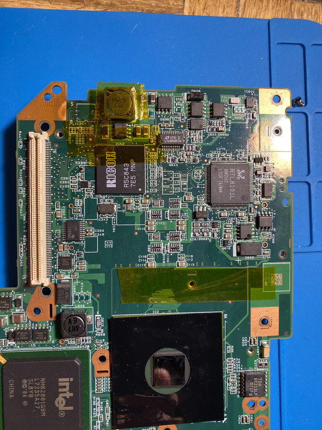

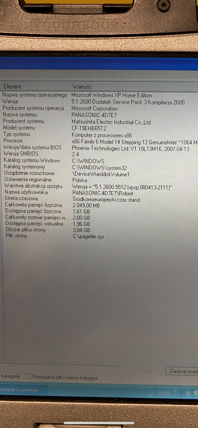

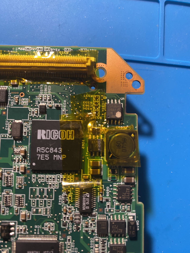

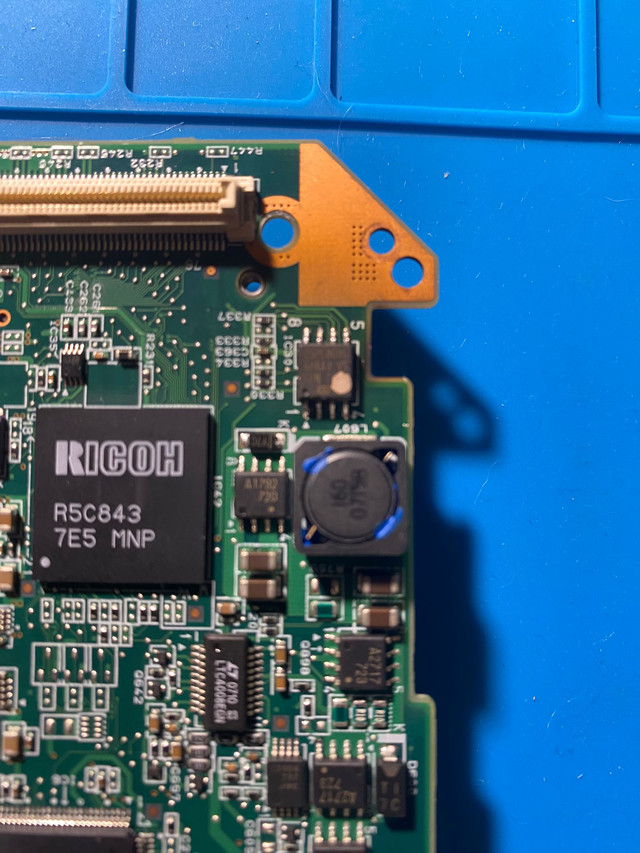

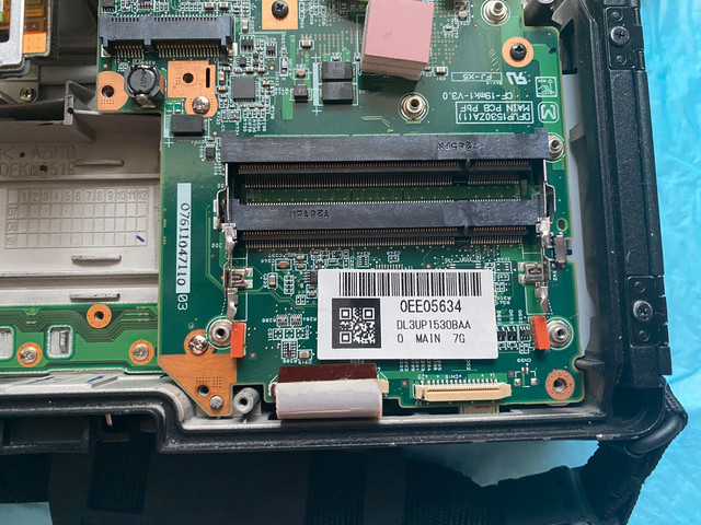

            Here is my motherboard. I dont see any another bios chip
            Link for better quality files:
            https://ibb.co/6DLsPY2
            https://ibb.co/8MRgY27
            https://ibb.co/fYvJ4JX
            https://ibb.co/Yym00N7
            I think that is a good bios chip . I found on site a bios-download „product/panasonic-cf-19-mk2-bios” where dump has 1 mb size. So early version CF-19 like MK1, MK2 had small size of bios chip. Version MK3 had 4mb dump size….
                Originally posted by kasper1910
                Anybody have a solution. Please help Community???
                that is bios chipset, mk1 and mk2 have 1Mb bios chipset.Anyway, your bios is edited, no serial, no product name, no chassis serial, etc.
