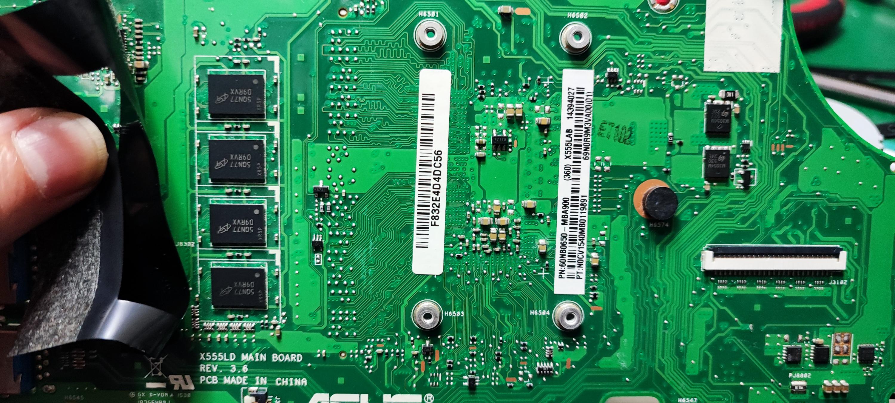

          Does it have X555LA printed on the barcode sticker or another model number
          • darckreign1984
            • 260
            • Romania
            Re: asus x555l bios please
            x555ld main board
            rev 3.6
            pn: 60nb0650-mba900 (360) x555lab 14394027
            pt: n0cv1540mb0119891 69nor9m3va00(1)
            It's x555LD rev 3.6. NOT x555LA
            All this data it's printed on motherboard.

              You have x555lab on the barcode sticker ?
              Asus service F1 bios https://www.badcaps.net/forum/showpo...9&postcount=14
                      Picture update
                      • darckreign1984
                        • 260
                        • Romania
                        i flashed this bios, same results.
                        when i conect power led 1 and 4 light up. fan dont start.
                          • 20914
                          You have a hardware problem.
