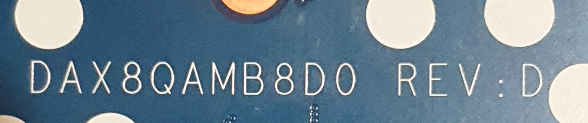

    Hi
    Bios and ec for HP probook 440 G8
    DAX8QAMB8D0 REV: D
    I don't know why but from internet searches,
    with this number of motherboards it is probook 450

          Hp 440 g8
          HP 440 G8 B.I DAX8QAMB8D0 REV D SN;5CD122BC01
          Somebody help me solve the HP EndPoint Controller Problem, on startup
          Both backups attached

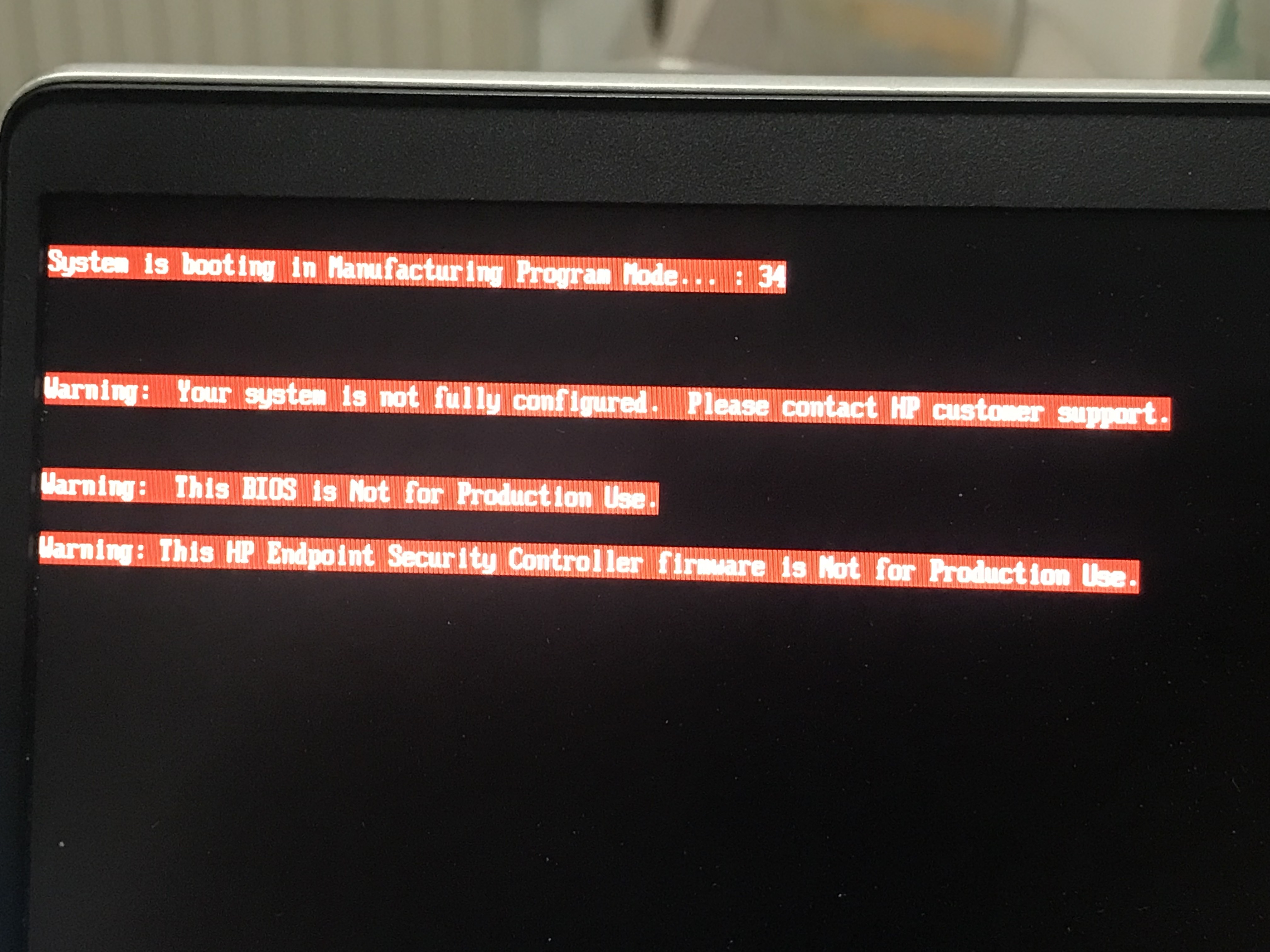

                          Hi all, I need help with bios for HP Probook 440 G8. Laptop is a test/evaluation machine, so serial will not be found in HP site or partsurfer. Problem with it: at start it has warnings about bios and endpoint controller not being for production use, and is not fully configured (is in MPM mode and missing DMI). I did try to rebuild it but no luck, FIT 15.0 gives me errors like "fail to validate key manifest" failed to build. Any help will be much appreciated, thank you. it has discrete graphics GPU.
                          SN: 5CD0284LWQ (there is a sticker where serial is A5CD0284LWQ)
                          Motherboard: DAX8QAMB8C0 Rev:C
                          Model P/N: X80QA C2-4 Roban PV
                          P/N: 1X8QU9U0TPE
                          Bios is T70 ver.80.35.00.
                          Attached is Main and EC dumps.

                                hoaca388, rex98 - I don't need to recover DMI, I need a working bios and EC for this motherboard without displaying warnings that are not for production use.
                                • hoaca388
                                  Badcaps
                                  • Jan 2022
                                  • 12421
                                  You can take EC at #8 .
                                    • 22146
                                    "fail to validate key manifest" . It uses a different key to sign the firmware for Pre-production machines. Cleaning the ME firmware with production firmware won`t work.You would have to replace the PCH from a donor board.

                                      try these all. it has EC pair. just clearme before flashing.
                                      these some files come from paid site. and some are from my friends.

                                        thanks a lot but my motherboard is DAX8QAMB8C0 Rev:C​. i did try some of T70 bioses from here but no joy, power led and capslock blink 8 or 9 times and that's all.
