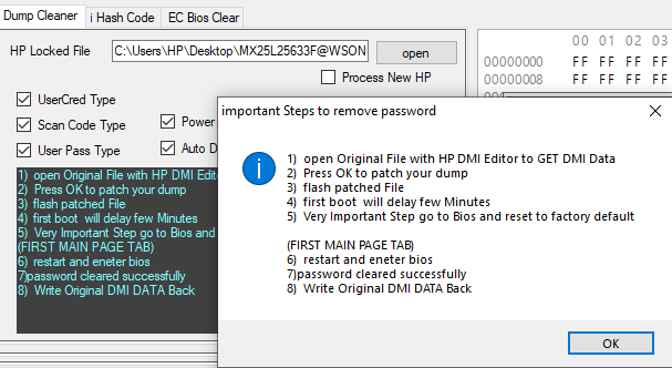

    hey i have a problem i wanted to remove a bios password on a 850 G8 now the laptop won't turn on.
    the laptop was still working when i loaded the patch file from *******
    After that I reset the bios setting to factory settings and since I loaded the original dmi data the laptop no longer starts

    If you want support for that paid software go to their website and ask why it isn`t working,this isn`t their support forum.If you want the members here to help you, for free ,post your original backup and someone might be able to help.

      I published the original backup

        u should use hp super editor not that one

          When the AC adapter is connected, the CapsLock LED will flash once, then turn off. The display stays black and the fans don't spin at all.

                                      now the CapsLock LED and the num lock LED blink about seven times then turn off. The screen is black and the fans do not spin.
                                      it didn't work, I resoldered u367 with the original file. I saved the file you sent me on U366 and recorded it. if you have any solution please let me know, it will be of great help, here are the original backup files again thanks!
