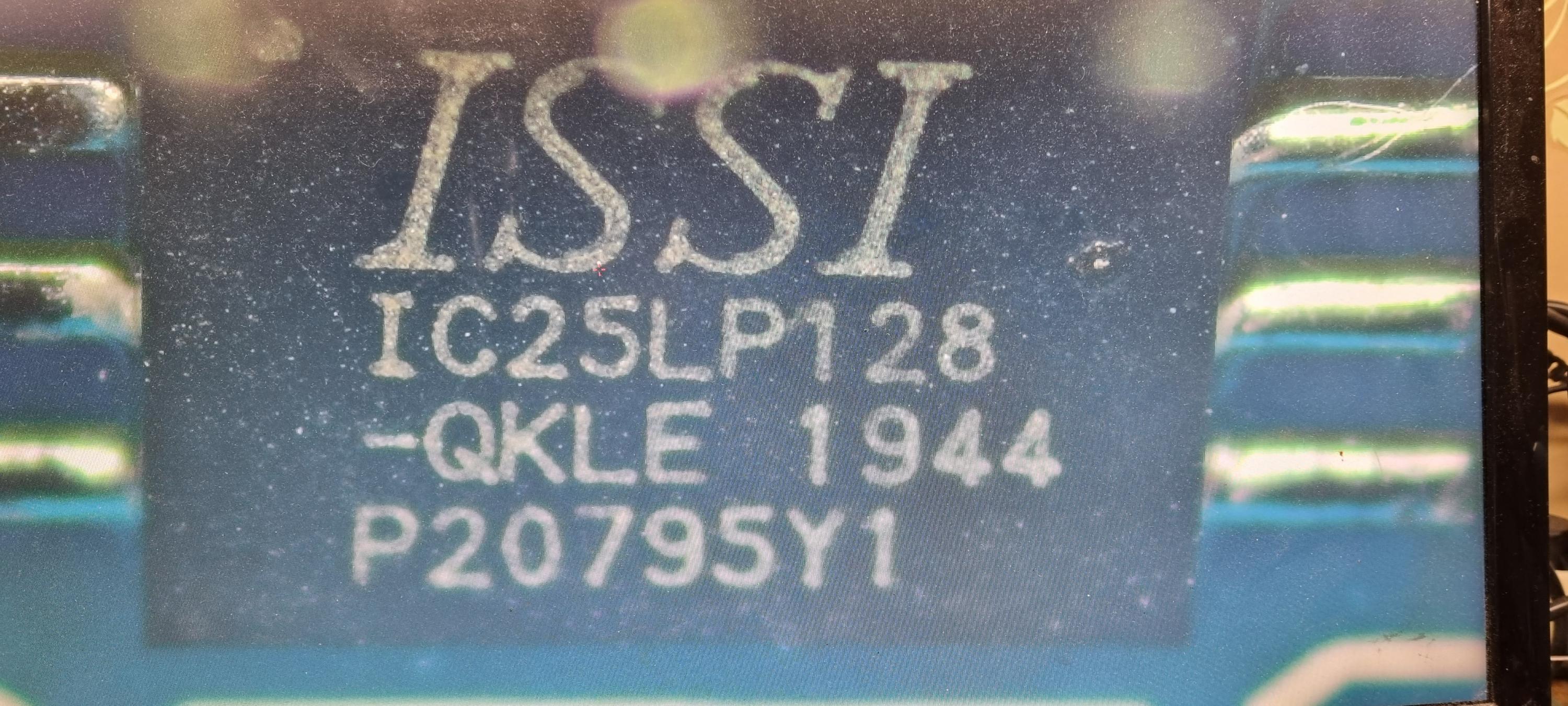

ch341a and Ezp2023+ cannot read ISSI IC25LP128
  • caprigtx
    • Mar 2022
    • 65
    • Netherlands
    I use AsProgrammer ,and NeoProgrammer , and CH341Programmer software.
    None off them cant read the chip.
  • caprigtx
    • Mar 2022
    • 65
    • Netherlands
    Re: ch341a and Ezp2023+ cannot read ISSI IC25LP128
    This is the chip.
