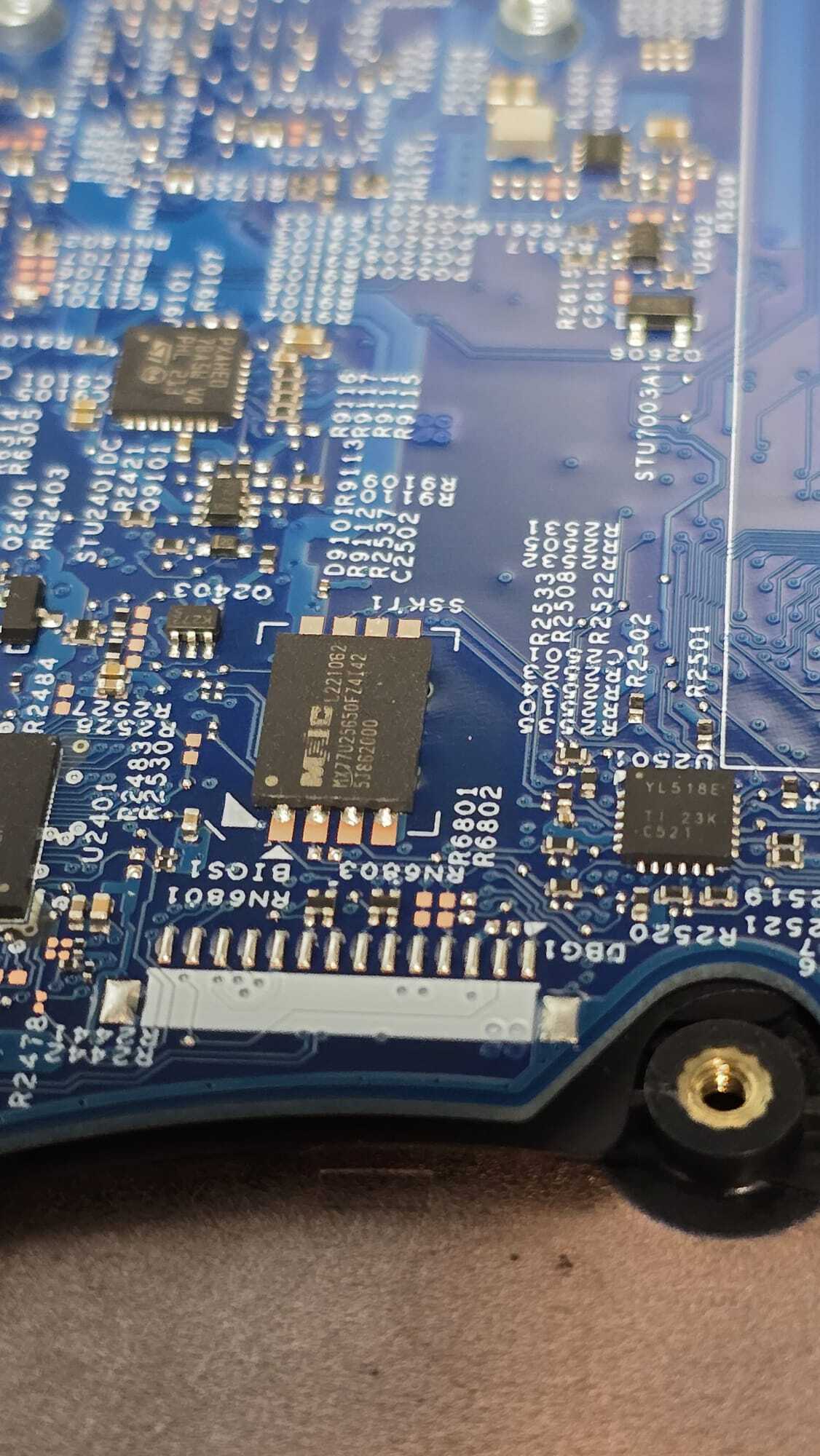

                        Hi to all!
                        I have a Lenovo ThinkPad L15 and i need a BIOS .bin file
                        Model: ThinkPad L15 Gen 3
                        Type: 21C7-003NRT
                        Serial: PW-0487KX
                        Bios brocked during flashing.

                          Post your bios backup and someone will help.

                              Found Windbond 25Q128JW60, named BIOS2.
                              Here the damp.
                              Another one Macronix MX77U25650FZ4I42, named BIOS1, not damped, i dont know which software to use.
                              • gonz1k
                                • Jul 2023
                                • 5
                                • Kazakhstan
                                Re: Lenovo ThinkPad L15 BIOS Request
                                Another one Macronix MX77U25650FZ4I42, read like MX25U25635F, with CH341A Programmer.
                                Here the dump.

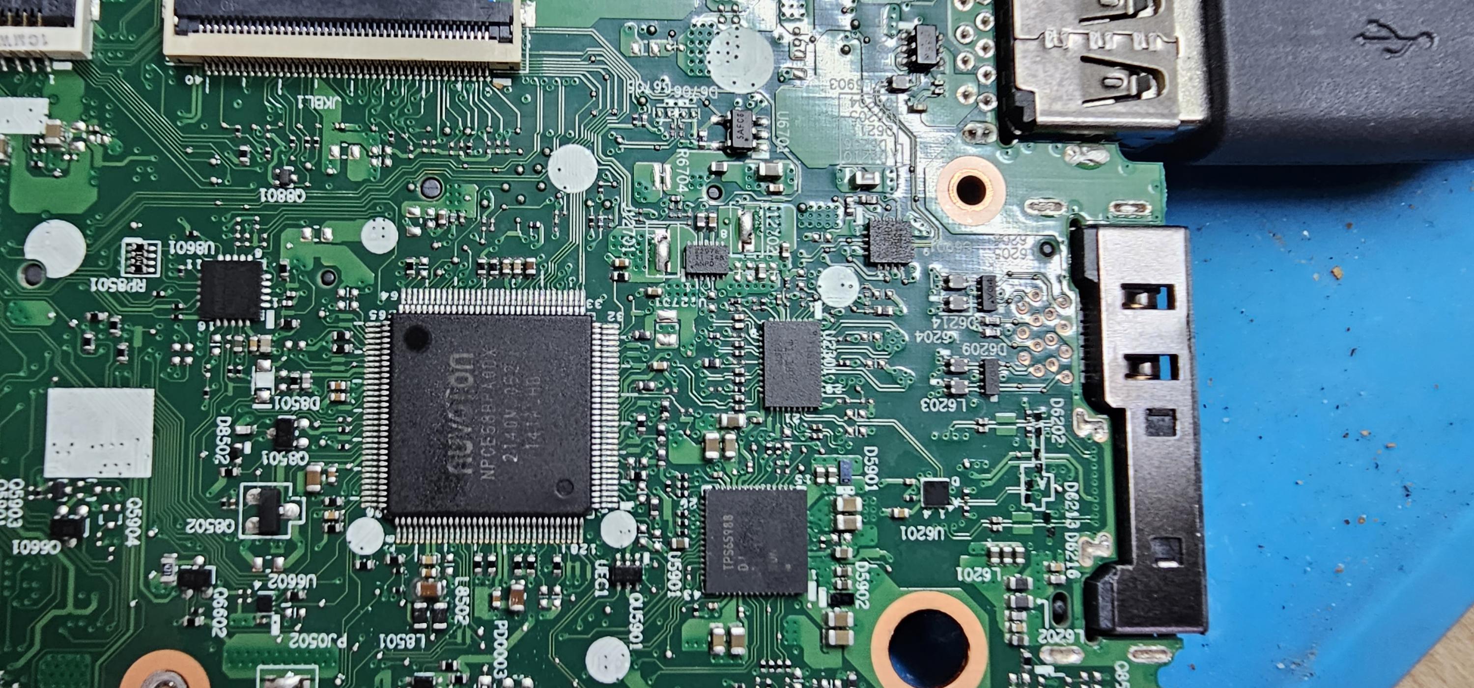

                                  • waleedoo
                                    • Nov 2016
                                    • 71
                                    ThinkPad L15 gen2
                                    Hello
                                    do you have an explanation
                                    on how to program this
                                    Nuvoton NPCE68BPA0DX
                                    Motherboard number
                                    NM D391 REV 1.0
