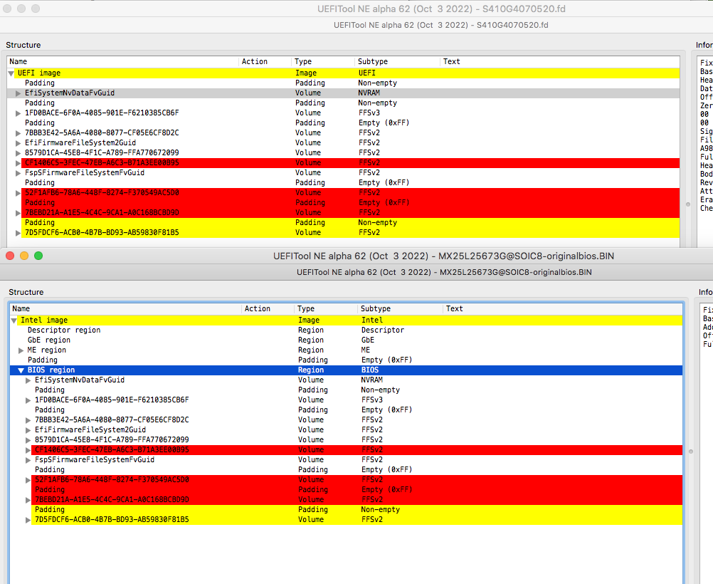

      try this one. I replaced entire Bios region with one extracted from bios update.

        Re: GETAC S410 G4 Bios password
        Now it works. Much thank......
          Can you share with me how you do it?
            I downloaded bios from getac site, opened bios file (it has .fd extention but no sweat) with UEFITool, opened your bios file in another window and replaced modules one by one.
