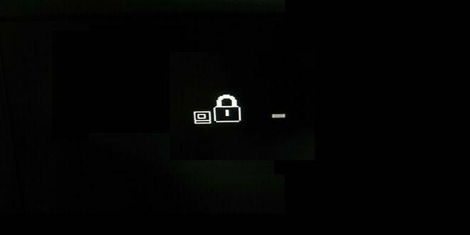

    How do I find serial number from bios lenovo Thinkpad L14
    Hello friends, can someone tell me what the serial number is stored in this bios? I don't know how to find it or can someone give me some indication of how to find it in hxd?

          Could someone help? i can't run by usb software the bios is locked and i can't boot, i need to get the s/n of this bin.

                Re: How do I find serial number from bios lenovo Thinkpad L14
                remove ssd , it seems you have a storage password. Usually, when you have a SVP password you can enter in bios to see settings but you can't modify them.
                  If you're right friend... I removed the ssd and was able to access it... also I just discovered that the serial number comes on a sticker on all lenovos...
