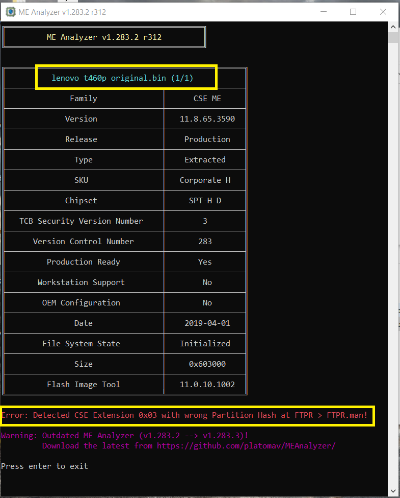

    Hello, good, I need someone to unlock this bios for me, I have tried the AUTOPATCHER that is published in the forum and no luck now I have a problem
    and it is that when I go back to program the chip the original bios I get 5 short beeps and that sequence of sounds is repeated again.
    I leave you the original bios and see if someone can help me.

    Check it by ME-Analyzer , clear ME that file and then run Autopath.

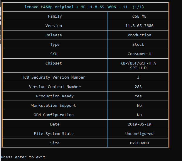

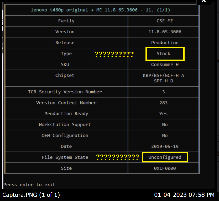

        I cleared the ME from the bios but when i drag the new BIOS with the new ME on it, the Autopatcher close the window without generating the Patched file.

          Re: Lenovo t460p bios password unlock
          The operation of clearing your ME region is wrong.

            i see, the SKU is wrong, i needed to find a INTEL ME with Corporate SKU

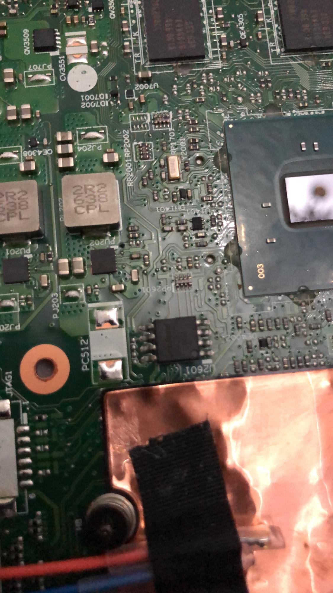

                        I have tried again and nothing, and the chip is fine since I have unsoldered it and it reads the data correctly and writes it well, the only bios that at least reacts is the original one and it gives me 5 beeps as if the motherboard were dead but Actually, the video worked perfectly and it started with the locked bios, but now that I have tried to go back to the locked bios, when i turn it on it only gives me 5 beeps.

                          Are there any components around the bios chip that are lost or displaced when removing the chip?

                            No, all the components are in their place, always when desoldering a component such as a chip, I protect the area where I am going to solder with electrical tape. i have photos of the chip
                            update: old bios when i put on the motherboard It sounded an error message of 5 beeps, pause, 5 beeps

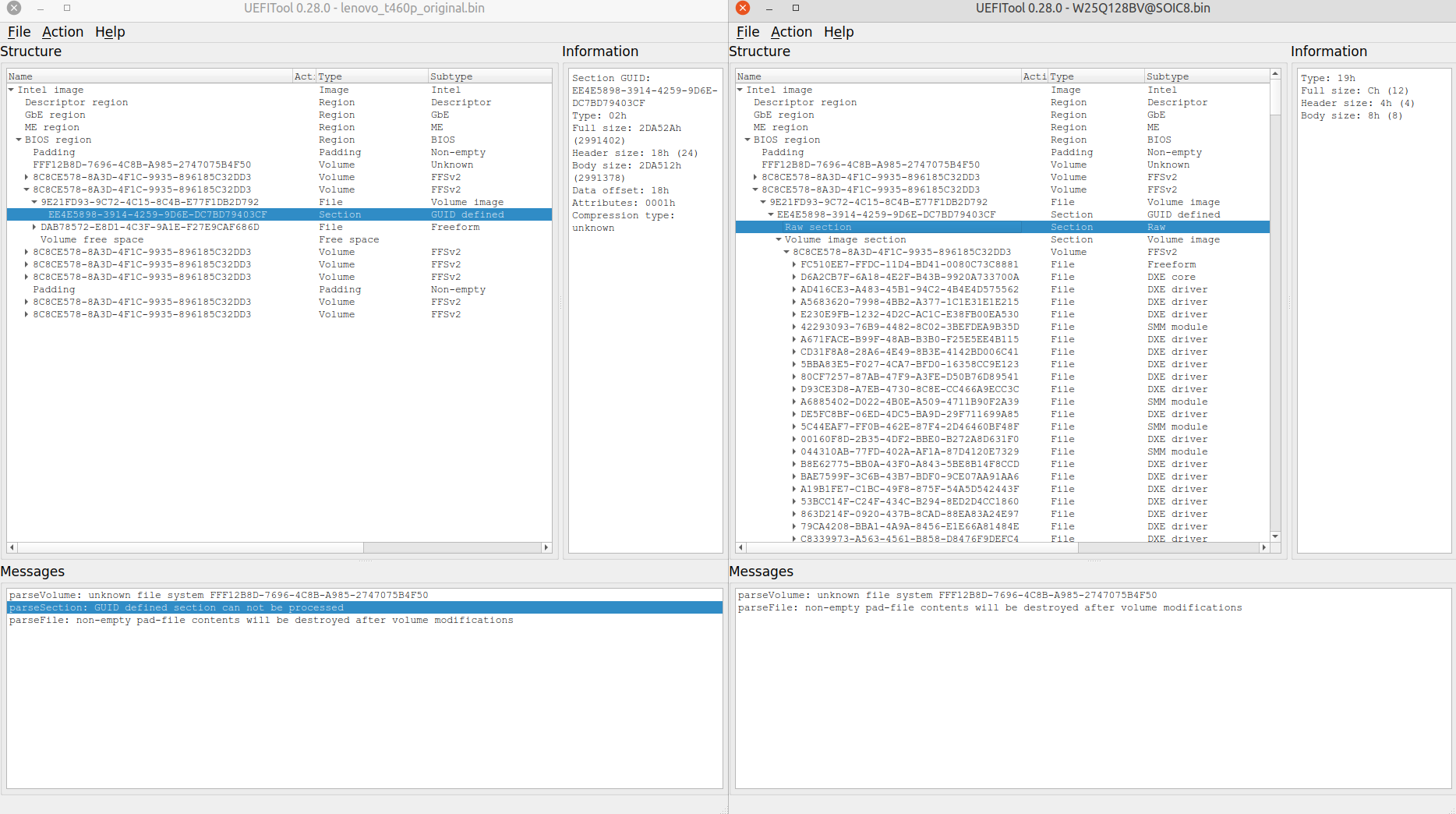

                              Hello but you already know that your original BIOS that you provide in #1 is corrupted?

                                Seriously? I didn't know, it may be that when reading with the programmer something happened since I did it with the soic clip.
                                What can I do now since I don't have any copy of that bios.
                                because I downloaded the uefitool and i checked all copies i did before the write and all the copies I made are just as corrupt

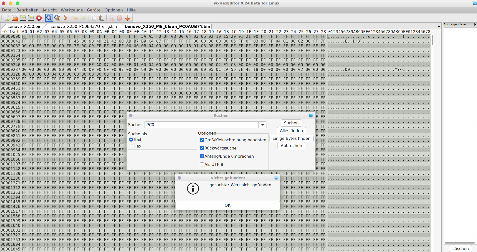

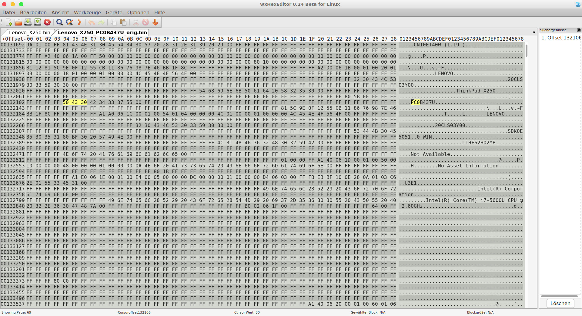

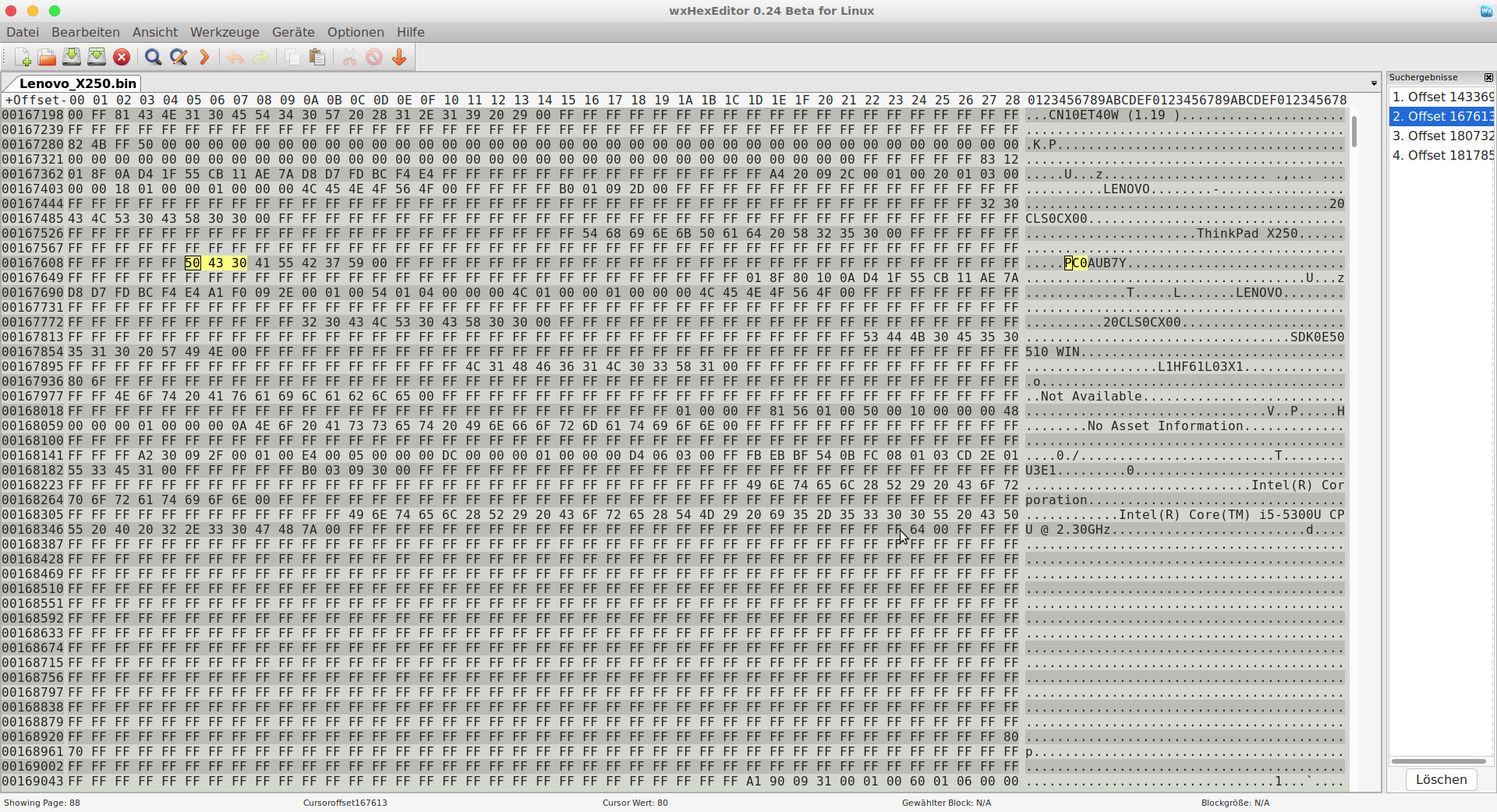

                                  You can try it happened to me with a Lenovo X250, I didn't have the original BIOS anymore, I did it with someone else.
                                  It is important that the ME region is cleaned worked for me.
                                  https://www.badcaps.net/forum/showpo...postcount=2073

                                    • Markus1741
                                      • Sep 2020
                                      • 842
                                      • N/A
                                      What did you do to recover it, did you look for someone who had the same bios without a password but with a clean ME?
                                      To dispel a myth, the password for the LENOVO BIOS is not stored in the BIOS
                                      CHIP, anyone who makes a request here and uploads a LENOVO BIOS with a
                                      password - all these BIOS CHIPs do not contain any password.
                                      Not so with HP or Dell.
                                      You won't have many other options either if you don't have a working original
                                      BIOS, try something else.
                                      Try installing the ME Clean File first and see if it works, then apply the patch.

                                        Okey do you have the same image for W25Q128FV or is safe using that image you shared with that chip?
                                        update: when i put the clean ME image in the chip that you shared, the laptop turn on the led of the keyboard and the power led and shutdown and then turn on again but with out video like a loop boot
