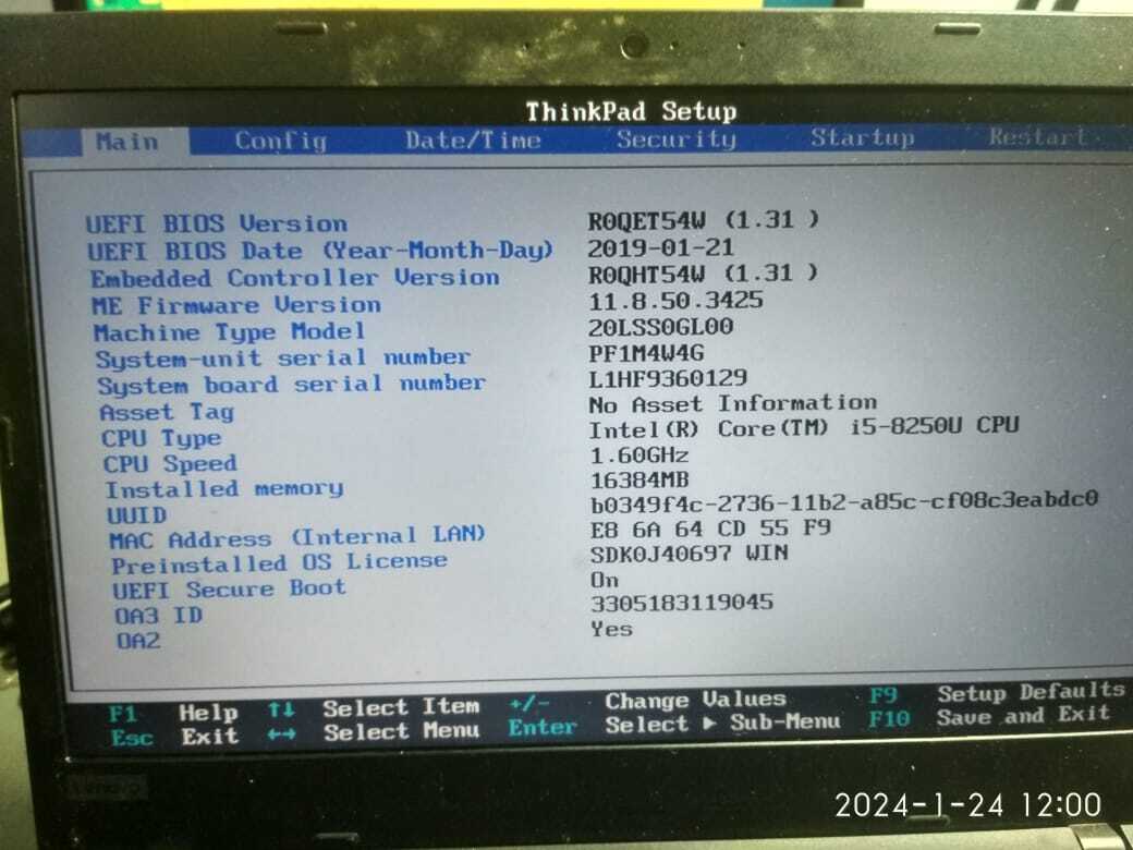

            Thinkpad L480 Bios repair
            system-serial No.PF1M4W4G
            TYPE: 20LSS0GL00​
            Hi All , I have Lenovo thinkpad L480 CMOS PASSWORD protected. can someone help me remove the bios password .i attached the BIOS file and SERIAL No.Thanks in Advance.
            Hi friends ,
            i tried auto patcher but no display.
            again i put
            the old it works display comes..
            my laptop model is
            TYPE: 20LSS0GL00
            i am seeking help please.

              • gts
                • Oct 2014
                • 7
                • india
                Originally posted by hoaca388
                CCC
                Thanks for your response .
                it is no power with your files.
