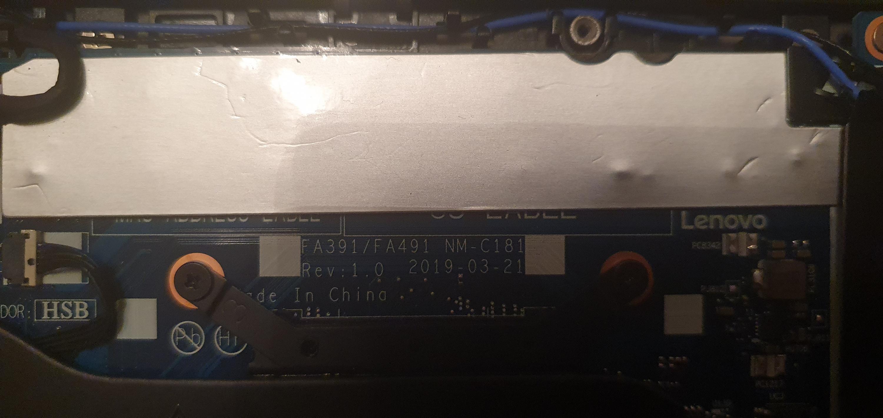

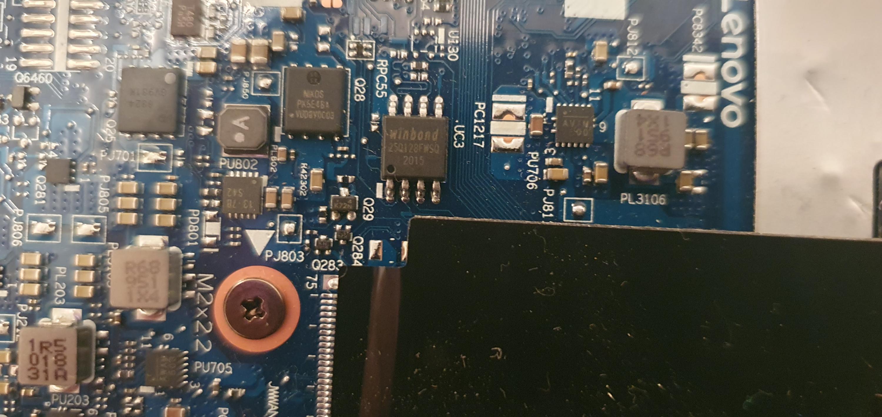

    Hello Everyone,
    i have an Lenovo Thinkpad T495s Type 20QK with a
    Board FA391/FA491 NM-C181 Rev. 1.0 2019-03-21
    and a Bios Chip from Winbond W25Q128FV 1.8v
    Before my programmer came i tried to short the BIOS CHIP to overcome the Bios Password which resulted in a failure my Laptop has now a blackscreen and a musical tone.
    Now i got a CH 341a mini Programmer with 1.8v Adapter i dumped the CHIP with AsProgrammer and NeoProgrammer than i tried to take a BIOS Update from the Website and Short it like in some Tutorials described to get it down to 16 MB but after Programming it to the Bios Chip now i have Only Blackscreen and the CPU gets HOT and the FAN only works for a sec on power on then turns off even after Programming the dumped Bins back.
    I hope someone can help me.
    Thanks in Advance

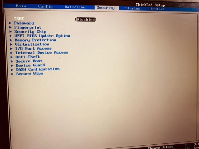

        Re: Thinkpad T495s Type 20QK Bios bin needed
        i got my error why my dumps where not working not enough power...
        here is now a working dump naturally bios locked if anyone can help me give me hints
        thanks in advance
        • hoaca388
          Badcaps
          • Jan 2022
          • 12394
          thanks in advance
          I hope this tool can unlock your bios .
          https://www.badcaps.net/forum/showthread.php?t=87588
          • Elvirus
            • Dec 2022
            • 13
            • Deutschland
            Thank you very much it worked
            Thank you very much for this helpful community

                Hello Everyone,
                Board FA391/FA491 NM-C181 Rev:1.0 2019-03-21
                Bios Chip from Winbond W25Q128FWSQ 1.8v
                I thought it was easy process after I got the CH341a mini Programmer with 1.8v Adapter
                I read the BIOS file with CH341a Programmer and saved it
                After following the instructions LENOVO BIOS AUTO-PATCHER for Supervisor Password Removal
                To patched bios file
                i get patched file bin and programing it
                Then I opened the computer Black screen and Has 4 short beeps With the cooling fan stopped
                After that, I back to the original file that I checked out and saved
                now works as before with the supervisor password
                I repeated the steps but the same result
                please i need help
                thanxx

                      • Manhattan
                        • Apr 2022
                        • 7
                        • Nîmes
                        🤩🤩🤩🤩🤩 I can't believe its working ....original file_PATCHED.zip​.... working..😀😀😀😀😀
                        Thank you very very much
                        this is the helpful community
                        thanxxxxxxxxxxxxx
