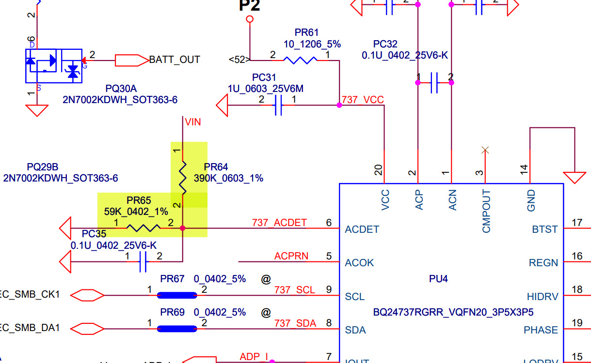

                                Measure the voltage to ground of the mosfet at PQ400.
                                Meter in 30v or higher scale.
                                Red probe to source (1-2-3) pin.
                                Black probe to ground.
                                Repeat for gate (4). Repeat for drain (5-6-7-8).
                                What is the voltage of PU402,
                                pin #5 (ACOK) ?
                                Pin #20 (VCC) ?
                                Pin #16 (REGN) ?
                                Post each measurement.

                                  DC IN = 19,96
                                  PQ400 voltage: Source = 19,48v ; Drain = 19,96v; Gate = 11,50v
                                  PU402 voltage :
                                  pin #5 (ACOK) =00.00v
                                  Pin #20 (VCC) =19,33v
                                  Pin #16 (REGN)=5.99v
                                  • mon2
                                    • Dec 2019
                                    • 14662
                                    Re: Dell E5440 no ldo 3v5v,
                                    ACOK is NOT OK.
                                    What is the voltage to ground of the ACDET pin ?
                                    • Tend0
                                      E.E.C.S
                                      • Oct 2021
                                      • 93
                                      • Burkina Faso
                                      Acdet= 2,65
                                      • mon2
                                        • Dec 2019
                                        • 14662
                                        ACDET is ok.
                                        Confirm the presence of resistor @ PR425. Measure the voltage to ground on each pin of this resistor.
                                        One side should be the same voltage as REGN pin = ~6 volts.
                                        Then remove all power -> meter in resistance mode.
                                        Check the resistance to ground of the ACOK pin. Based on the information posted, ACOK should not be @ 0 volts. This is an open-drain pin so the pull-up resistor @ PR425 is required.
