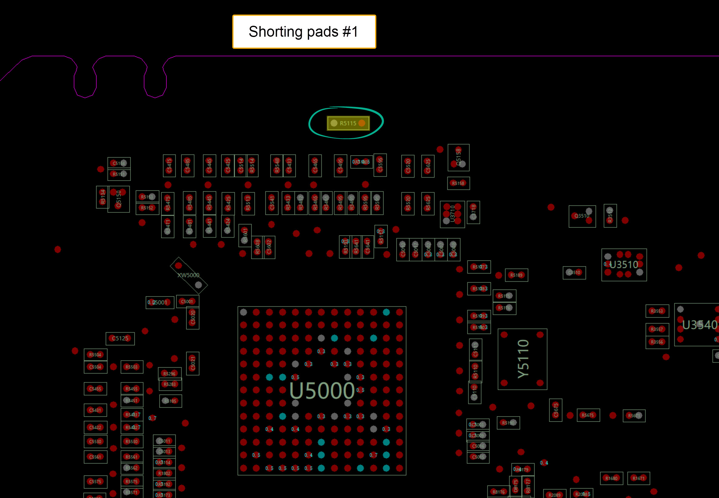

    3) Assuming the above voltages are ok, review the attached shorting pads on the PCB. Using tweezers, short one of the pair of pads to mimic the ON/OFF button.

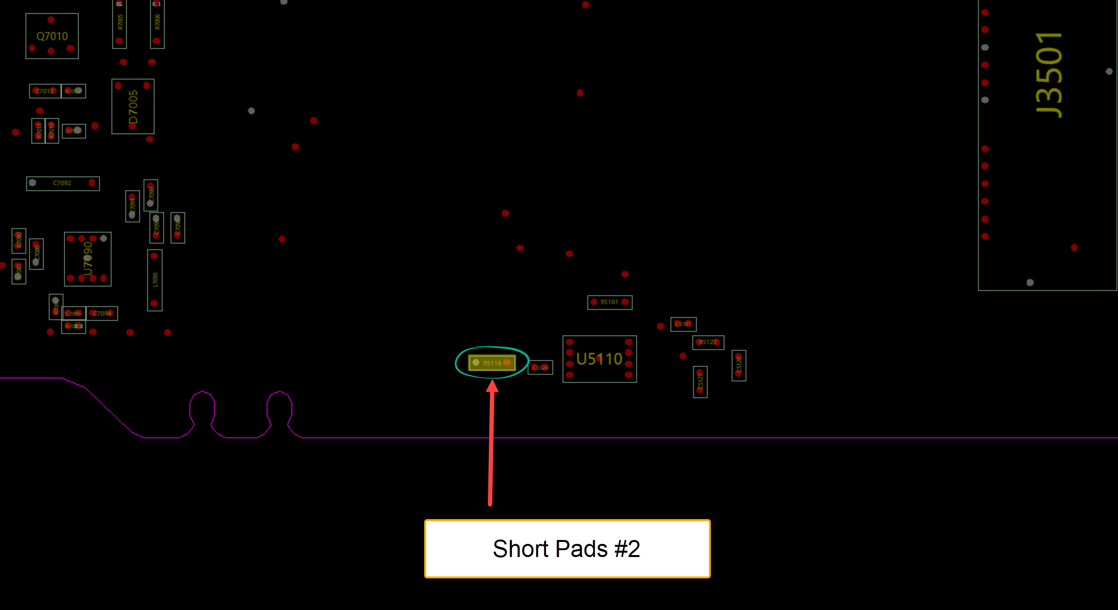

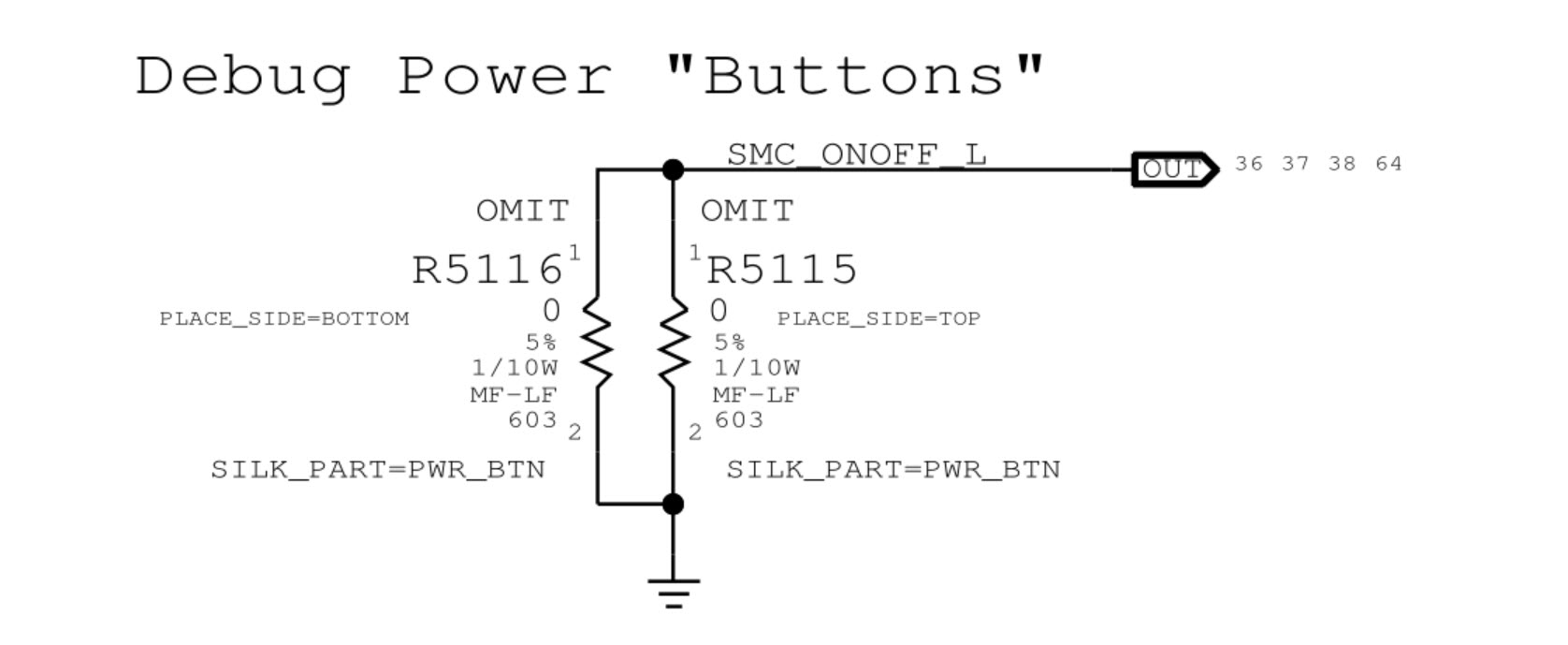

        Apple / Foxconn / PCB designers apply SMD shorting pads onto the TOP and BOTTOM side of the PCB layout.
        This is so you can remove the keyboard & trackpad and still turn on the logic board.
        These pads for this logic board are @ R5115 & R5116.
        Varying with how the logic board is on your table, you will find one pair only and these pads can be shorted with tweezers.
        See attached.

          Re: 820-00165-A green to orange no fan
          Got it.
          I have shorted them to ground but still Fan not powering on
          just to mention I have 3.3v on pin one of R5115
          What do you think?
            Yes, that voltage is ok and is active LOW. So when you short with tweezers to GROUND, the logic board will turn ON. From memory, believe that you should have fan spin if all is well even without this shorting of the pads.

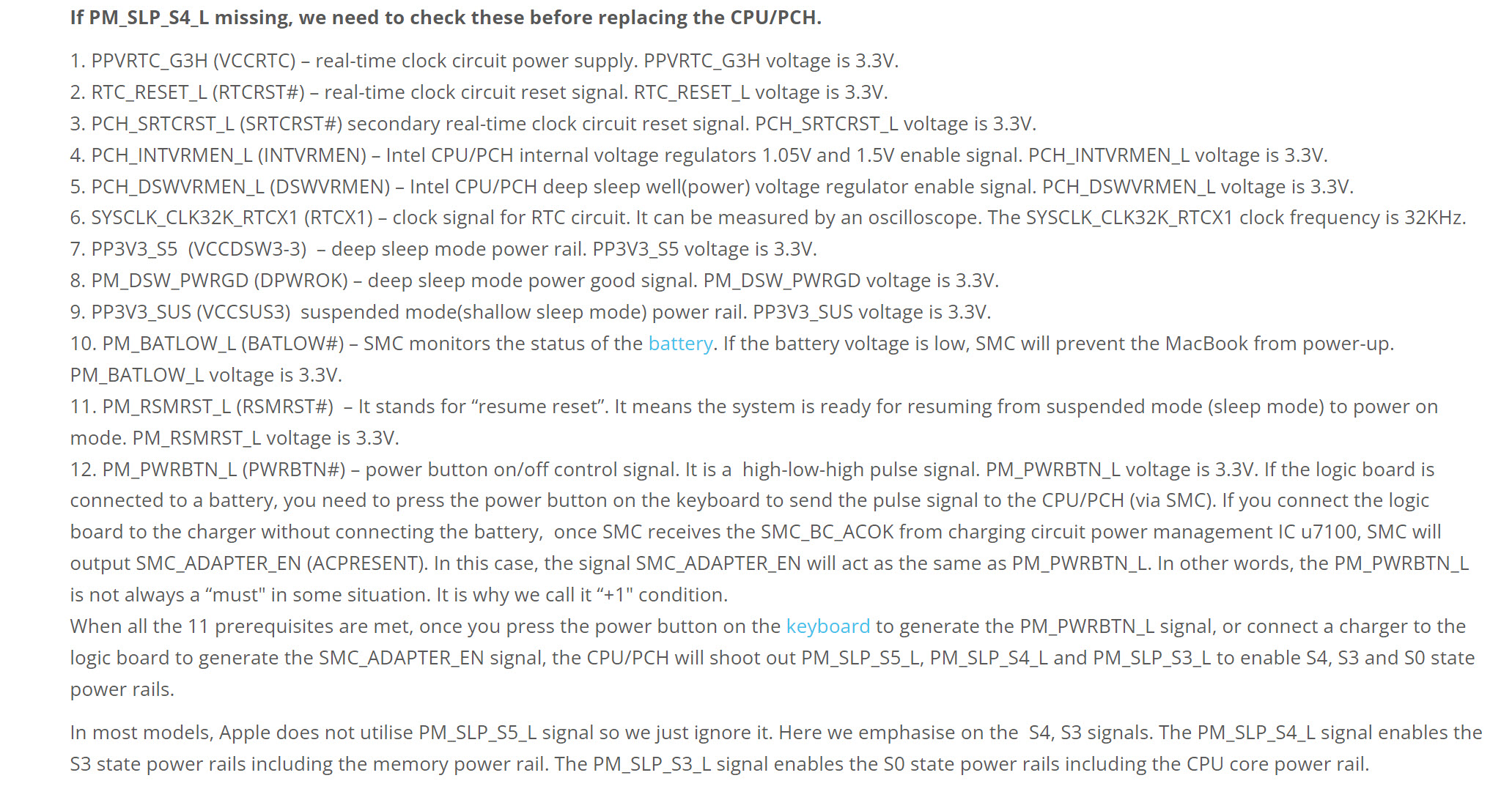

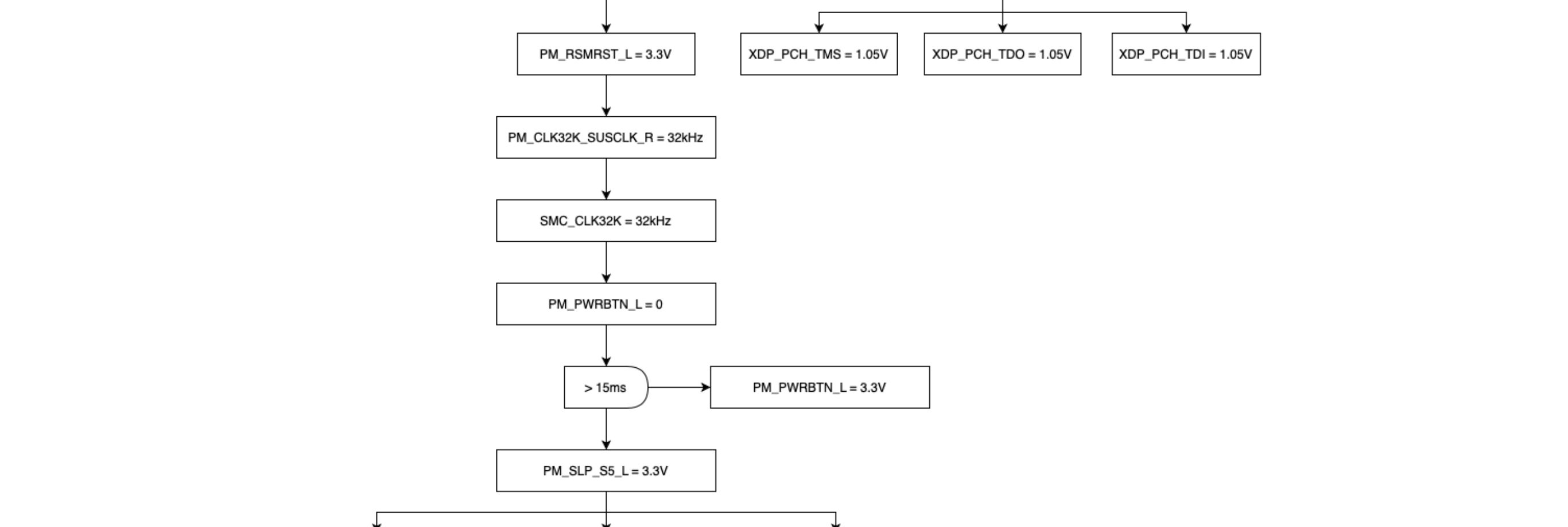

            Review this excellent website that details the power up sequence of the same logic board:
            https://www.it-tech.com.au/mac-q-a/pm-slp-s4-l-timing/
              I have checked all voltages under this list in the link:
              "If PM_SLP_S4_L missing, we need to check these before replacing the CPU/PCH."
              and all are present, i don't have oscilloscope so did not tested SYSCLK_CLK32K_RTCX1 (RTCX1)
              some times the macbook does start.
              Maybe the PCH is done i don't know
                When the board is NOT working, what is the voltage to ground of ALL_SYS_PWRGD ?
                Are you testing with only the adapter is there also a battery connected?
                Do go through the checklist from the above website - see attached.
