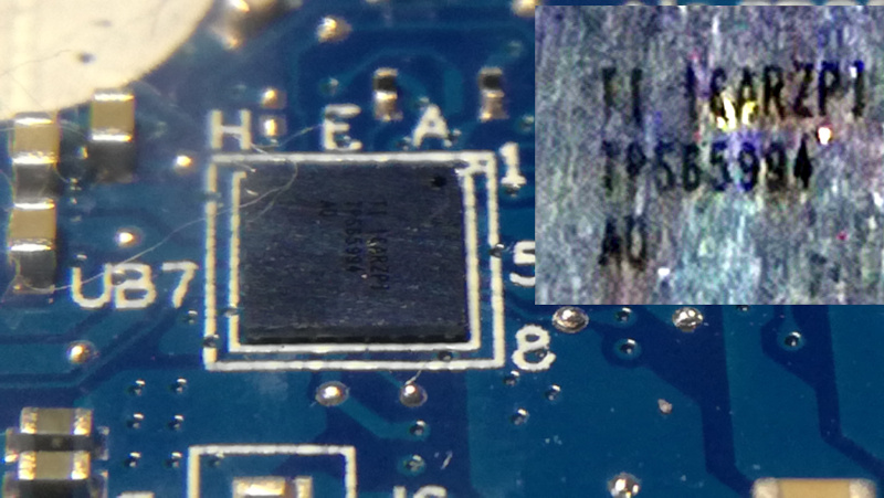

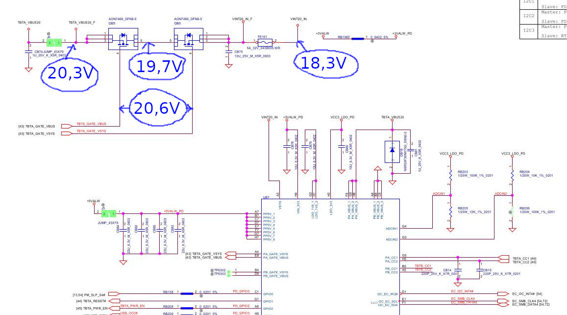

    Hi, Lenovo Thinkpad E15, board NM-D011 problem with power in USB-C.
    The problem is the low voltages on the gates of the transistors as shown in the pic1.
    The slightly conductive transistors got very hot until they broke the connection.
    Transistors need 4.5V at the gates to conduct, so the voltage should be around 25V.

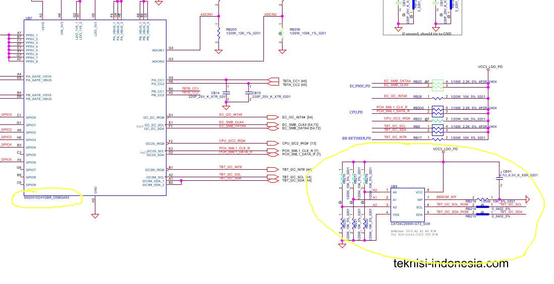

    It seems that the fault is in the transistor control system, in the photo TP565994, I found a pdf TPS65994 which is probably the same system in a different housing.
    If I understood the pdf correctly, the system is programmable, so buying a new one without software will not be successful. Please correct me if I misunderstood it.
    TP565994 works with UB9 CAT24C256 memory, so it's possible that there is some configuration in it. I wonder if reprogramming this memory wouldn't solve the problem. I'd like to try a file for it.
    Regards.

    These are N-channel mosfets so yes, the gate should be HIGHER than the voltage being passed between source/drain pins to enable.
    Respectively, the voltage should not be passing if the gate voltage is so low at 4v5.
    Remove all power. Remove fuse F6101 for now.
    Power up again. What is the voltage to ground of the 2nd dcin mosfet at F6101 pcb pads? It should be ~0 volts.
    If not, remove all power, meter in resistance mode.
    Measure the resistance across:
    Source (1-2-3) & drain (5-6-7-8)
    Source (1-2-3) & gate (4)
    Gate (4) & Drain (5-6-7-8)
    Post each measurement. Do these checks for each of the DCin mosfets. Suspecting that the 2nd mosfet (at least) is defective and leaking.

      i doubt that they are programmed, these usb c controllers tend to fail, especially when using fake chargers

            1. VCC3_LDO_PD ~ 84Kohm for GND, voltage = 3,44V.
            2. VINT20_IN over range, in the diode test the same no resistance to GND, voltage = 18,3V.
            3. TBTA_VBUS20 ~ 135Kohm, voltage with power supply = 20,3V.
            Power Supply Lenovo 65W USB-C after plug voltage 5V changes to 20,3V so control works.
            I find only a similar boardview, haven't found ADCIN1 and ADCIN2 yet.
            I bridge only QB6 mosfet, then the laptop can be turned on and the battery charging works but the qb5 heats up because there is a voltage drop on its diode.
            The voltage at the QB5 gate is 0.3V higher than the voltage from the power supply, so something is going on there.
            I hope I am understood, sorry for the mistakes.
            ADCIN1 = 0,4V
            ADCIN2 = 3,5V
            I think the are correct.

              I noticed that the UB7 heats up after a while, I missed it before. It's too hot.
              Thank you all very much, best regards.

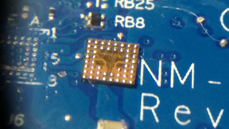

                            I have similar problem. PD doesn't start and 'spread' on motherboard.
                            On one forum a guy said that TPS65994AD controller has external firmware which is stored in CAT24C256WI-GT3_SO8.
                            Could someone please share the dump of this EEPROM?
                              • 21844
                              PD Firmware, post 25 https://www.badcaps.net/forum/troubl...07#post3601007
