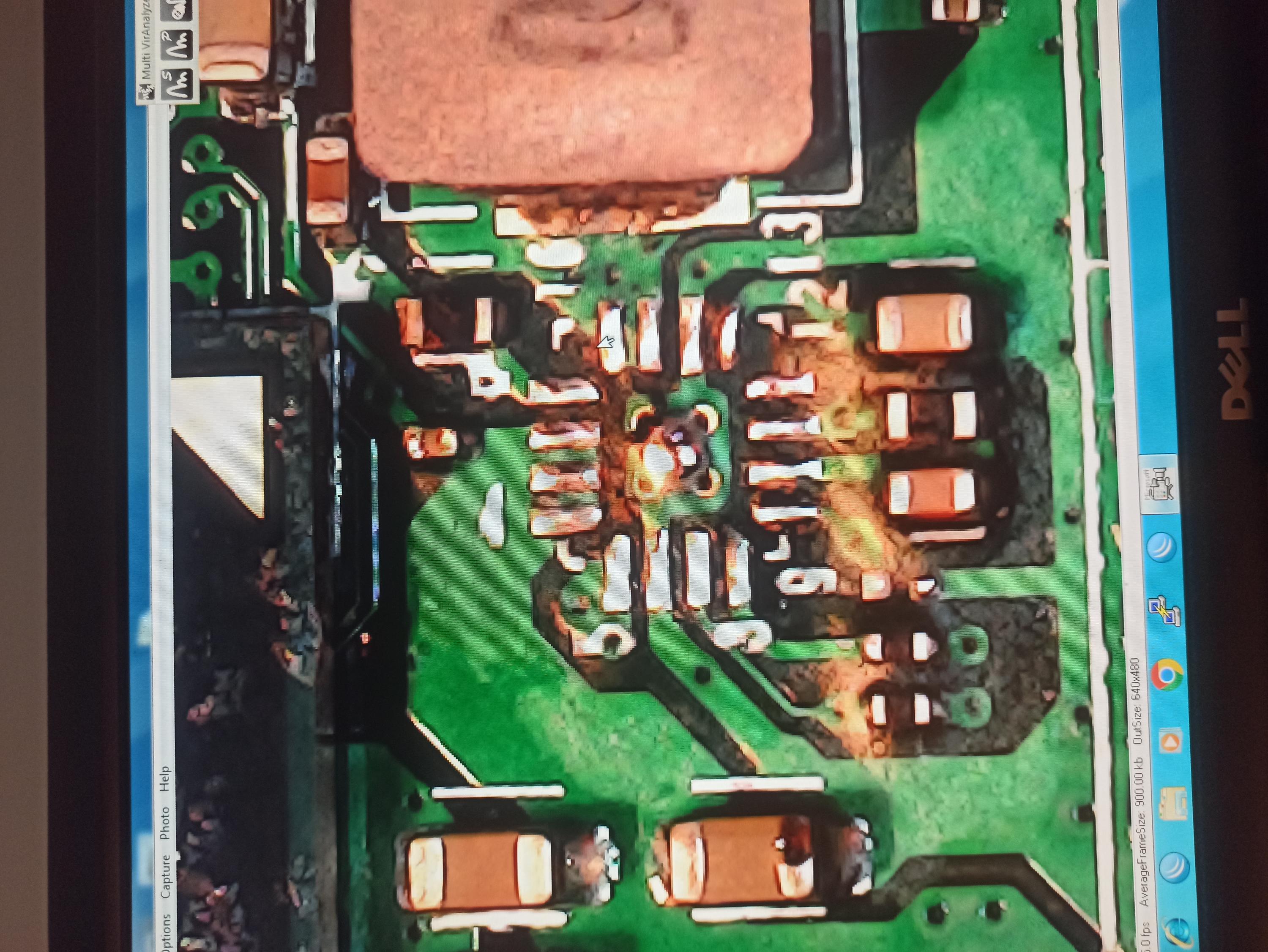

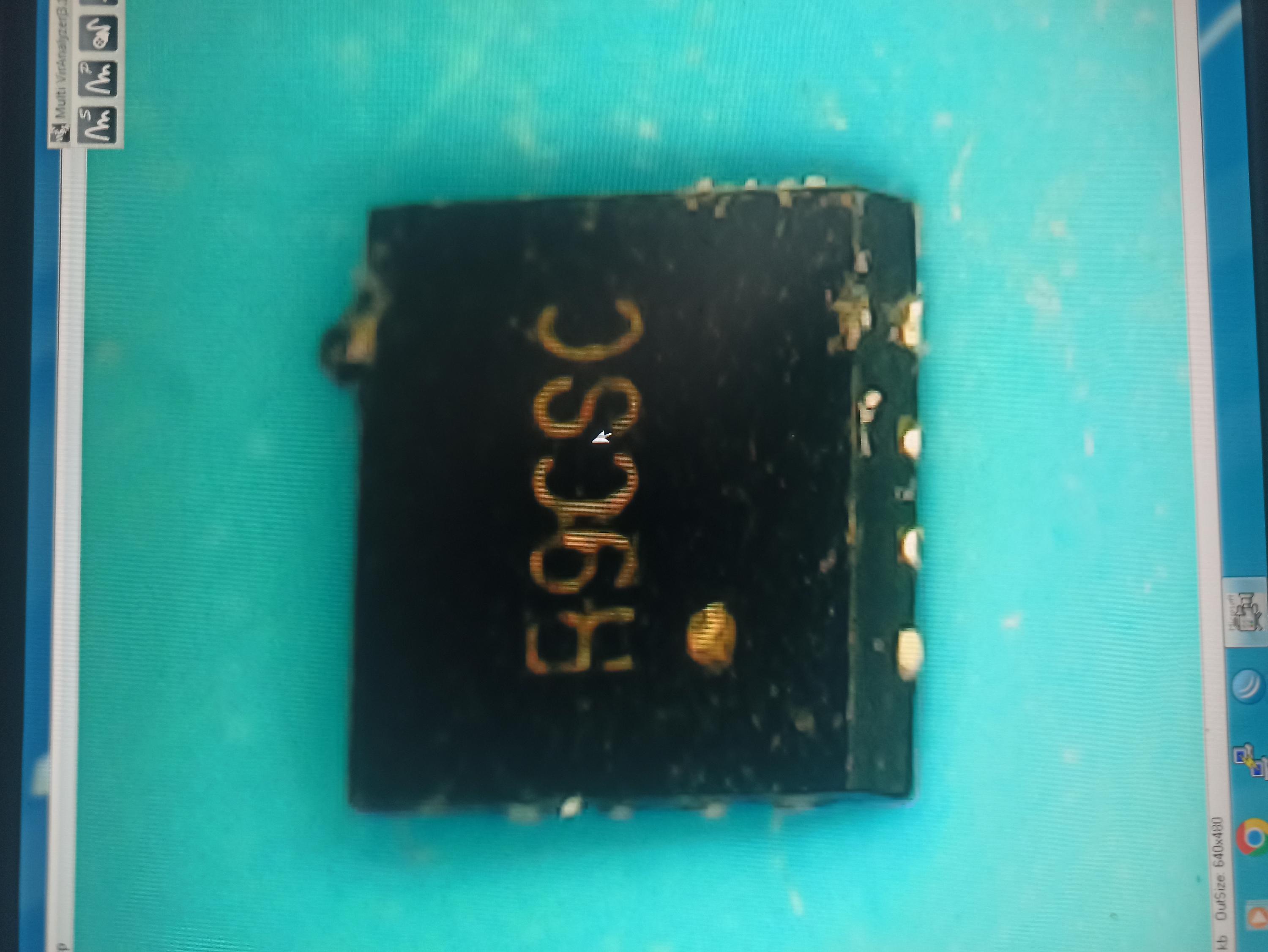

    have this UMAX 14wa that switched charger polarity. i found some bad ic and i need to identify it.
    Mark on it is
    R9CSC
    it is voltage regulator

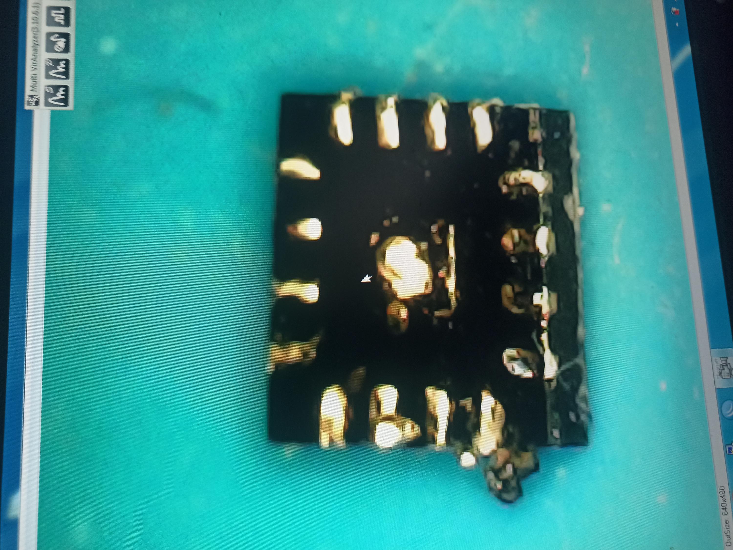

    post more info and pictures. Need to see the footprint and number of pins, package type, and if there`s any manufacturer logo besides the marking code
    • ktmmotocross
      Boardkiller
      • Feb 2014
      • 3628
      • slovakia
      Re: UMAX 14wa - switched charger polarity need identify ic
      no other marking

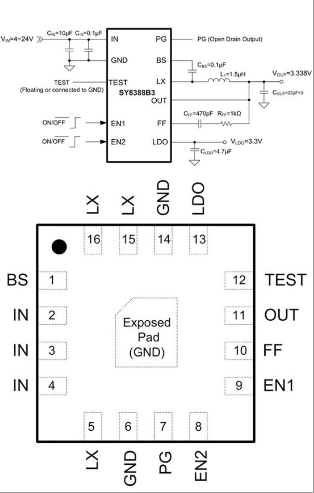

        Originally posted by ktmmotocross
        no other marking
        I only find this part from silergy
        SY8388B3RHC
          thanks. from here it looks like it.
          Silergy marking codes
          https://www.forum.diacom.az/viewtopic.php?p=680
            • 22095
            One of those lists at that forum is a copy of ours https://www.badcaps.net/forum/showpo...1&postcount=12 .The R9***/SY8388B3RHC has been posted at the russian vlab forums in their silergy thread,and at the 4pda forum, i havn`t added it to our list there`s no pictures or datasheet available (only to silergy customers) ,so there`s no way to confirm it. Overview https://www.silergy.com/zh/productsview/SY8388B3RHC
            The SY8388B3RHC can be found on Teclast F15 and Chuwi CoreBookXPRO motherboards,there`s no full schematics available for either of them but i found a BOM and motherboard outline for the Chuwi
            https://www.badcaps.net/forum/showthread.php?p=1183457
