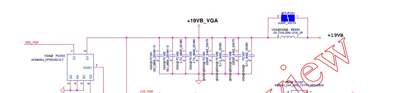

    Hi
    I getting 13.6v instead of 19 on this board
    I have measured D1 of PQB02 (AON6994) and getting same 13.6
    I dont know how to test those Dual Asymmetric MOSFET
    Can you please help me understand which IC is failing ?
    attached link to schematic and boardview
    https://www.badcaps.net/forum/showth...light=la-f115p

    Re: LA-F115P +19VB = 13.6v instead of 19v
    Do you have 19V at the adapter level ?
    Is the battery connected ?
    What is the voltage of the battery at the battery connector ?
      13.6V is very likely correct as NVDC is involed here.
          13.6V is very likely correct as NVDC is involved here.
          the laptop fan turns on for a second and then stopes. there is no post.
          when the power button pressed, i see about 0.8v in PLI01/02 and around 0.9 on PLV01/02.
          I get hit from CPU.
          Can you guys please suggest another test direction ?
                Just to understand you, even though it says 19v in schematic and i have 13.6 on this coil (PLV11) it is still reasonable ?
                • mon2
                  • Dec 2019
                  • 13835
                  Correct.
                  https://en-support.renesas.com/knowledgeBase/6680047
                    tried with another good charger still same.
                    voltage on bat 11.3v
                    I can also see that the capslock is always on
                        You beleive it or not but 13.6V as main rail is correct. You are getting vga core/cpu core and thats a good sign.
                        On page3/4, you have all the rail listed. Find out what is missing.
                        What is the consumption on your dc supply
                        01.When off
                        02.When turned on with ram stick
                        03.When turned on without ram stick.
