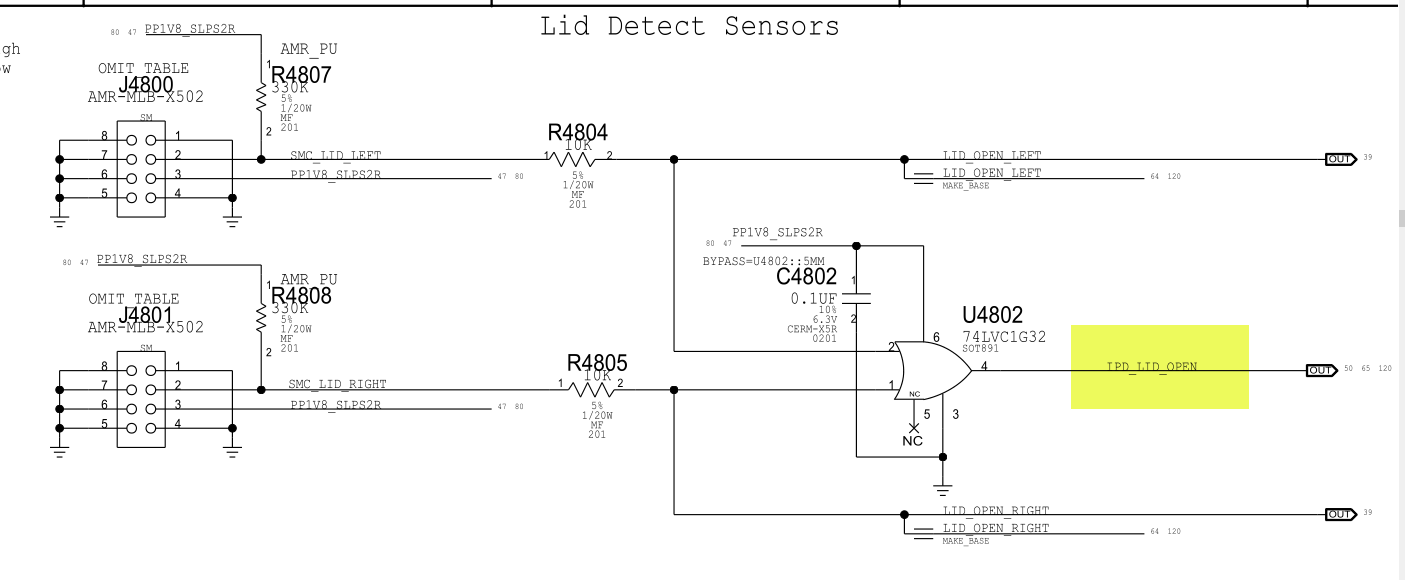

                Review this article, you should be able to perform the SMC reset:
                https://osxdaily.com/2019/01/14/how-...ro-2018-later/
                Closing / opening lid is the lid sensor in the trackpad.
                Check the voltage to ground of IPD_LID_OPEN.

                  Re: Macbook pro 1990 help
                  The 4 pin IPD_LID_OPEN R5102 resistance of the cover sensor goes, and 1.8v goes through both measurements when there is an image on the screen and when the image is cut off. I get 3.38v when the screen is on and the screen is gone in the R9819 measurement. I try SMC reset but the result is the same.
