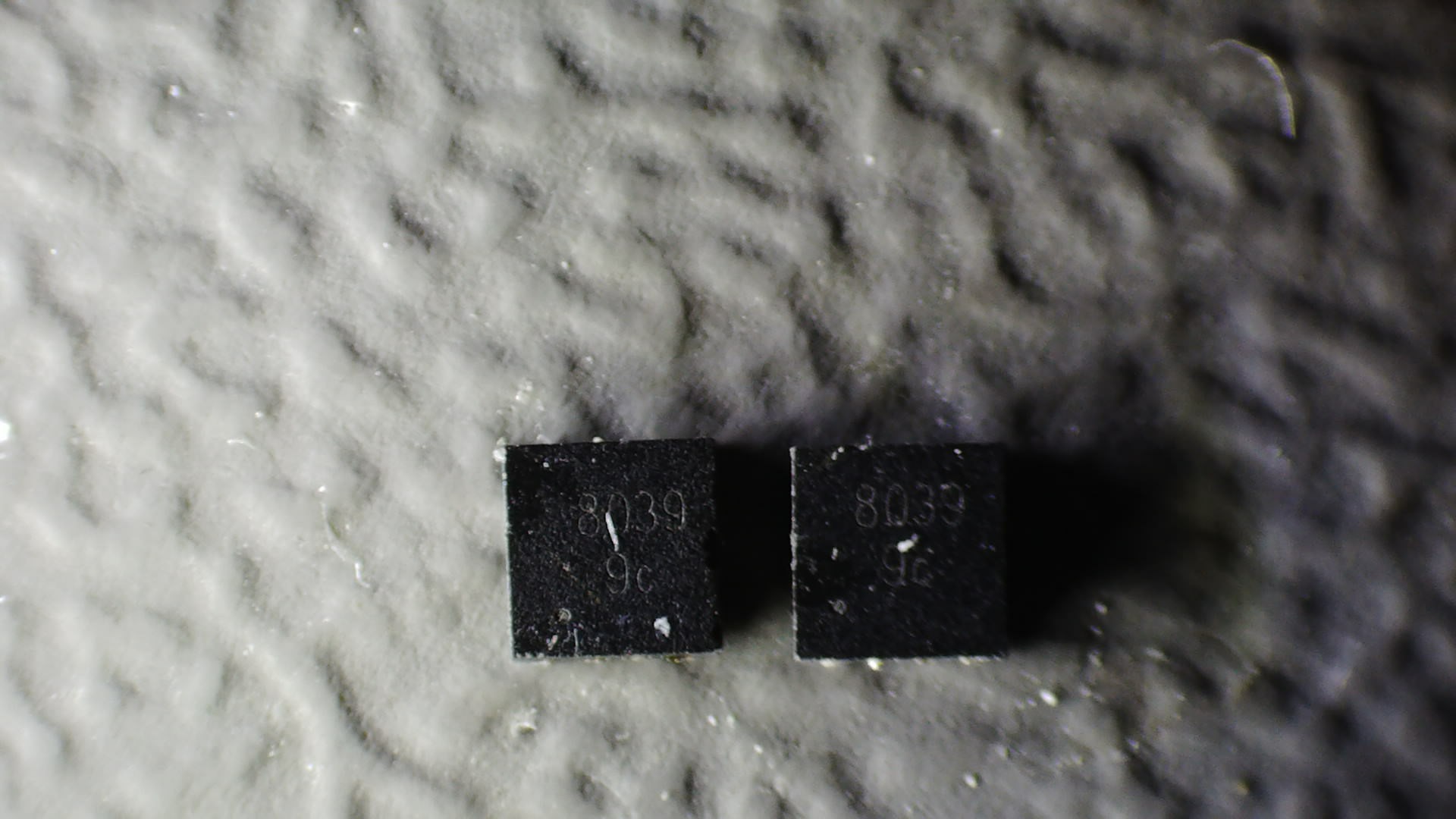

                  Re: 8030/8039mosfet
                  abviously NOT Toshiba part
                  i will post marking pic
                  • Dinneke
                    • Apr 2014
                    • 154
                    • Netherlands
                    Re: 8030/8039mosfet
                    markings
                    replacing as i wrote

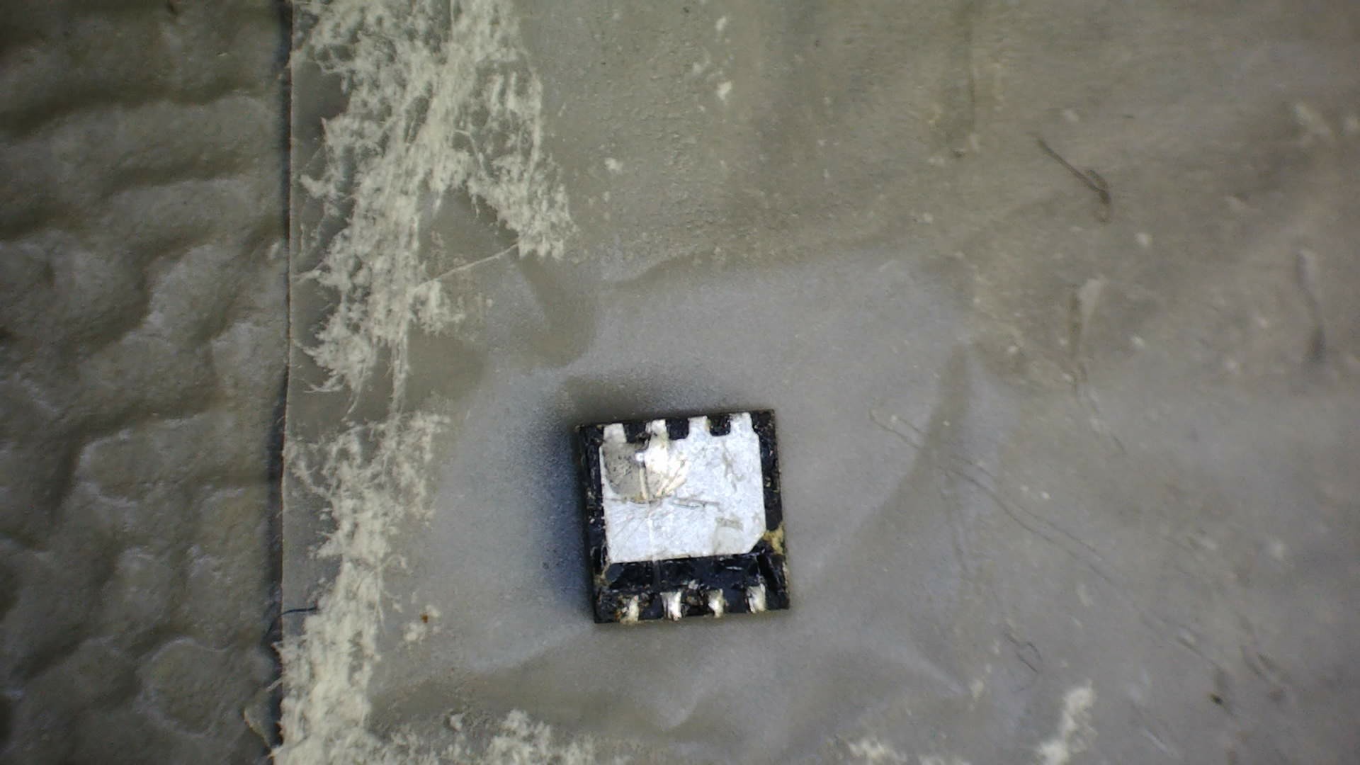

                      Re: 8030/8039mosfet
                      Can you post pics of the bottom side as well?
                      These do not look like mosfets.

                        Re: 8030/8039mosfet
                        Are mosfets SURE, 8 pins, 4 on one side common and a heatpad connected to Drain
                        Repaced by Sisa18 the N_channel ofcourse
                        • mon2
                          • Dec 2019
                          • 14677
                          Re: 8030/8039mosfet
                          How did you conclude this mosfet is a p-channel ?
                          Never mind..found the datasheet. Indeed it is P-channel. Strange that Toshiba has the same part #, yet N-channel.
                          • Dinneke
                            • Apr 2014
                            • 154
                            • Netherlands
                            Re: 8030/8039mosfet
                            I know how mosfets work....thanks for the datasheet
                            Repair succes
