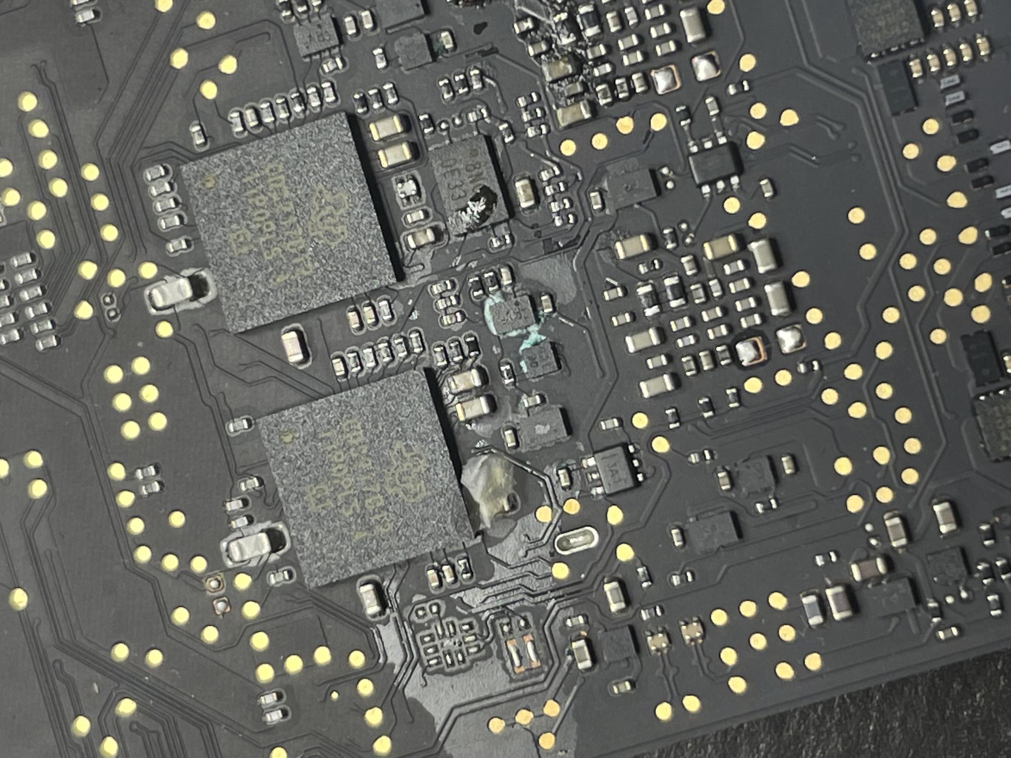

    Hi. Having this M1 after liquid it has only 5V on USB ports, but oddly it can be powered on from the battery source only without a jumper S5191.
    Liquid affected IC's:
    UF400, UF500
    UF725, UF720, UF710
    UF260
    UP800, UP900, QD530, UC710, UD560

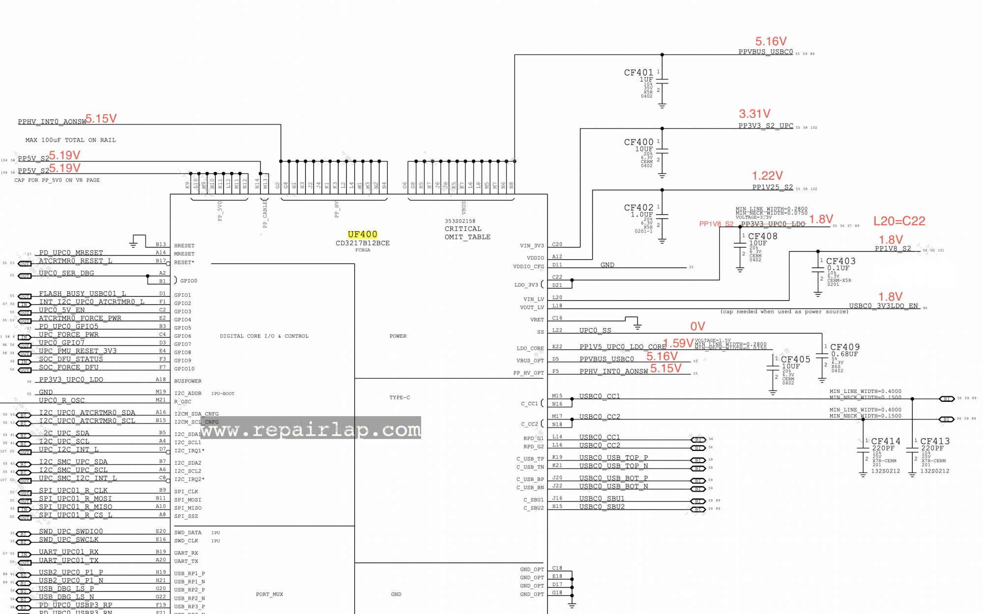

    UF400 VOLTAGES:
    PPHV_INT0_AONSW.............5.15V
    PPVBUS_USBC0...................5.16V
    PP1V5_UPC0_LDO_CORE .....1. 59 V
    UPC0_SS............................0V
    USBC0_3V3LDO_EN.............1.8V
    PP1V8_S2 ...........(PIN L20)..1.8V
    PP3V3_UPC0_LDO (PIN C22) 1.8V
    PP1V25_S2.........................1.22V
    PP3V3_S2_UPC....................3.31V
    PP5V_S2.............................5.19V
    On the schematics it says PP3V3_UPC0_LDO but openboardview says PP1V8_S2, So I assume that the schematic isn't correct? Pins PP1V8_S2 (PIN L20) PP3V3_UPC0_LDO (PIN C22) go to the same component pin, another words are bridged.

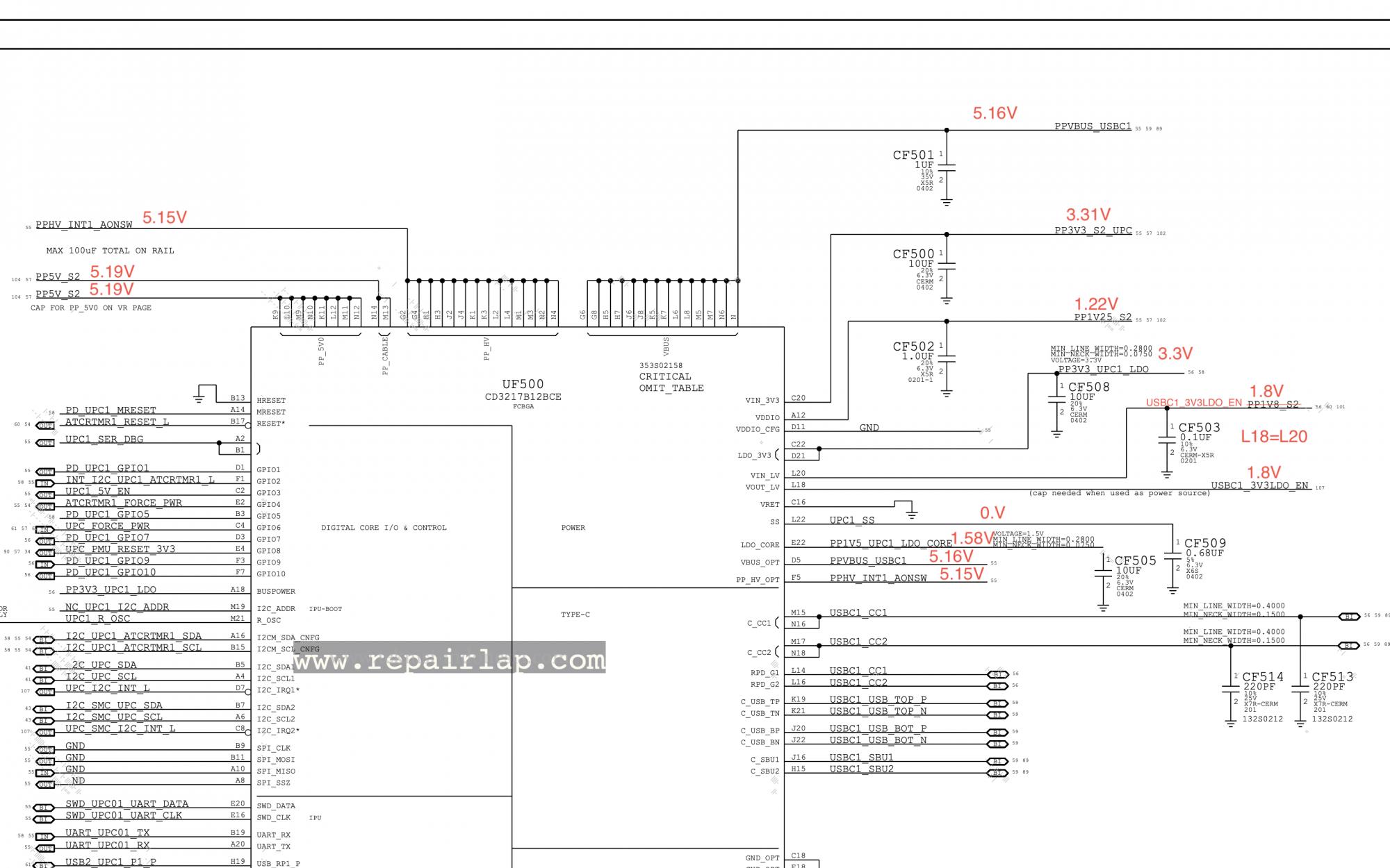

    UF500 VOLTAGES:
    PPHV_INT1_AONSW...............5.15V
    PPVBUS_USBC1.....................5.16V
    PP1V5_UPC1_LDO_CORE .......1.58V
    UPC1_SS..............................0V
    USBC1_3V3LDO_EN (PIN L18) 1.8V
    PP1V8_S2 ..............(PIN L20).1.8V
    PP3V3_UPC1_LDO..................3.3V
    PP1V25_S2...........................1.22V
    PP3V3_S2_UPC......................3.31V
    PP5V_S2...............................5.19V
    On the schematics it says PP1V8_S2 but openboardview says USBC1_3V3LDO_EN, so I assume that the schematic isn't correct? Pins USBC1_3V3LDO_EN (PIN L18) PP1V8_S2 (PIN L20) go to the same component pin, another words are bridged. I'm not sure if those schematics can be trusted. I have been going through test point on the board that clearly have some voltage in it, yet schematic claims that is NC.
    Conclusion. I couldn't find any abnormalities on the board, I have identical working board to compare and the voltages measured are identical. ;/;/

    UF400 VOLTAGES:
    Is this a correct measurement ?

      I think that my post might have been either misunderstood or hasn't been read fully. Yes it's correct. Same voltage when measured a working M1 motherboard.

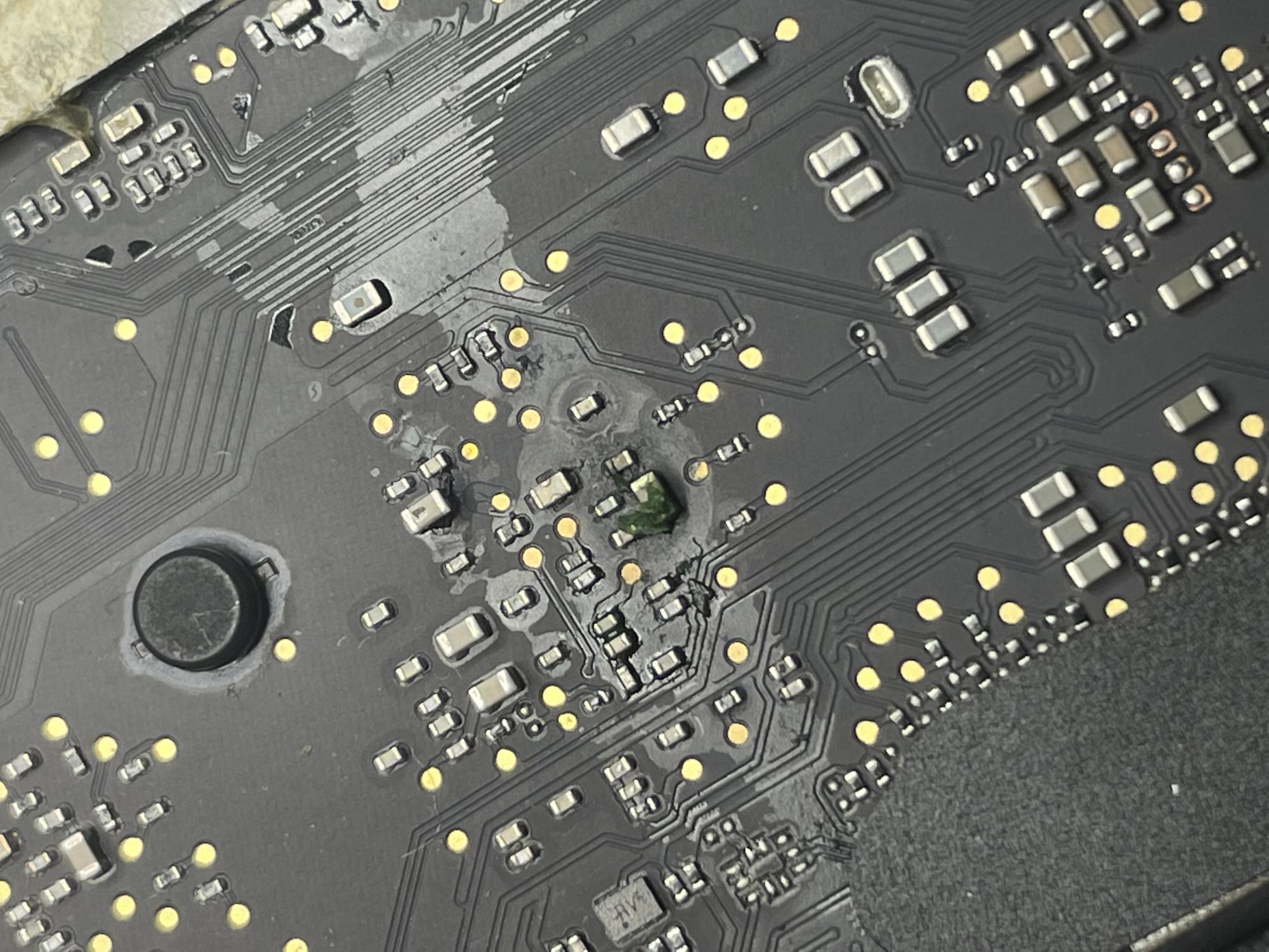

        Got it. Manage to find a short, the guilty parts name was UP900 keyboard backlight pwm. I thought I'll be able to source out the part from the old 2019 MacBook Pro but it's got different components. Does anyone know where to get it or some sort of substitution to it? Kind thank you
