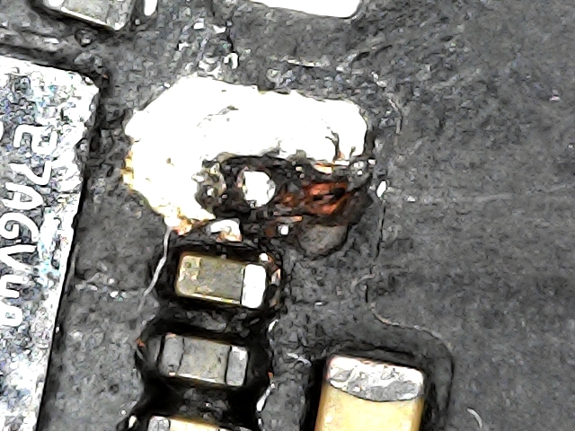

    HOW BAD IS MY PCB DAMAGE A2338 820-02337 water damage burnt caps

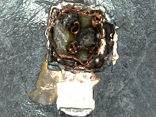

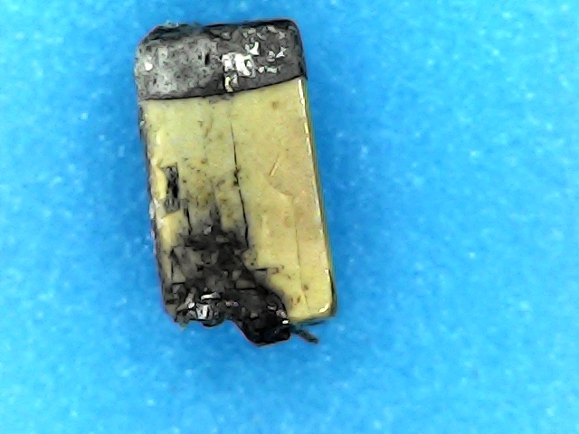

    Short on ppbus. Taking 3a at 1v and nothing is heating up. I have at least 3 pads that are badly burnt from capacitors. Ive scraped (at least attempted to) not sure how good I did? Are these possibly containing internal shorts? Do you think they need to be scraped more?

    Check their resistance to ground. You may be shorting to the next layer(S) of this multilayer pcb. No power during these tests.
      Thanks for the replay.
      They all measure at 0.5 ohms (a dead short I think)
      What else can be done if they are shorting to the next layers? Cut them out?
      These are all part of the left speaker channel.
      • TheNuclearOption
        • Jan 2024
        • 31
        There was an internal short. I was able to carve it out. Ppbus is no longer shorted to ground but it is measuring at 21 ohms. I'm getting 12.4 volts at ppbus when plugged in. Is a partial short. Likely still? It's drawing 0.01 amps now on ppbus

                Yes I removed the blown fuse. I'm not sure what side's the downstream side but ppvbatt (bottom pad on the motherboard in the photo) is one side of the fuse ppbuss(top pass on the photo) is the other. Ppbuss was showing a short to ground previously until I carved out the internal short. Now it's showing 21 ohms I think. I'm not sure if that photo comes across
