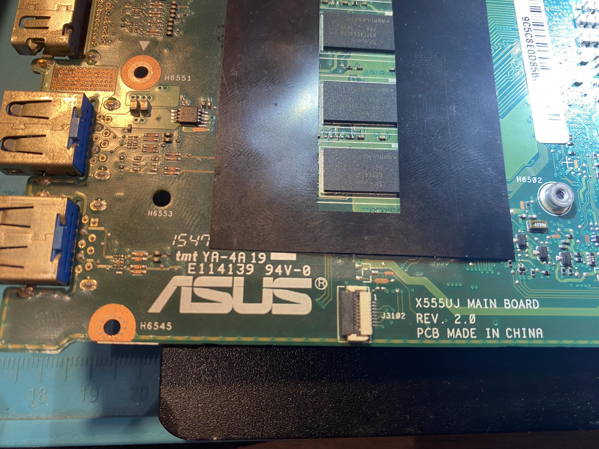

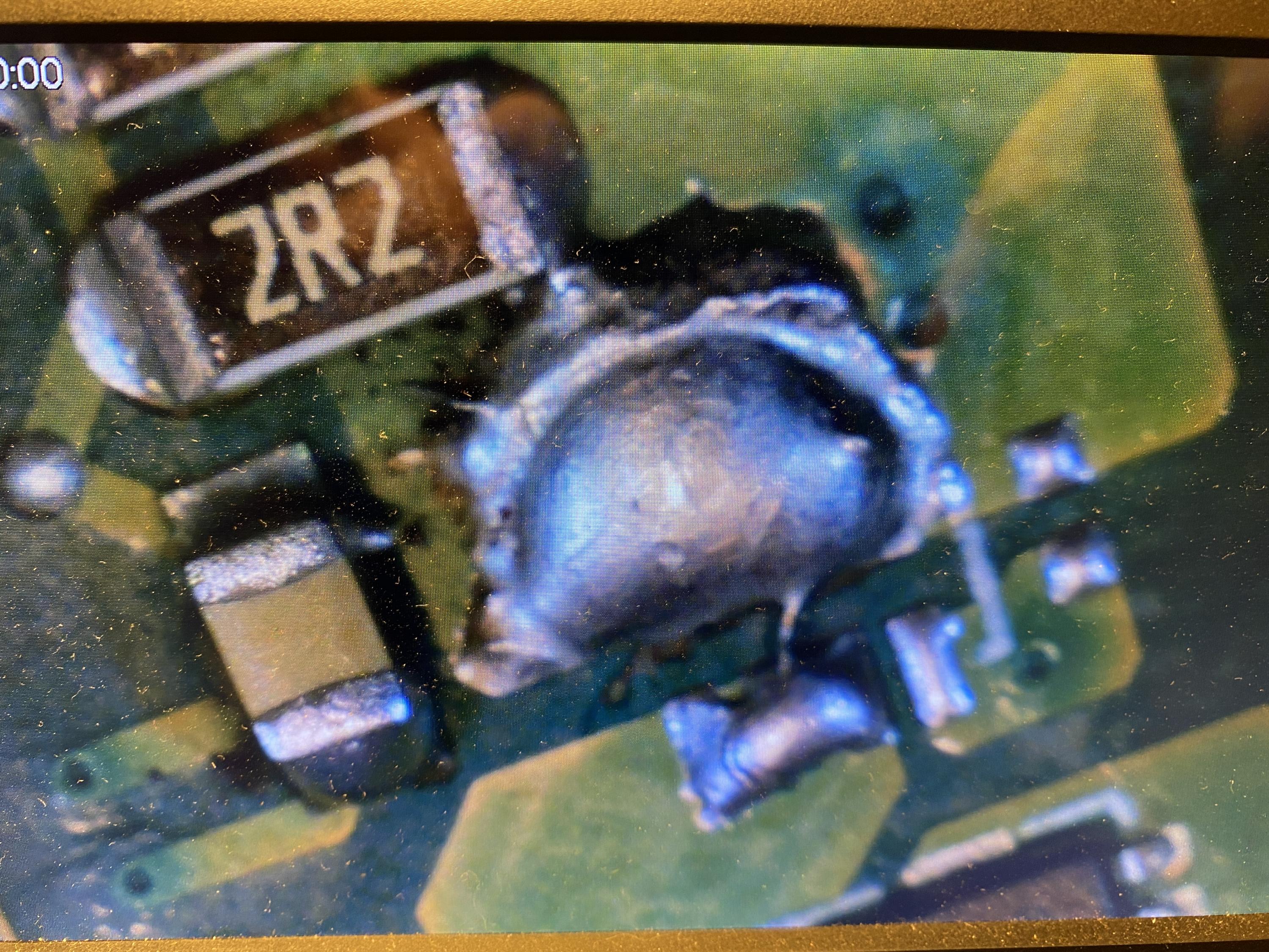

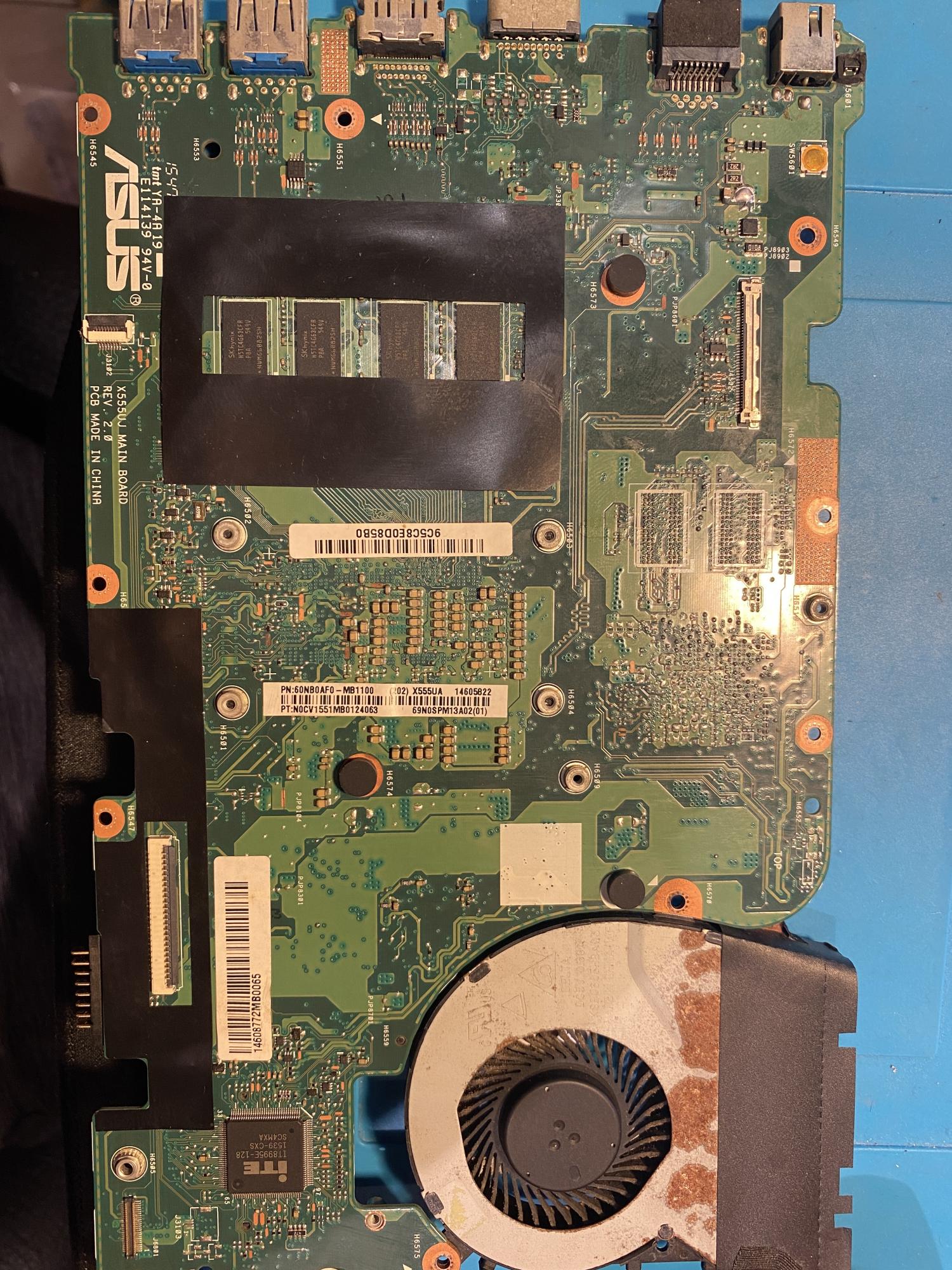

Please Help. Asus F555U Wont work on new battery.
  • roxboy1984
    • Jan 2022
    • 177
    • South Africa
    I have an Asus F555u that stopped working and i took it to another technician who jumped one of the mosfets as you can see in the pic and the machine now turns on and runs on AC but it wont work on battery at all despite the battery being new.
  • mon2
    • Dec 2019
    • 14680
    Re: Please Help. Asus F555U Wont work on new battery.
    1) Never a good idea to bridge the mosfet for a real fix.
    2) Measure the voltage to ground on pin # 4 of this mosfet pad on the PCB = GATE pin. If working properly, the gate voltage should be ~25 volts.
    3) The mosfet that was bypassed is also a N-channel mosfet. Appears to be the same size as the AON7410 that is on the board. Measure the dimensions of each and compare if that will work for you.
    4) Any suitable / same size mosfet will work (30V or higher rated) but has to be N-channel. Similar or improved current support (ie. Rds should be as low as possible = allows for the same or higher current support as the original mosfet).
    Then test again. If the issue is not fixed, remove all power and check the resistance across the AON7410 mosfet that is onboard and showing in your posted pic.
    source (1-2-3) & drain (5-6-7-8)
    source (1-2-3) & gate (4)
    gate (4) & drain (5-6-7-8)

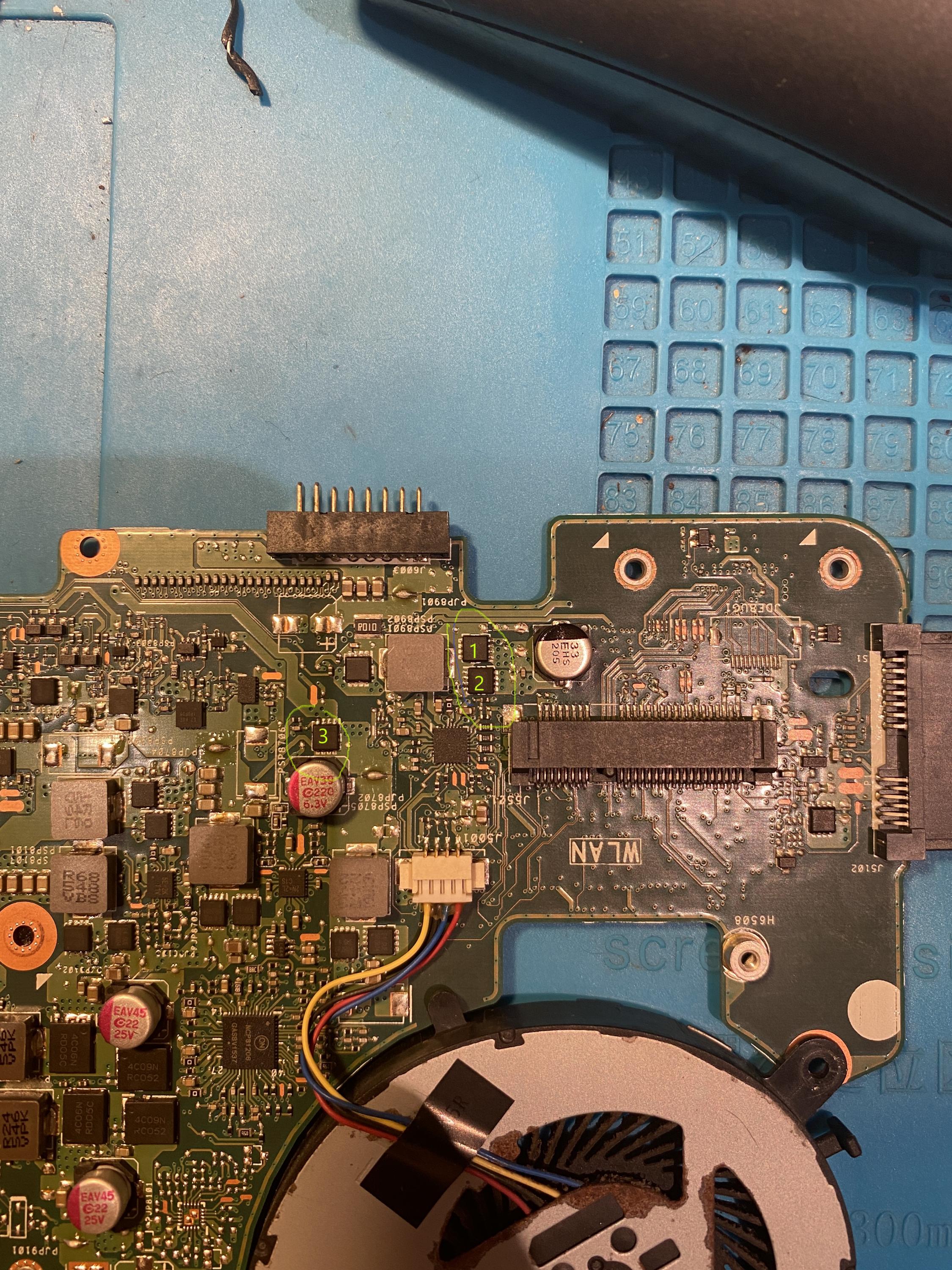

      Ok so i measured the voltage to ground from the gate pad as you suggested and it was 0.113V
      I found a replacement MOSFET and im getting 24V on the gate. i tried putting everything back together and all the lights and fans etc spin but now im getting no display. tried external via HDMI and nothing.
        And when i connect the battery it wont switch on at all. as i insert charger the light bulb led flashes and then goes off.
          There are 2 x DCin mosfets between the external power adapter and the main logic board power rail.
          You are working with one of these DCin mosfets.
          Remove the battery as it is not required to boot the logic board.
          Attempt to power up using only the external power adapter. The power adapter should be the recommended unit for this laptop.
          Is your logic board working properly ? If not, power down and double-check your work.
          Meter in resistance mode.
          With no power, also measure the RESISTANCE across the mosfet pins for the other mosfet.
          Post the resistance measurements. With the posted details, the logic board should be able to boot like before but using only the external power adapter but with both of the DCin mosfets installed.
          If the gate voltage of each of these DCin mosfets is ~25 volts (24 is fine), then the mosfet is being told to turn ON. This is correct for using only the external power adapter.
          The use of the battery and battery charge function are other cases to review but this should work as noted / with video, etc. With no power -> carefully double-check your work.

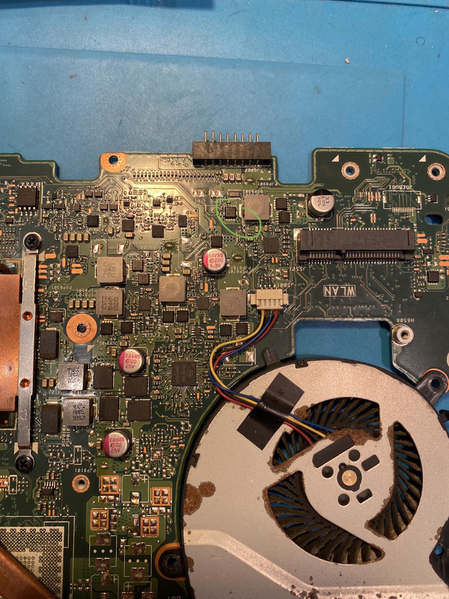

                      Thanks so much. Im battling a bit with no Schematic. is this is the battery mosfet in the pic? If so, the measurements are as follows.
                      Source (1-2-3) and drain (5-6-7-8) = 8.1 mega Ohm
                      Source (1-2-3) and gate (4) = OL
                      Gate (4) and drain (5-6-7-8) = 13.5 Mega Ohm
                      in diode mode on this mosfet i get the following also.
                      Source (1-2-3) and drain (5-6-7-8) = 0.47V
                      • mon2
                        • Dec 2019
                        • 14680
                        Mosfet resistance checks are fine.

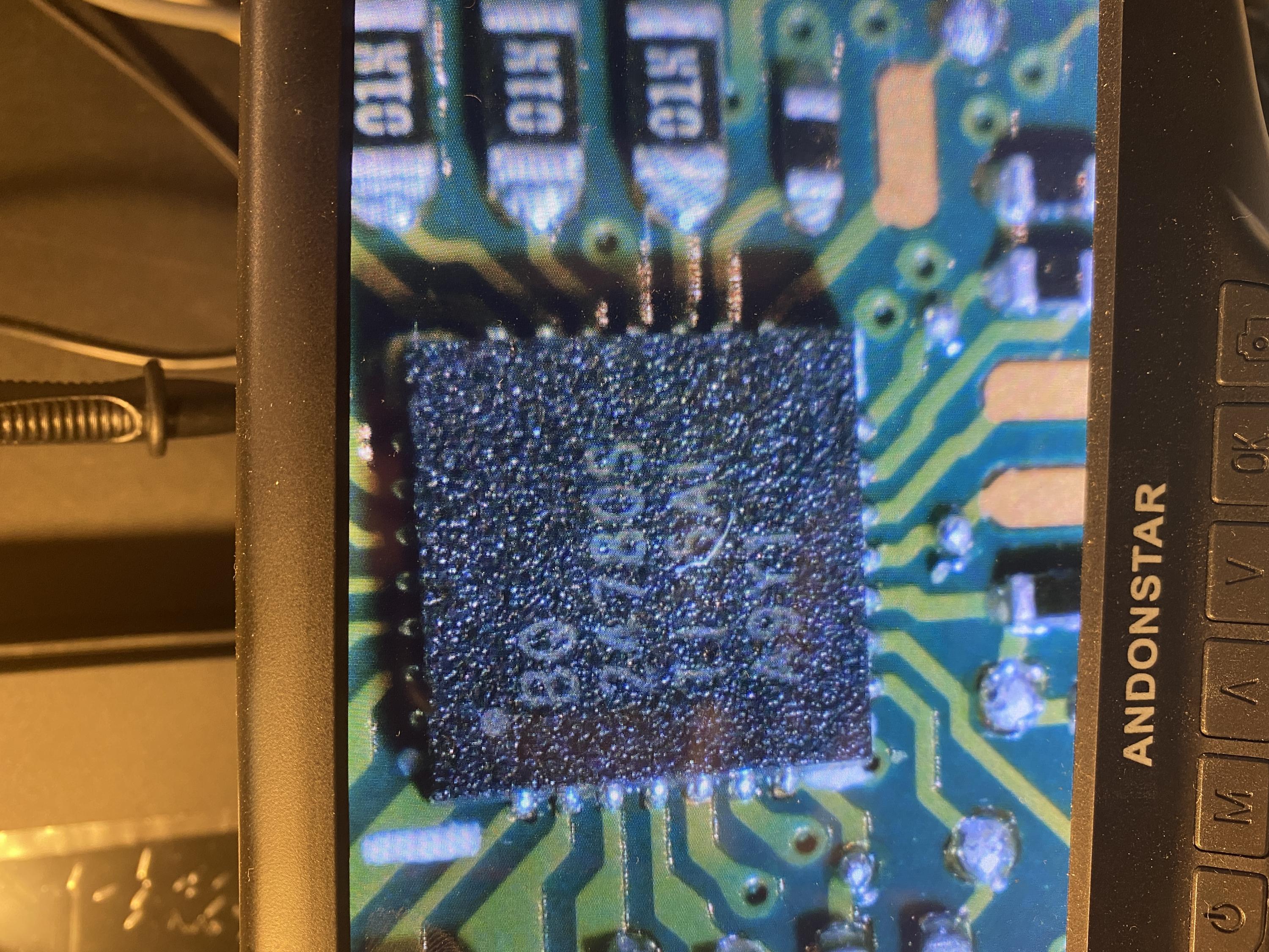

                        Which charger IC is nearby these mosfets?
                        Post the topside markings on the ic.
                        From this information we can study a typical schematic of the charger IC design. Then we will be able to confirm which mosfet is the battery mosfet.
                        Also, with no power, continue to check the resistance of the other mosfets near the square charger IC. The charger IC will most likely be the BQ charger series from Texas Instruments.

                          Attached is a pic of the charger IC nearby. Ive attached a pic of the other mosfets around charger IC which ive numbered to correspond to the below readings.
                          Mosfet 1
                          Source (1-2-3) and drain (5-6-7-8) = 4.6 mega Ohm (0.47V on diode mode)
                          Source (1-2-3) and gate (4) = 25.5 Kilo Ohm
                          Gate (4) and drain (5-6-7-8) = 2.64 Mega Ohm
                          Mosfet 2
                          Source (1-2-3) and drain (5-6-7-8) = 7.8 mega Ohm (0.47V on diode mode)
                          Source (1-2-3) and gate (4) = 0.21 Mega Ohm
                          Gate (4) and drain (5-6-7-8) = 6 Mega Ohm
                          Mosfet 3
                          Source (1-2-3) and drain (5-6-7-8) = 43.8 kilo Ohm (0.51V on diode mode)
                          Source (1-2-3) and gate (4) = 1.082 Mega Ohm
                          Gate (4) and drain (5-6-7-8) = 0. 672 Mega Ohm
                          • mon2
                            • Dec 2019
                            • 14680

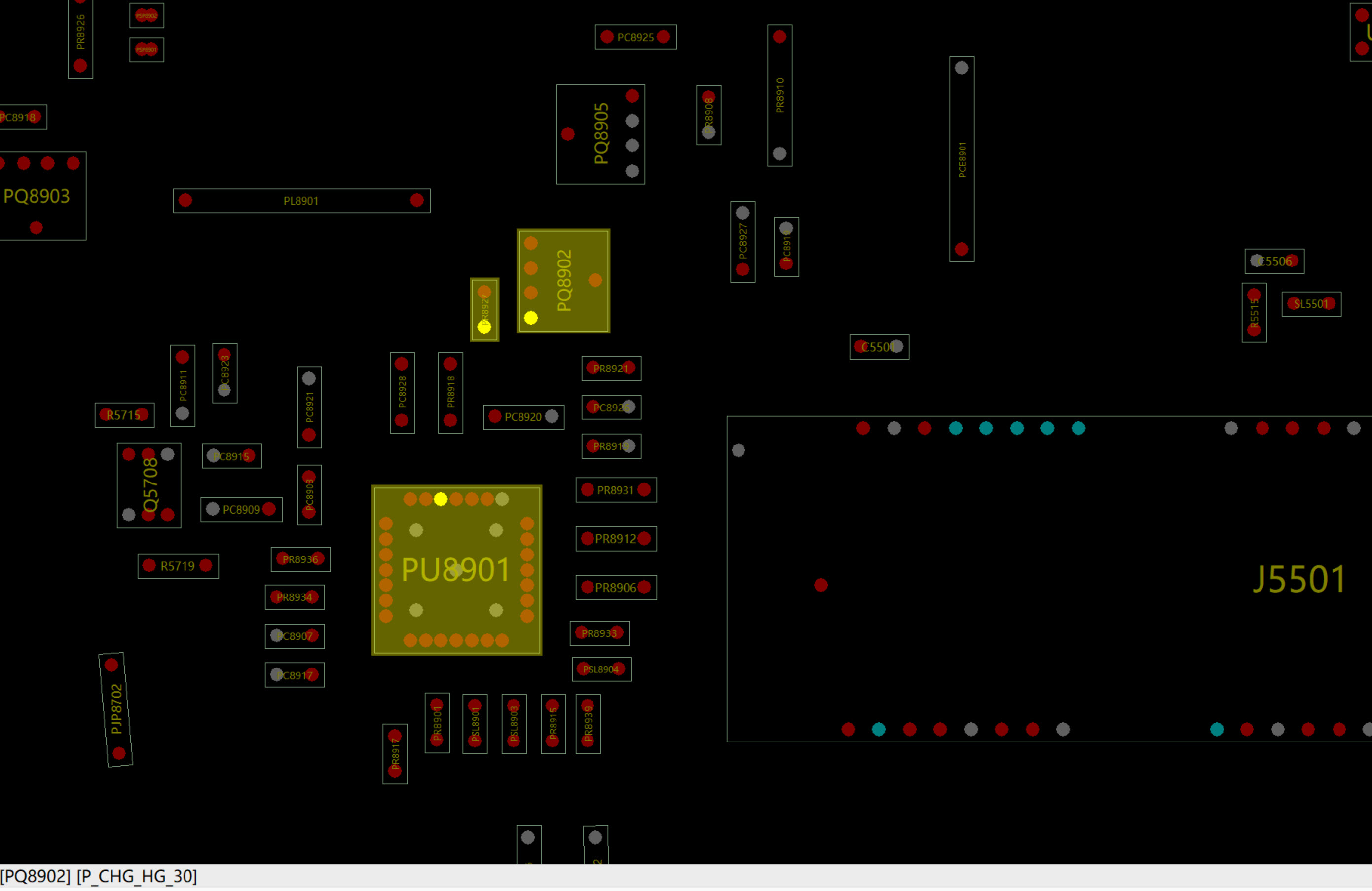

                            Ok. Charger IC = BQ24780S. Good to know.
                            This IC drives N-channel mosfets so the nearby parts will be N-channel style. That is, the GATE voltage must be HIGHER than the voltage passing through source / drain pins. Often it is ~25 volts for the 2 x DCin mosfets to enable each.
                            Mosfet 1
                            Mosfet 2
                            * ok resistance readings
                            Mosfet 3
                            Above are suspects (shown in RED).
                            Trace the pin # 4 = GATE of the mosfets #1 and # 3. They should be mating with a series resistor = (usually) ~4k. Then trace the other side of the 4k resistor back to the charger IC (BQ24780S). Which pins are being used on the charger IC for these mosfets. This will help us to identify the function of these mosfets.
                            Likely one of these will be mated to the ACDRV pin.
                            PS: Any silk screen markings on the logic board that may help us to locate a schematic or BV file ?

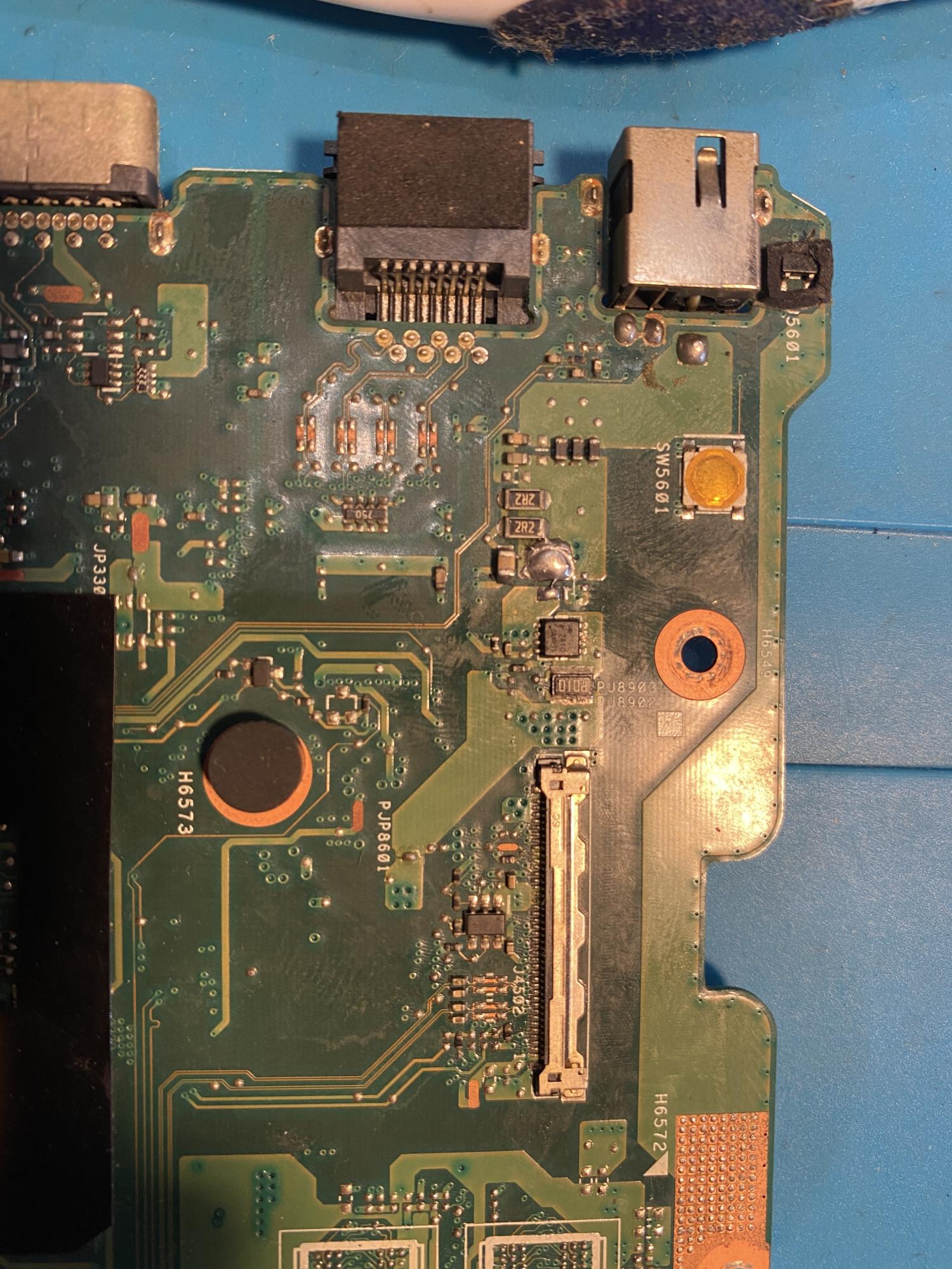

                              I am battling massively to trace the circuits. Is there any trick to this? It disappears through the board and I lose it. These are the only markings I can find on the board, not sure where else to look for schematics.
                              • mon2
                                • Dec 2019
                                • 14680
                                My apologies. You posted a BV file in your first post. That file is also in my paid database but it does not appear to be accurate. My version of this file does not offer the 2 mosfets you are showing in your posted pic.
                                Have a .fz file with the same version of the board and that appears to be accurate.
                                Noting this, if you select the pin #4 of the same mosfets, you can pin point the charger IC and its function.

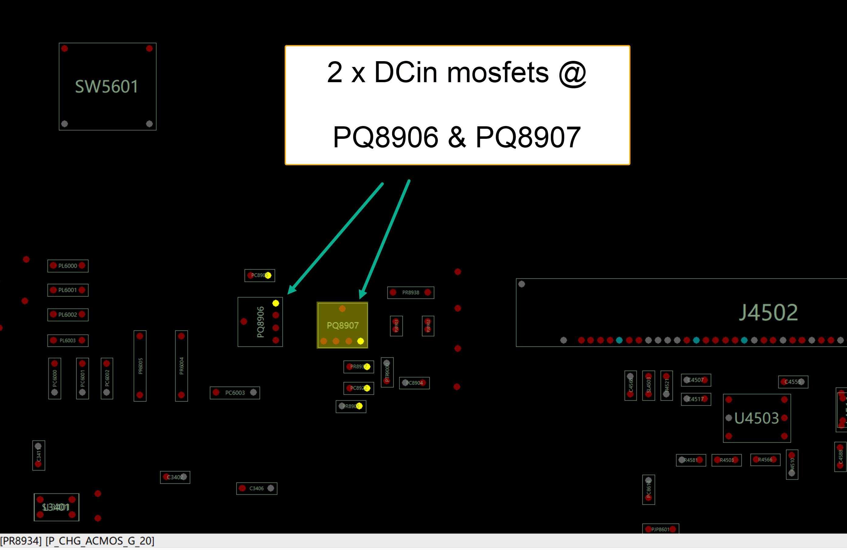

                                • mon2
                                  • Dec 2019
                                  • 14680
                                  See attached. These are the 2 x DCin mosfets that need to be investigated.

                                    ok i can confirm that Mosfet number 2 in my picture has its gate connected to the pin you illustrated on the charger IC.
                                    As far as the two DC mosfets you mentioned. those seem to be the original ones we looked at in the first post. The one that was missing that previous technician bypassed was PQ8906 which i replaced from a donor board.
                                    • roxboy1984
                                      • Jan 2022
                                      • 177
                                      • South Africa
                                      Ok so i tested PQ8907 and this is what i got.
                                      Source (1-2-3) and drain (5-6-7-8) = 5.6 mega Ohm (0.51V on diode mode)
                                      Source (1-2-3) and gate (4) = 5.1 mega Ohm
                                      Gate (4) and drain (5-6-7-8) = 2.1 Mega Ohm
                                      • mon2
                                        • Dec 2019
                                        • 14680
                                        These are good mosfet resistance readings. Will catch up once at the office.
