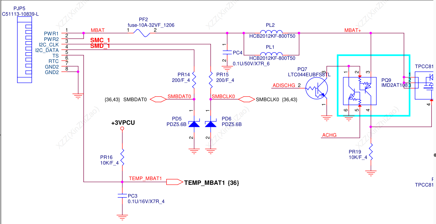

    Check the voltage to ground on each leg of fuse @ PF2.
      Click image for larger version  Name:	battery_fuse.png Views:	0 Size:	125.0 KB ID:	3335267
      Thanks for commenting
      On both sides of the fuse there is 14.6V
      As I mentioned above, it also does not work with the 20V charger, with battery and without battery.​

                  Thanks for the help. I have discovered the problem. Pin 5 (TEMP_MBAT1) of the battery connector has 10 ohm resistance to ground (with battery disconnected). That goes to pin 70 of the EC, and that's where what is practically a short comes from. There should be 3V coming from PR16 connected to +3VPCU.
                  Conclusion: for some reason, when connecting the new battery, leg 70 of the EC IT8886HE was shorted.
                  The question is, has it happened to anyone? I suspect the battery since it was the cheapest, a "probatery" brand, that is, it was not original but generic.​

                      Remove PC3 off the board and measure pin 70 again.
                        Obviously I already did it, I have 20 years of experience. Basically my question is about the experience with generic batteries and if anyone has had a similar problem with these laptop models. By injecting 1V with current limited to 1 ampere, it heats the EC. It was clearly damaged when connecting the new battery.

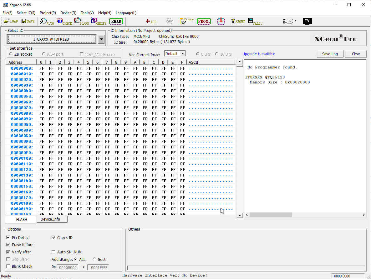

                                    Hmmm. See attached. I believe the T56 can program these.
                                    You will need the T56 and this adapter (ITE chip needs to be soldered - yuch. Ghetto but cheap. Should be a zif socket).
                                    ADP Adapter Can Only Work on XGecu T56 Programmer, ITE8XXX, TQFP128, 100% Original, Free Shipping - AliExpress 7
                                    reference:
                                    Need help, wiring/reading IT8XXXX -it8987 - XGecu T56 使用问题解答 - XGecu Programmer Forums - Powered by Discuz!
                                    Click image for larger version  Name:	T56_screen.png Views:	0 Size:	57.7 KB ID:	3337185

                                      Thank you so much!. I'm going to try to get it in my country. I have the TL-866II PLUS, also from the Xgecu company, but they don't have any of the ITE family in the library.
                                      • mon2
                                        • Dec 2019
                                        • 14751
                                        The linked adapter does not appear to be available at that site. Contact the mfr to confirm. They may have a zif version by now. Also, from where will you get the EC dump? There is one on this website which may work for you.
