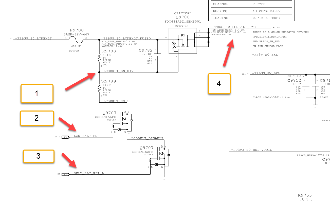

                Re: Macbook pro a1286 no backlight
                See attached. Post the voltage readings for each.
                The mosfet @ PQ9706 = P-channel mosfet. This needs to be ON for the backlight to work.
                For the P-channel mosfet to work, the GATE voltage needs to be LOWER than the voltage it is passing through source / drain pins.
                For the GATE to be lower, the resistor based voltage divider on the gate pin must be present.
                That is, BOTH mosfets inside of Q9707 must be ON. Only if BOTH of these mosfets are ON, then the resistor based voltage divider will be created - that is the bottom resistor will mate to ground.
                Then if you review a calculator (online), the 12 volts will enter the TOP resistor and the lower resistor will pull down this voltage and in the end, the GATE will be a lower voltage to enable the top mosfet.
                So, we need to know the gate voltage of each Q9707 mosfets to see if they are being enabled or not.
                Update - @ 850 ohms to ground on fuse pin # 2 - someone is leaking. Post your voltage measurements.

                  Voltage at Q9707
                  #1 0.5V
                  #2 3.35V
                  #3 10.89V
                  #4 0.4V
                  #5 1.7V
                  #6 0.6V
                  Please guide.

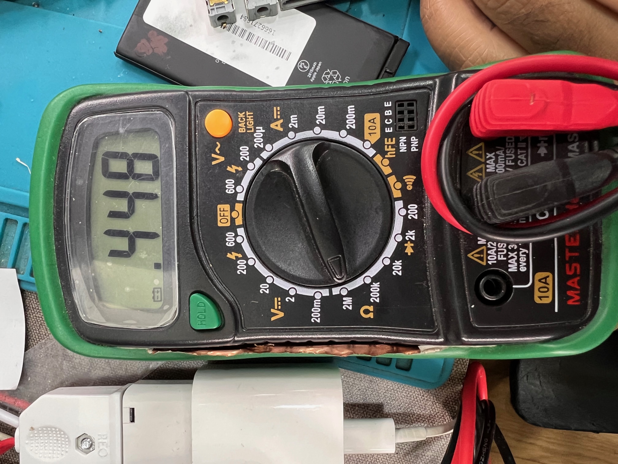

                      Voltage on Fuse F9700 (Fuse was Changed)
                      Pin#1 12.56V
                      Pin #2 12.56V
                      Resistance from Fuse to Pin#3 Q9707 is .448.
                      We had to move up the meter to 2M from 2k as it was showing 1 as reading. { Picture Attached}
                      • mon2
                        • Dec 2019
                        • 14415
                        Resistance to pin #3 of the mosfet is fine.
                        With a piece of wire, connect pin # 3 of the mosfet to ground. This bypass will act the same as the 2 x mosfets when they are enabled. That is, the lower resistor will be mated with ground and then the top mosfet should have a lower voltage at the gate to enable the backlight.
                        It is a quick test method.

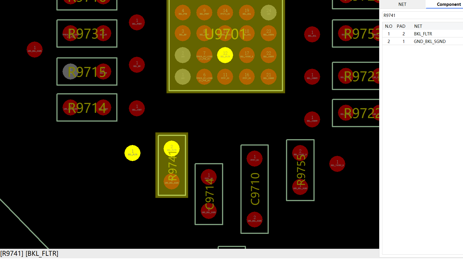

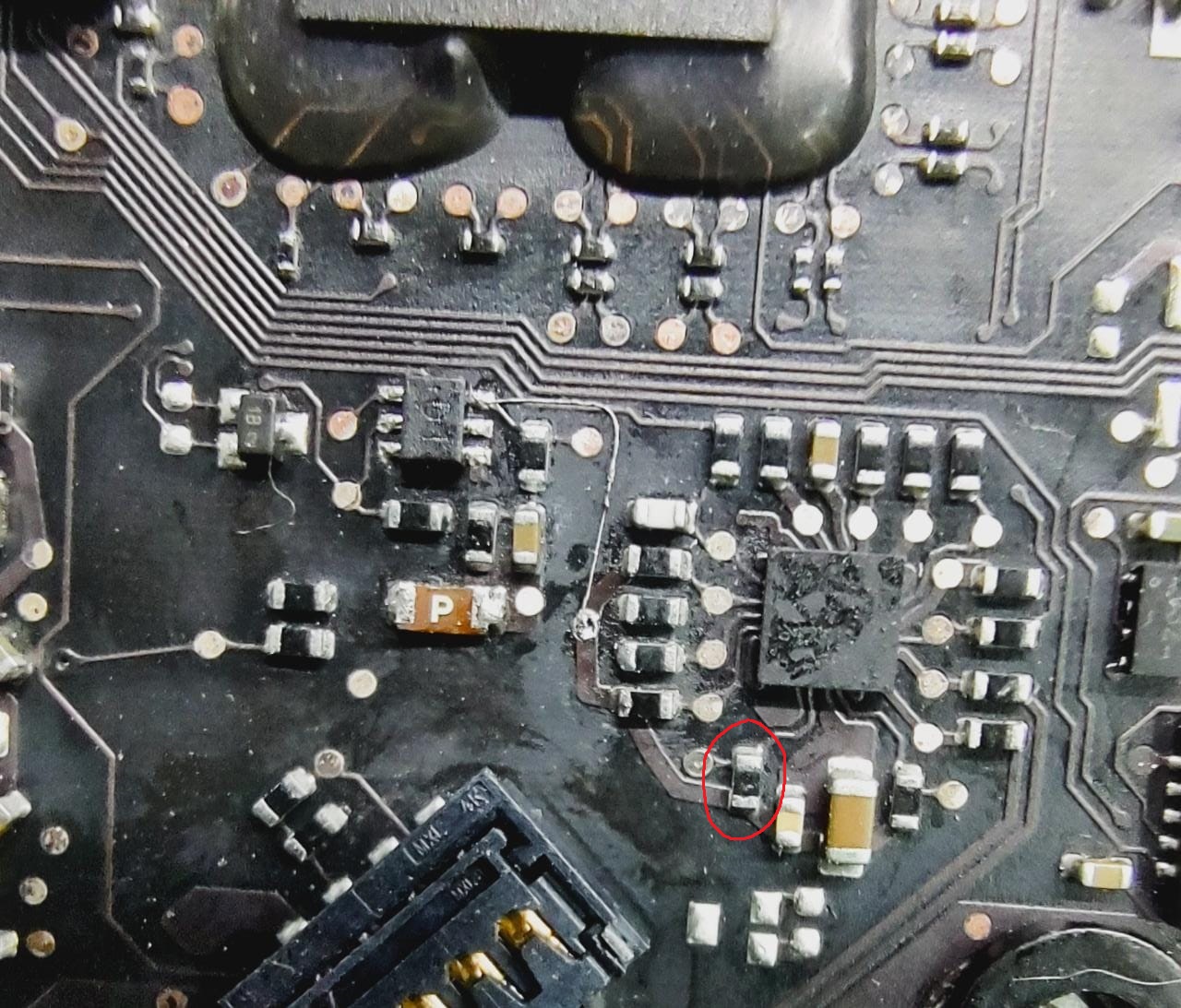

                                • Instafixx
                                  • Jul 2022
                                  • 374
                                  • India
                                  Originally posted by dellxps15
                                  measure value of that resistor .... looks like it's burned.
                                  Hello Resistor R9741 as marked in the Picture
                                  Voltages
                                  #1 0V
                                  #2 0.01V
                                  Resistance (With No Power and Meter Se at 2K)
                                  #1 0 ohms
                                  #2 .504 i.e 505 ohms

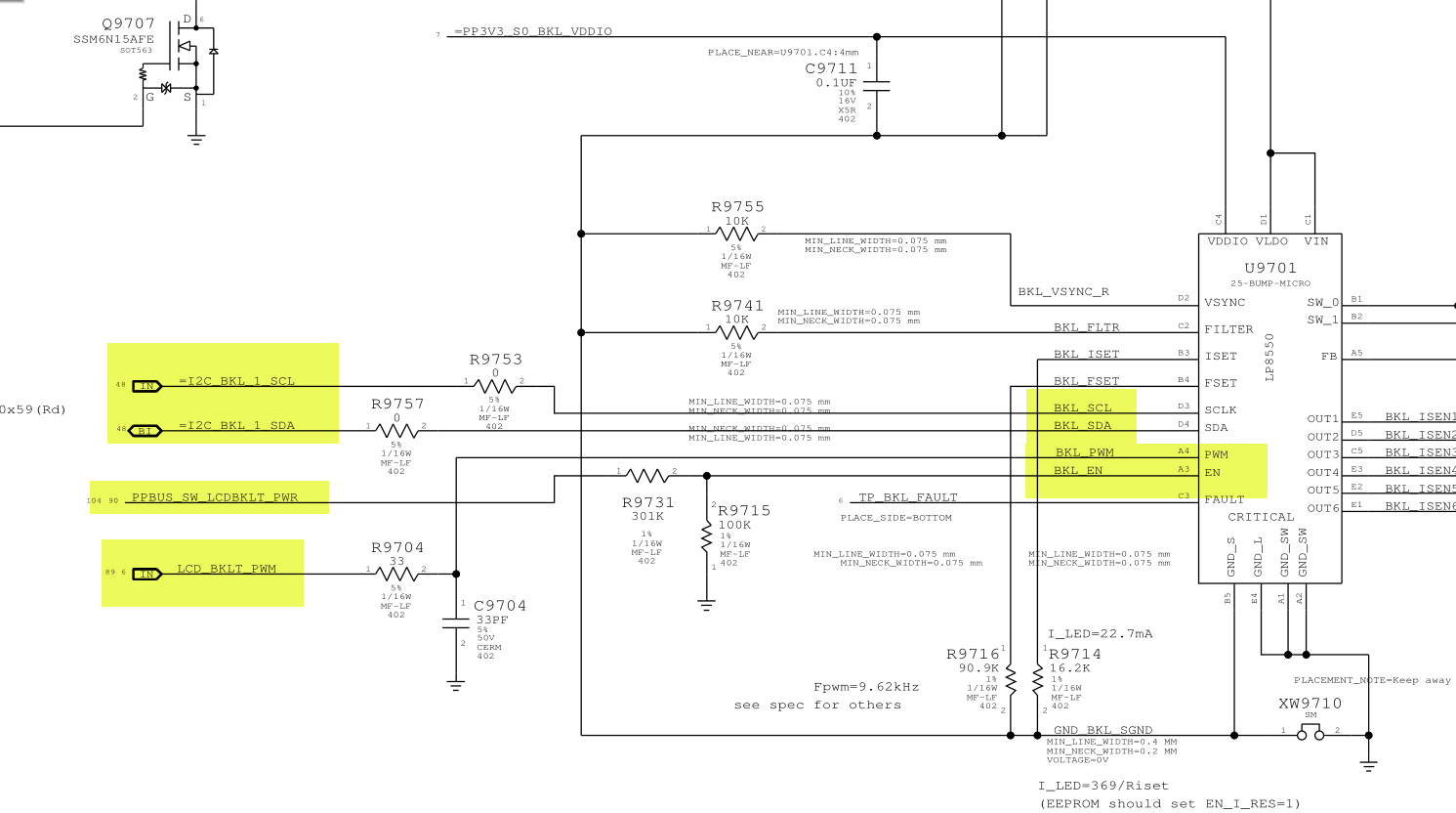

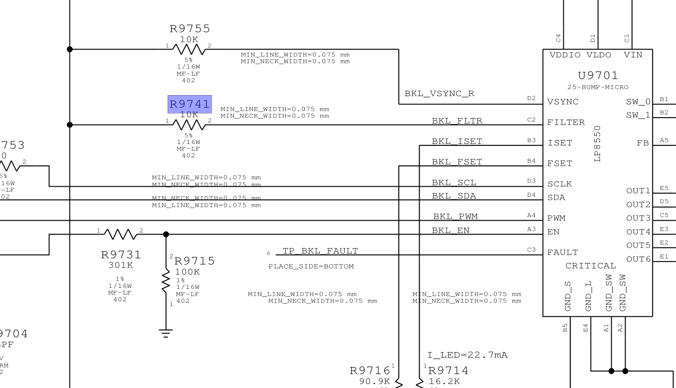

                                    R9741 = 10k in the schematic. From the LP8550 datasheet this value may not be critical to the operation but the logic board does not match the schematic value.
                                    Now that the top mosfet is passing through the required voltage, the LP8550 will function provided there are signals on:
                                    I2C_BKL_1_SCL
                                    I2C_BKL_1_SDA
                                    PPBUS_SW_LCDBKLT_PWR
                                    LCD_BKLT_PWM
                                    Measure the voltage of each and post the readings.
                                    • dellxps15
                                      • Feb 2014
                                      • 1591
                                      • italy
                                      i mean resistor value from pin 1 to pin 2 (to see if its just looking burned or it is burned actually.
                                      • mon2
                                        • Dec 2019
                                        • 14415
                                        Attached.
