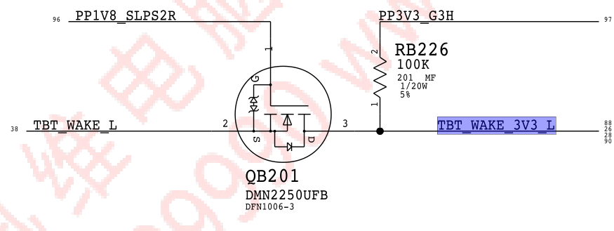

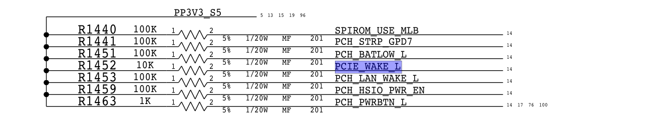

        Check voltage level of PCIE_WAKE_L.
        Most likely this will be an open-drain pin and is active LOW to WAKE up the host CPU. Respectively, the line will be high impedance for the 'high' state which demands that R1452 be present.
        Check that R1452 is attached onto the PCIE_WAKE_L line.

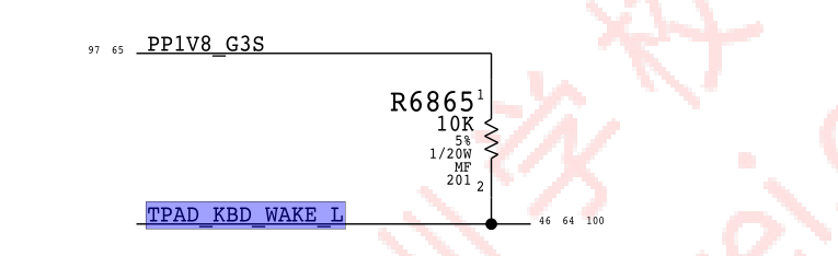

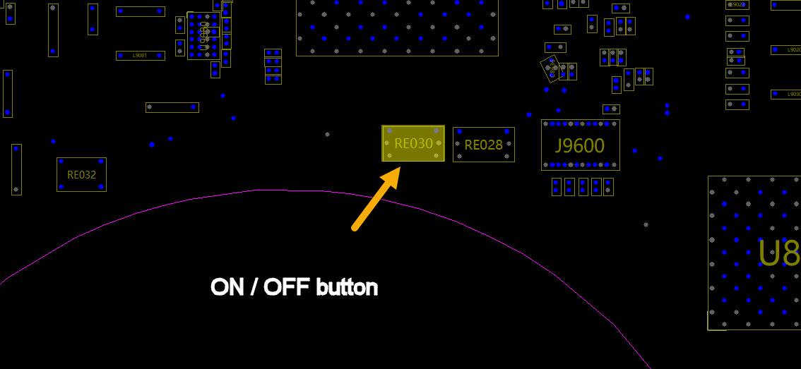

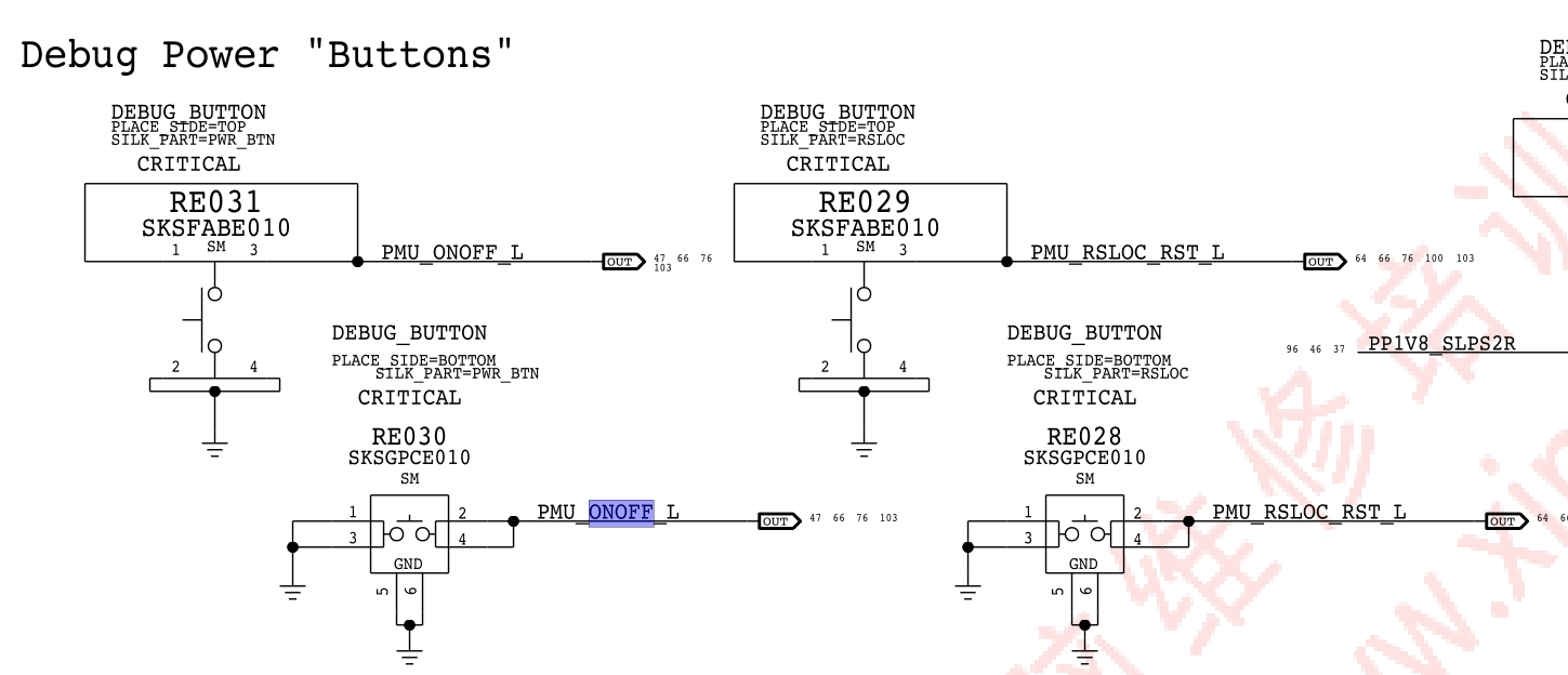

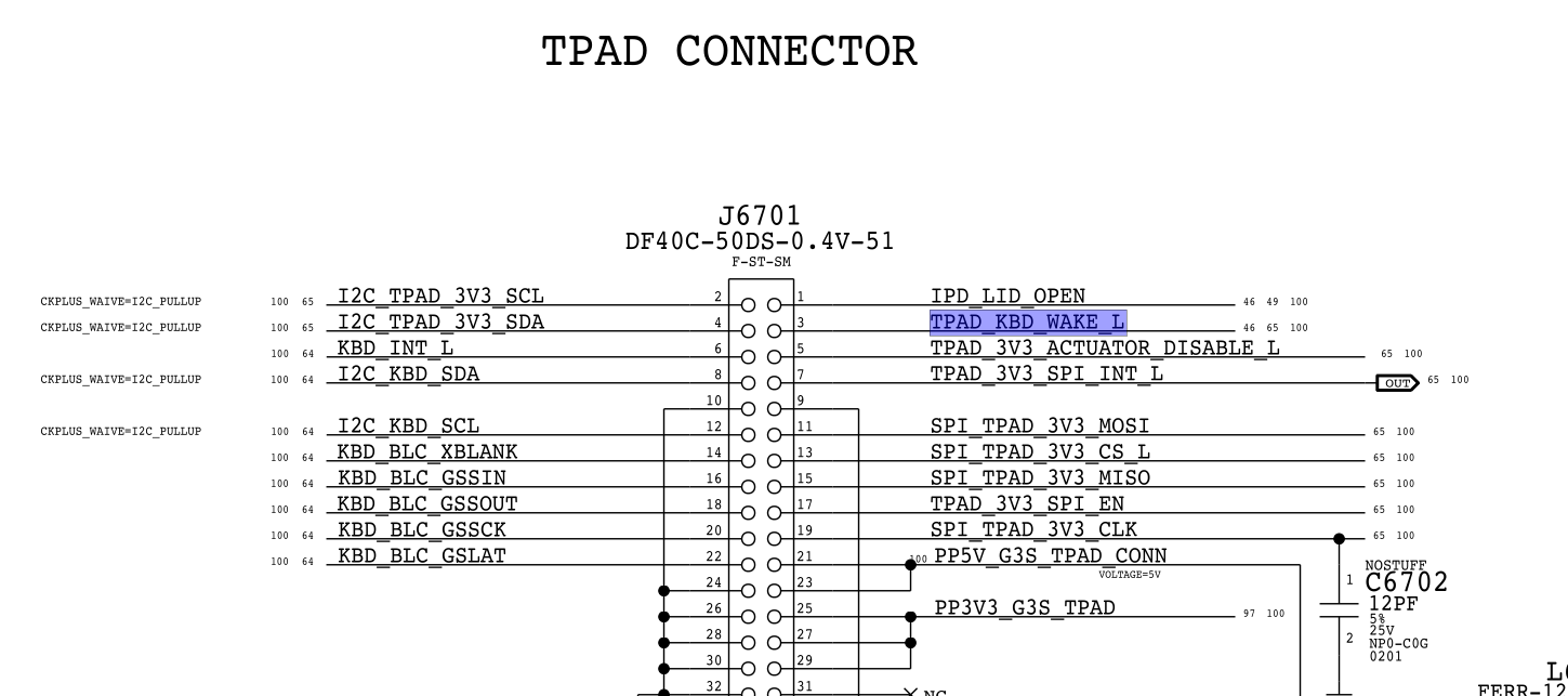

        Also check on the voltage on TPAD_KBD_WAKE_L. Consider to remove the trackpad connector to the logic board and test again. You should be able to turn on the logic board with pushbutton @ RE030 (attached).
        There are numerous widgets on the logic board that can WAKE up the host. Search for and investigate each "WAKE_L" marked lines to confirm they are ok.
        In the schematic, see:
        TBT_WAKE_L -> QB201 mosfet (level shifter) -> TBT_WAKE_3V3_L --> voltage reading ?
        Suspecting that one of these WAKE_L marked lines is parked @ logic low.
        My bet is on the trackpad line. Faced numerous faults with the trackpads in recent repairs from small spills, etc.
