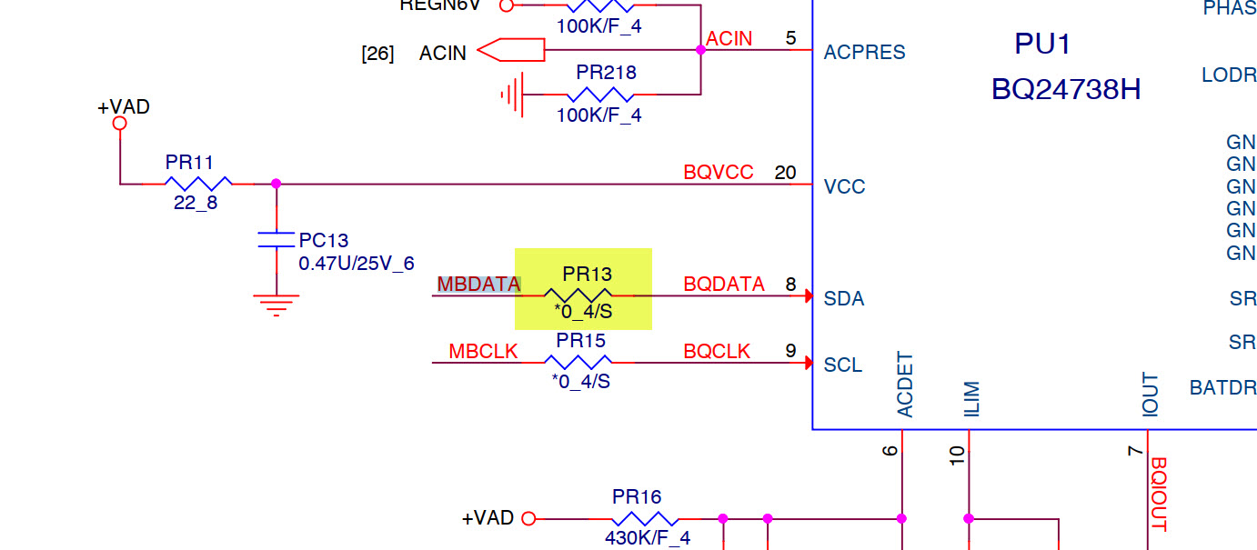

      #62
      Re: Hp 15-P104NI Laptop switches off with new Battery when AC unplugged!! Please help
      Resistance with PD1 installed is ok. There is no short condition with PD1 installed. Sometimes, when a transient occurs, devices like PD1 and PD2 will get killed to prevent further damage downstream on the signal pins. This event causes a short circuit condition on the same signal line.
      It appears that you may have a broken trace from the pull-up resistor which is showing 3v3 on the signal trace but this same voltage does not appear at the SMBUS DATA pin on the battery connector.
      Review that one side of the R182 is connected directly to +3v3. That is NOT the side of interest. It is the other side of R182 we need to mate with the pin #3 of the battery connector or even at PD1 since they are all supposed to be on the same trace.
      Let me review that this is correct and then will suggest to use a piece of wire to bridge what may be a broken trace between the 2 points of interest.

        #63
        Also, check the voltage @ PR13 = MBDATA. This resistor should also be @ 3v3 (same voltage as on R182).
        Suspecting that you have a broken PCB trace.

              #66
              If I probe PR13 I get 0.47V.
              • mon2
                • Dec 2019
                • 14758
                #67
                Same incorrect voltage.

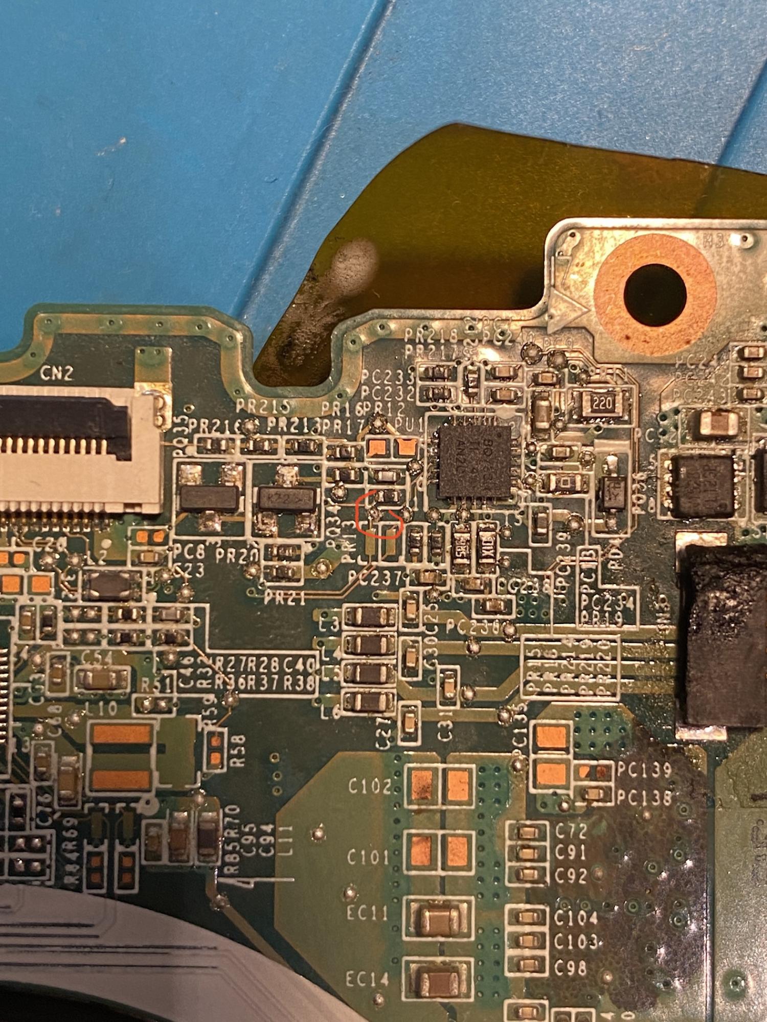

                  #68
                  Remove all power. Check the resistance from PR13 to pin #3 of the battery connector.
                  Just to confirm circled in red on the pic im probing the correct point. but from here to pin 3 i get 0.328 Kilo Ohms

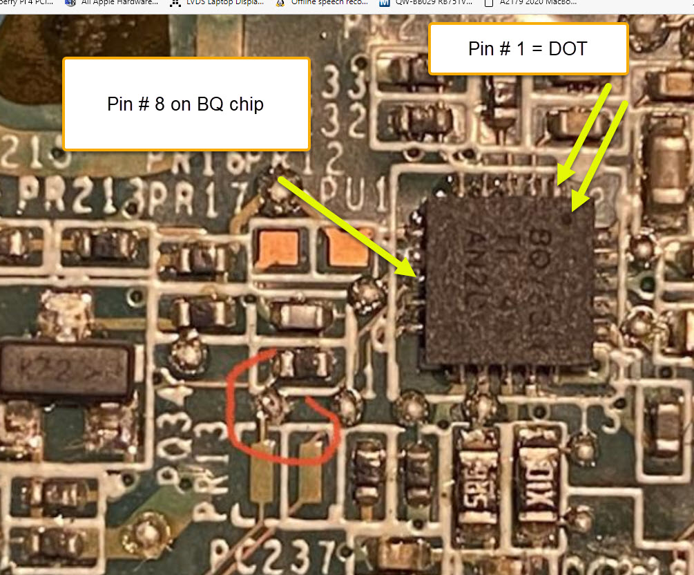

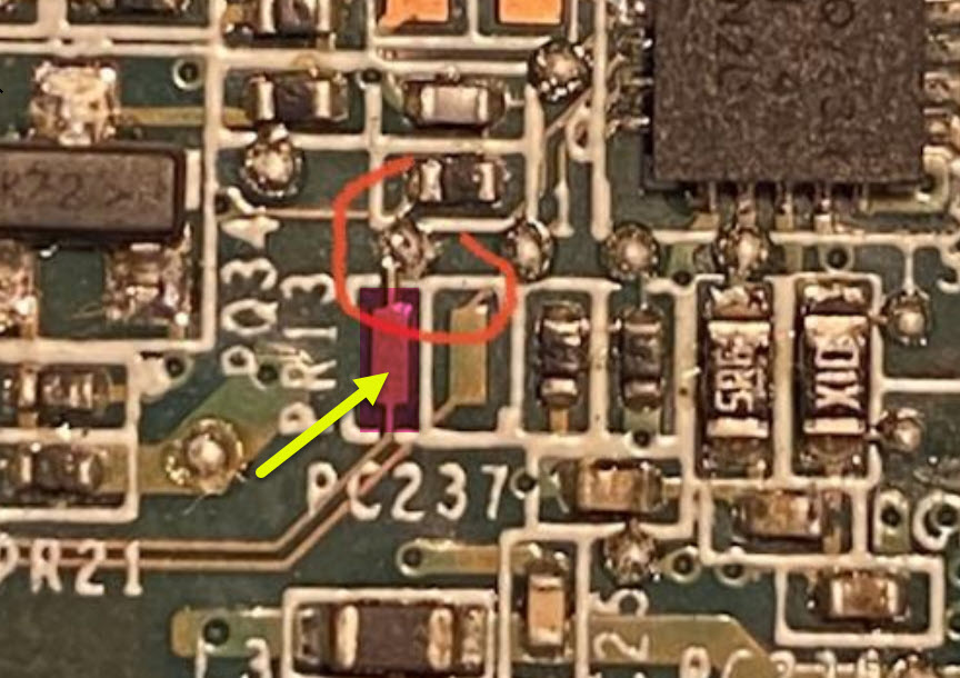

                    #69
                    See attached. PR13 is the large PCB pad that is acting like a jumper. This is MBDATA signal that travels also to the battery connector, pin # 3.
                    Remove all power. Check the resistance from this large PCB pad to pin #3 on the battery connector. What is the resistance ?
                    Next, repeat but from this pad to pin #8 on the nearby charger IC ('BQ' part).
                    What is the resistance ? For each measurement, the resistance should be ~0 ohms.

                        #71
                        Perhaps - place one meter probe there and the other onto pin # 8 of the charger IC to confirm. This is important to probe and check the proper pad / pins. No power during these tests. If the pad is truly correct, the resistance to the BQ charger IC should be 0 ohms.
                        Then check again to the battery connector, pin # 3.
                        Just attached a location for pin #8 on the BQ chip.
                        Each side of this QFN (quad flat pack package) has 5 pins, so locate the 8th pin as per attachment.

                          #72
                          ok so charger IC pin 8 to pin 3 i get 0.328 Kilo ohms.
                          that little ball of solder to pin 8 is 0 ohms.

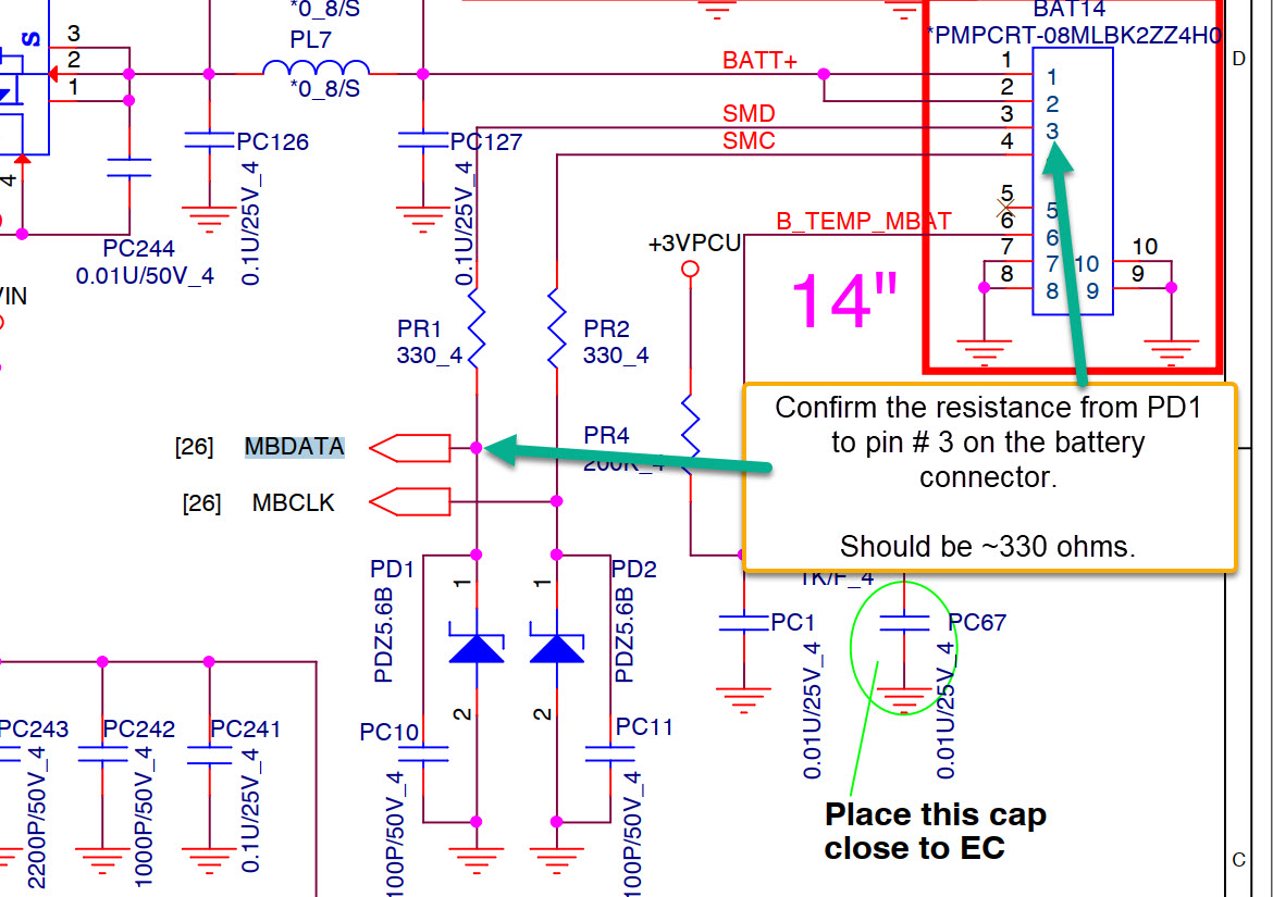

                            #73
                            Ok. One more check - the resistance that you are measuring must be the 330 ohms resistor @ PR1. Double-check as per attachment.
                            From PD1 to pin # 3 on the same battery connector - still ~ 0.328kohms = 328 ohms ?

                              #74
                              In post #57 you mentioned
                              resistance from R182 to pin 3 i get 0.320 Mega Ohms
                              Did you mean 0.320 kohms = 320 ohms ? That is ok due to resistor PR1 (330 ohms). Can you confirm this again ?
                              Also, if you see a voltage on BOTH sides of R182 then this voltage has to appear at PR13 pad = pin # 8 on the charger IC = pin # 3 on the battery connector.
                              Check again.

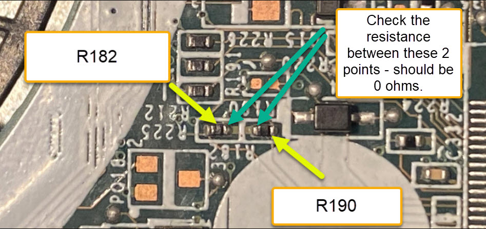

                                        #79
                                        See attached. Confirm the resistance between the 2 green arrows = 0 ohms.
                                        This is the pull-up voltage to 3v3.
                                        The MBDATA is on the LEFT side of R182. We need to be sure of this detail.

                                          #80
                                          Correct. it is 0 ohms between those points.
