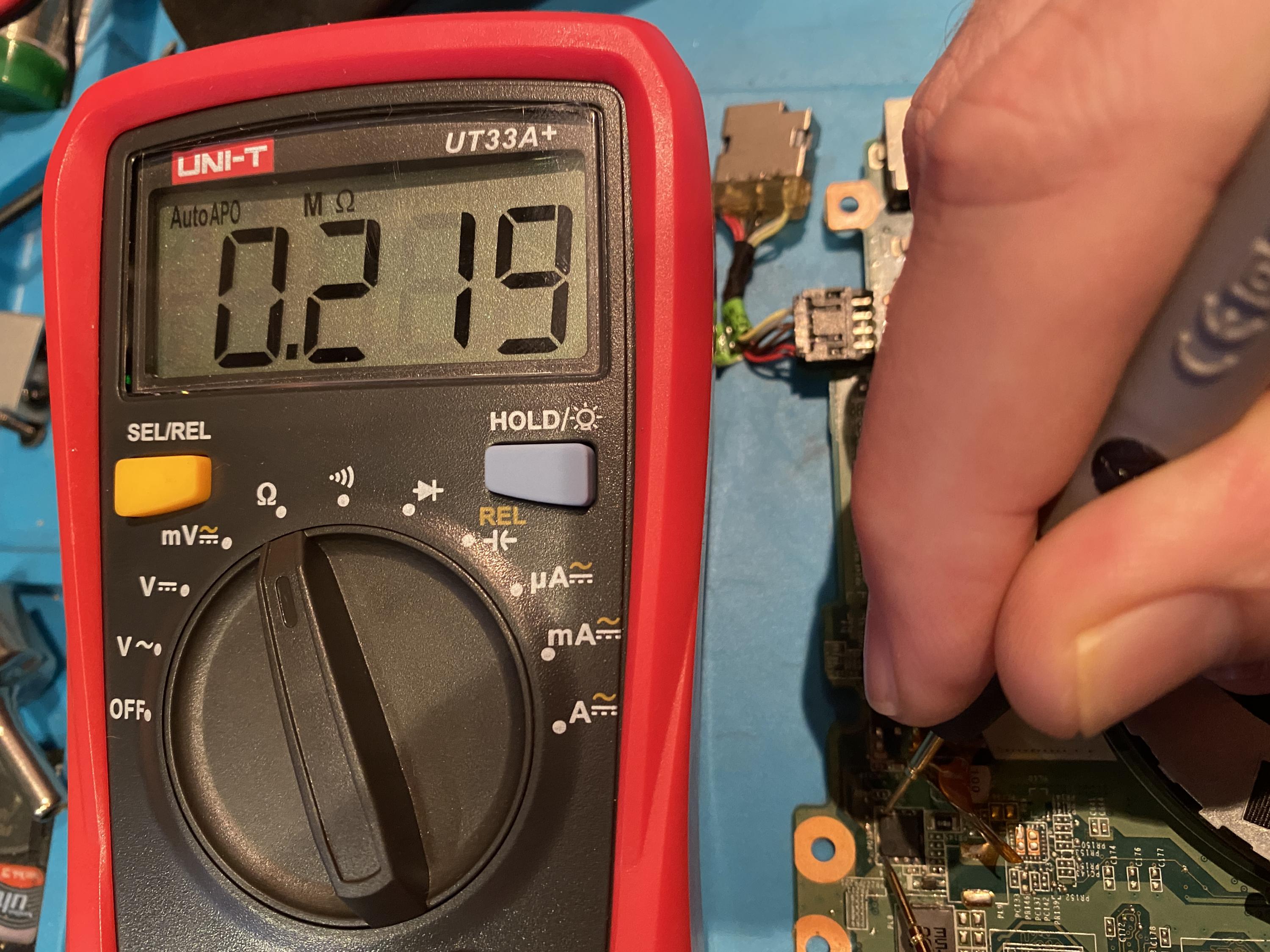

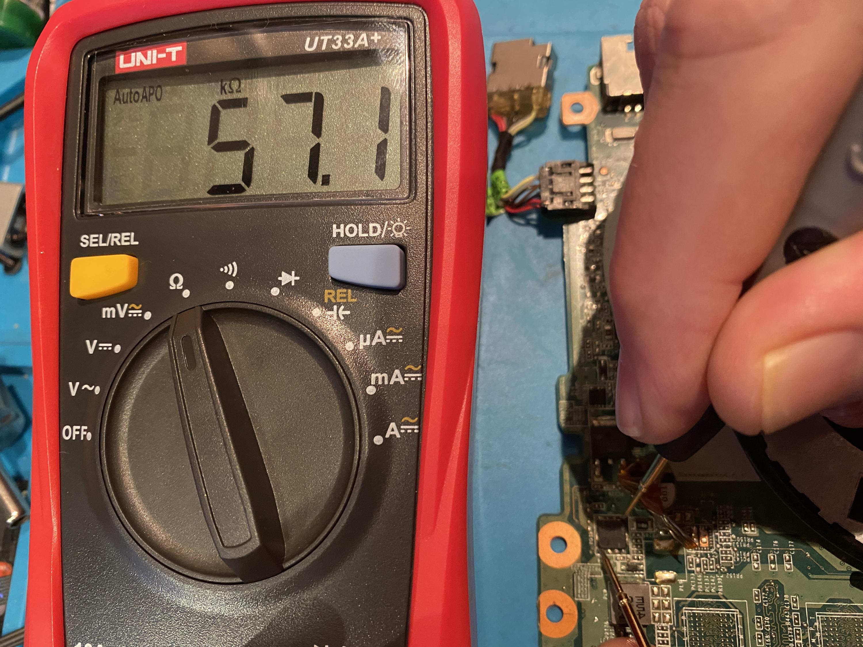

                      #30
                      Re: Hp 15-P104NI Laptop switches off with new Battery when AC unplugged!! Please help
                      Originally posted by mon2
                      This is a very low resistance for a mosfet. It is defective and must be replaced.
                      Ok, so im not sure what im doing wrong here but as you can see in the attached pics if i measure from source to drain i get different readings depending on where i probe. taking the below readings into account is it still too low? or do you think this mosfet is defective?
                      • mon2
                        • Dec 2019
                        • 14752
                        #31
                        Review the mosfet test methods here:
                        https://www.homemade-circuits.com/ho...using-digital/
                        You will use the diode mode of your multimeter. One one orientation of the probes, the meter should conduct. Block when the probes are reversed.
                        Post your measurements.
                        The diode mode is 2 clicks to the right on your meter face.
