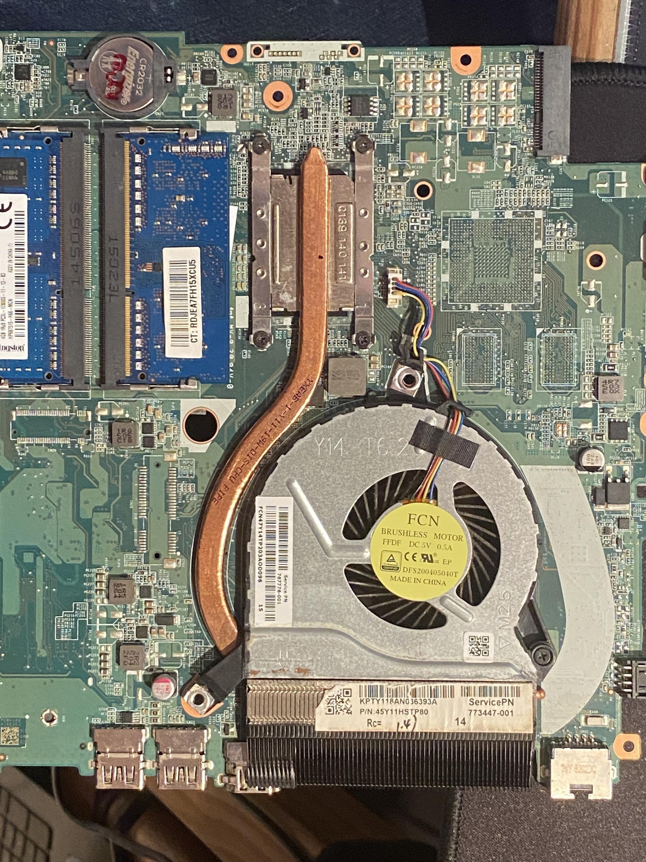

        Re: Hp 15-P104NI Laptop switches off with new Battery when AC unplugged!! Please help

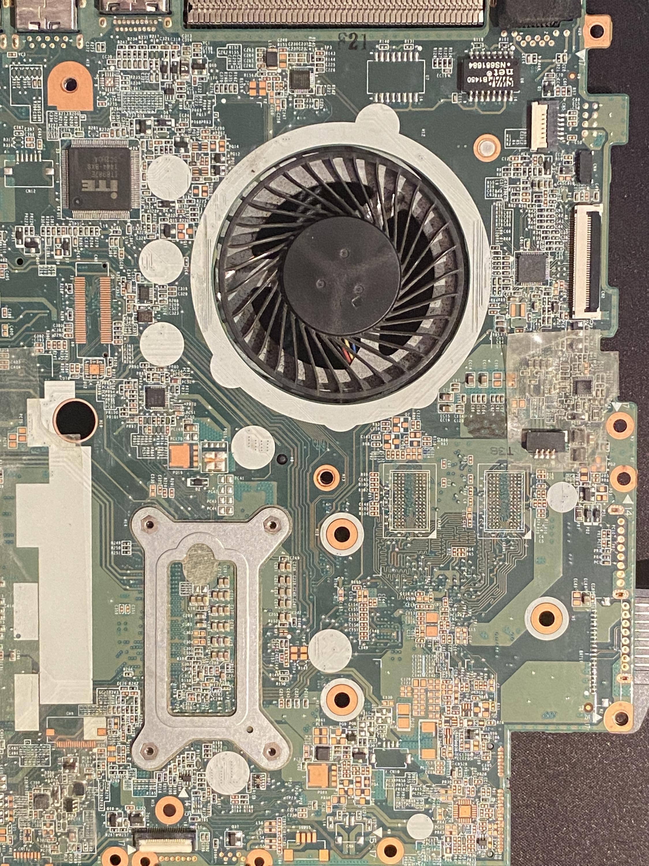

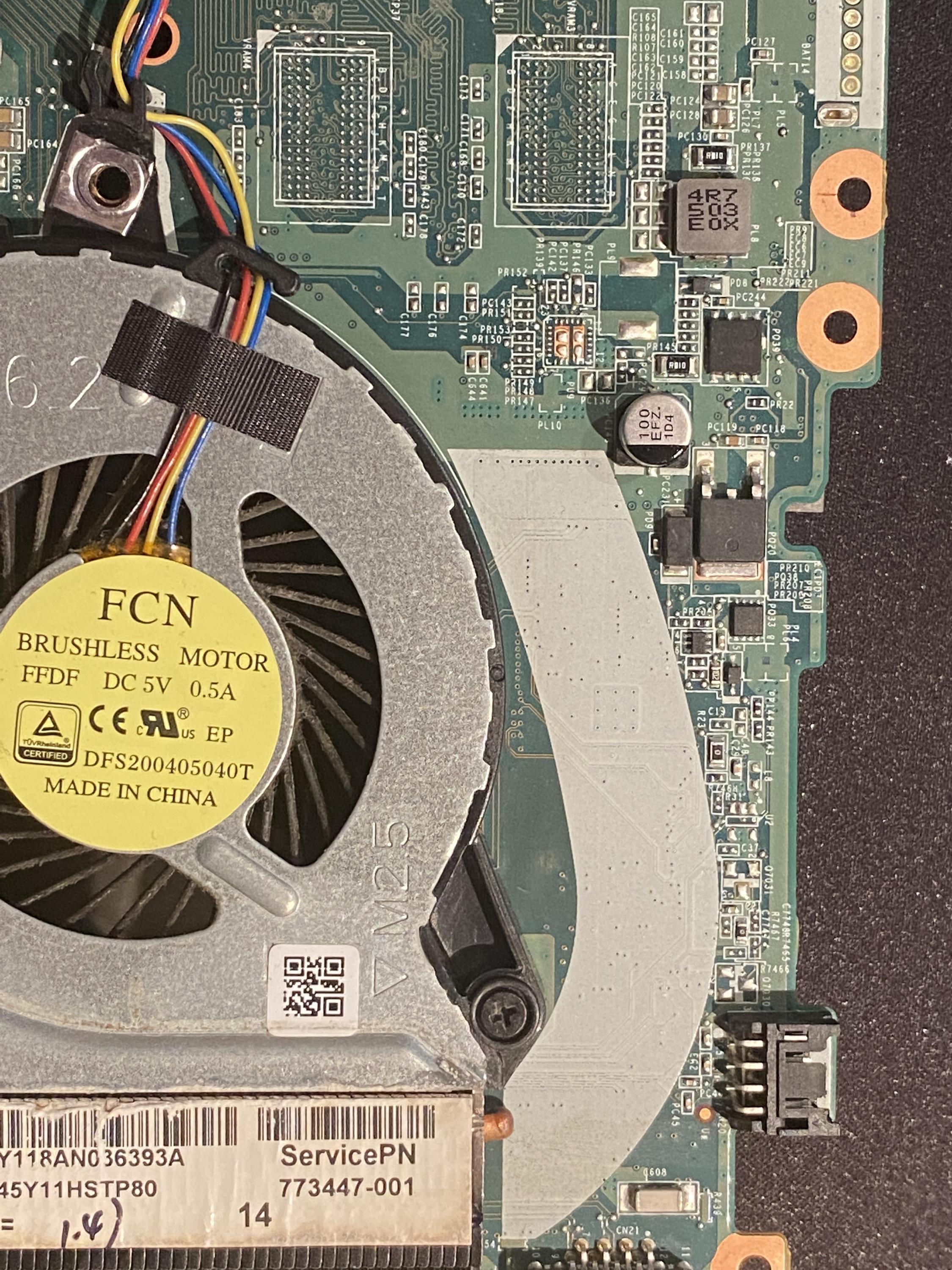

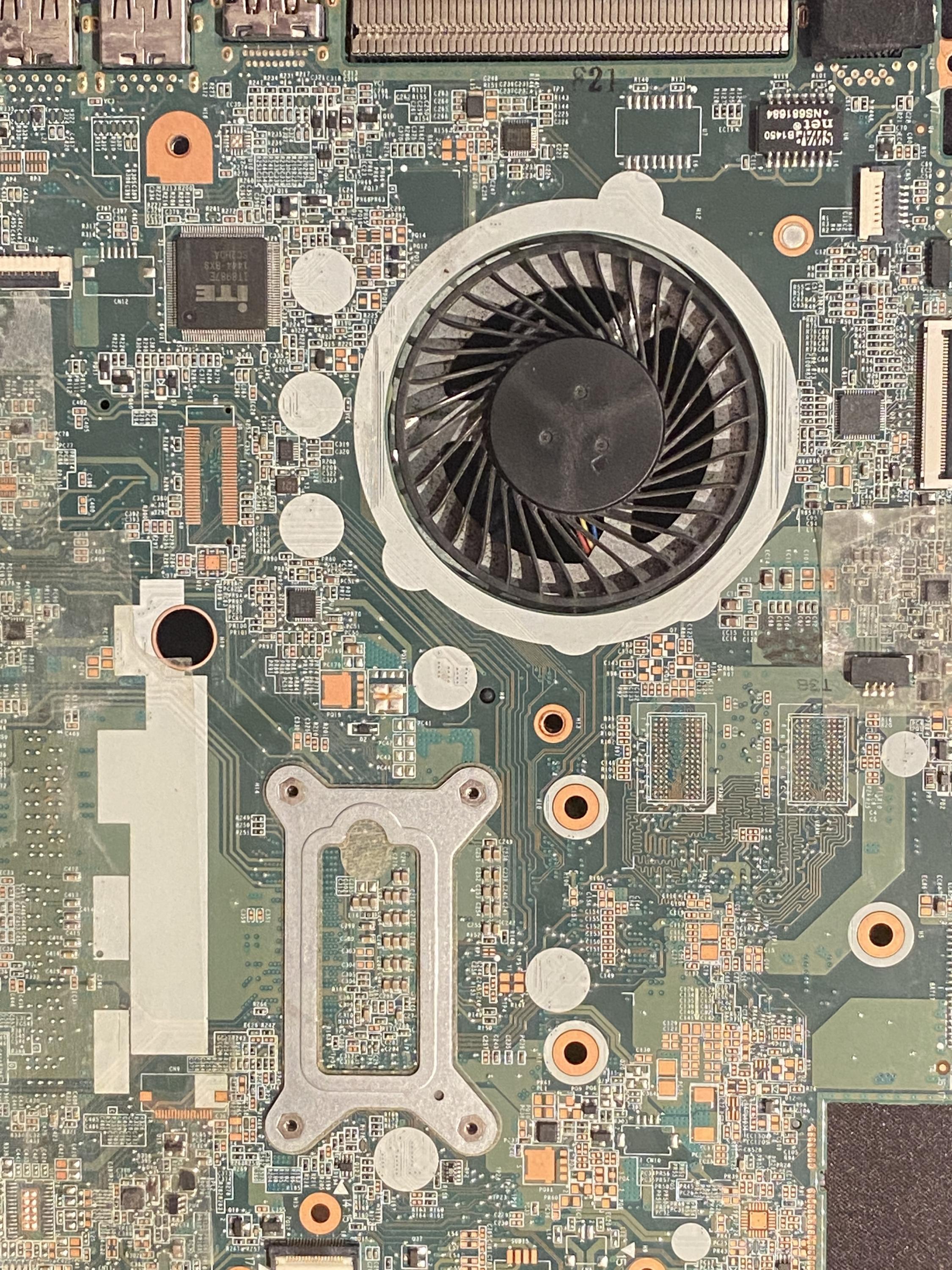

        Hi, So ive taken a few photos of my board. I dont have a microscope yet so im battling to read the info on the chips. please could you point me in the right direction of what i need to do next. I have also attached a Boardview and Schematic if that helps also.

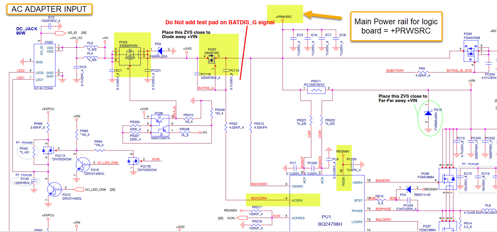

          Schematic helps.
          See attached for the power path.
          Remove all power. Meter in resistance mode.
          Locate mosfet PQ20 on your logic board.
          Then (with NO POWER / NO BATTERY), check the resistance of this mosfet.
          Datasheet for PQ20 = QM3016D is attached.
          Measure the resistance of:
          source & drain
          source & gate
          gate & drain
          Post each measurement. If the resistance is low, then this mosfet is defective. Often the 2nd mosfet in the power path chain gets damaged and raises faults like yours. As per Piernov's sticky above on charger ICs.

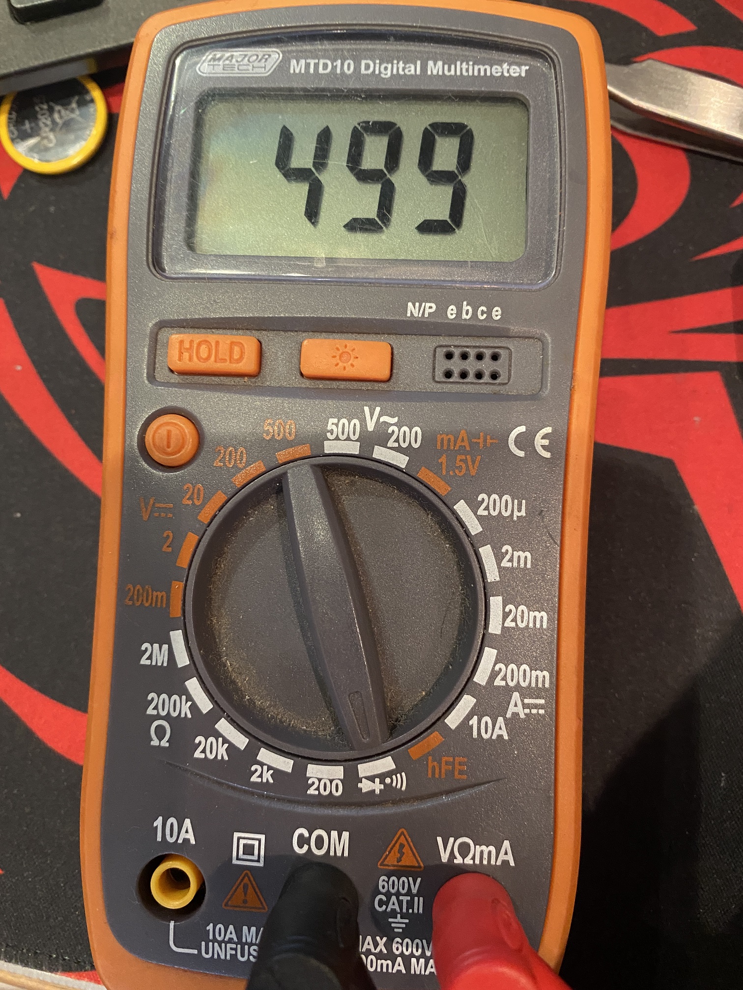

            Ok so I've tested the following and these are the results. but its behaving strangely. sometimes when I test between drain and source on diode mode I get continuity and sometimes it gives me 500 ohms. Does this mean its faulty?
            source & drain = 500 ohms (sometimes continuity)
            source & gate = no reading (1 on multimeter)
            gate & drain no reading (1 on multimeter)

              On some meters, the '1' means that the resistance on the component is HIGHER than the scale used by the test equipment. So you must switch to a higher scale to make a measurement.
              Either way, the 500 ohms is way too low. This part is defective. You will need to replace this mosfet. Either from a donor board or from a reliable vendor on Aliexpress / Digikey / Mouser / Arrow electronics.

                    Do check a few more items on the charger IC function.
                    Measure the voltage on the following points of PU1 IC:
                    ACDRV pin # 4 - this pin should be ~25 volts if all is well.
                    You may find this pin to be a lower voltage due to the defective PQ20 mosfet.
                    To confirm the operation of ACDRV, remove all power -> remove the resistor @ PR22 (~4k ohm resistor). After this resistor is removed, check the voltage of ACDRV again. It should allow for a voltage of ~25 volts.
                    If not, PU1 may be defective but confirm the voltage @ REGN (pin #16). Should be ~6 volts.
                    If you do not see the ~25 volts on ACDRV then you may need to order a replacement charger IC. They are all available on Aliexpress or donor boards.

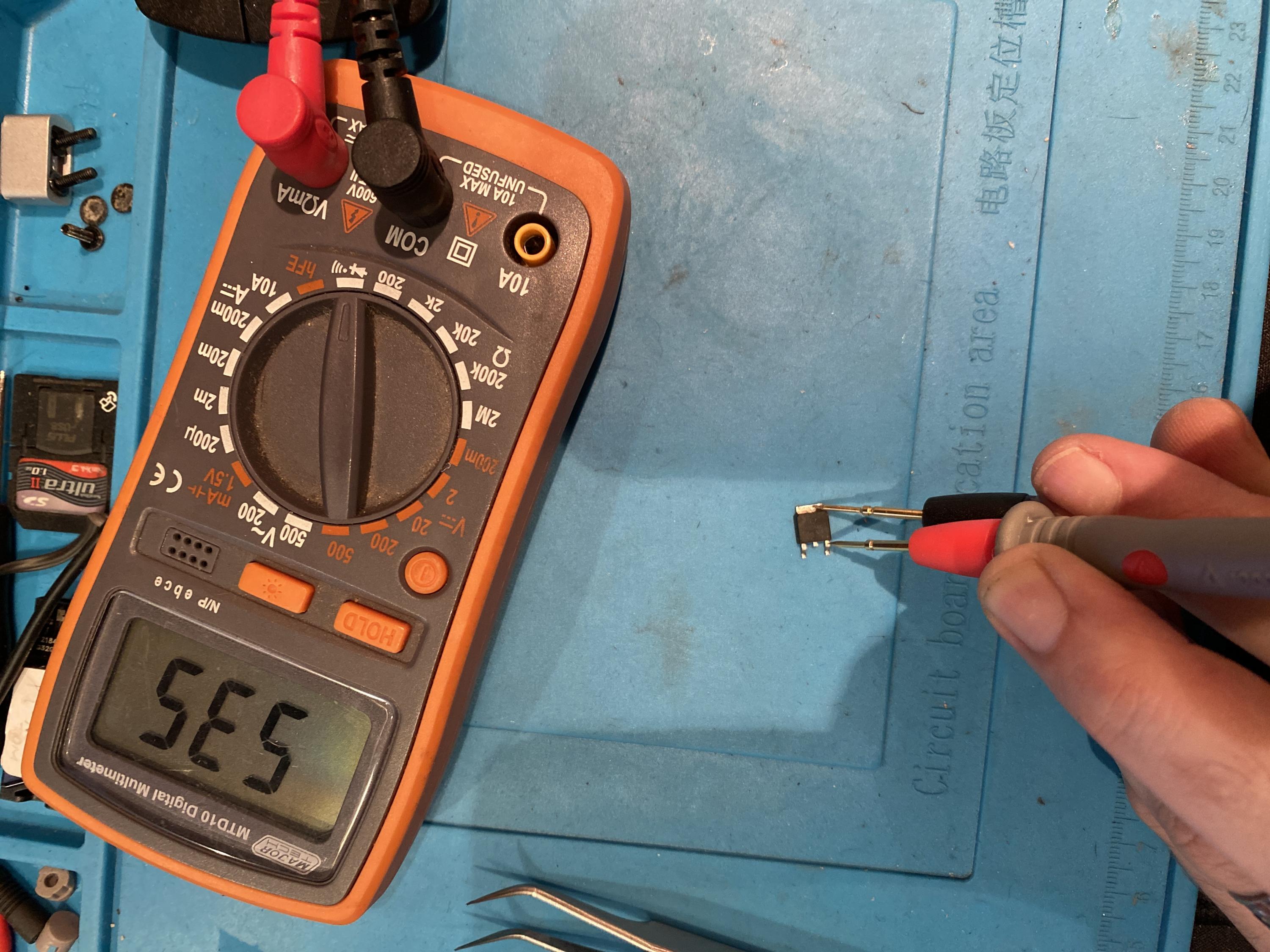

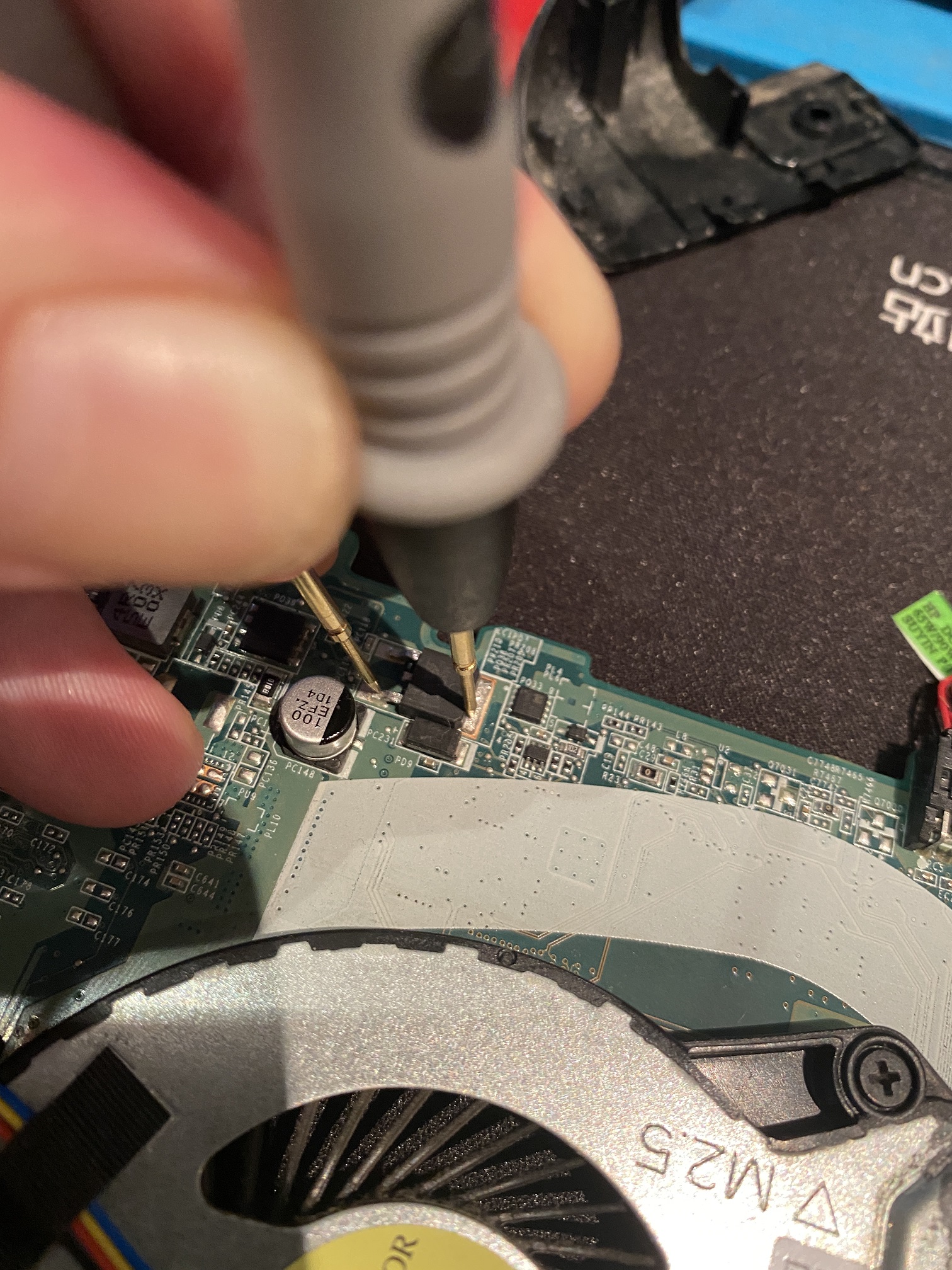

                        3) Next, on the mosfet check -> remove all power (no battery). Resistance mode on the meter. If you see a '1' then the resistance is too low.

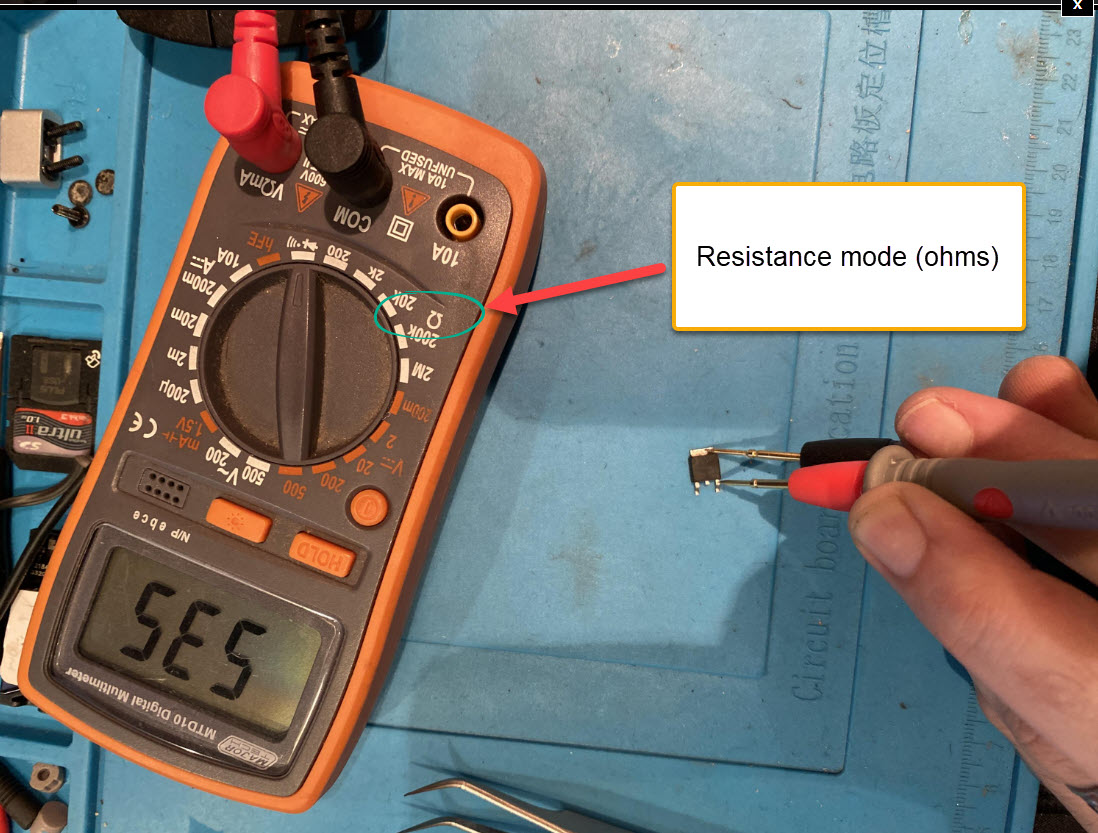

                        Can you post a picture of the front face of your meter ? Configure it to the resistance mode you plan to use.
                        Also, if possible, take a picture of the measurement that shows ~500 ohms so we can confirm.
                        Another suggestion is to apply flux onto this mosfet -> with enough hot air but low air pressure (so other parts do not go flying) -> remove this mosfet.
                        Allow for the mosfet to cool down -> then measure the part while it is out of the circuit for the best measurements.
                        Proceed with the earlier suggestion to show the meter face when you measure the ~500 ohms.

                              Ok so i did everything you said. the reading are in the reply above. i managed to get some flux today and i remove the mosfet and did a reading which is attached and then i swopped out the mosfet with the other one from the donor board and the issue still remains. any other ideas? thanks so much
                              • mon2
                                • Dec 2019
                                • 14763
                                See attached. Your posted pic is in DIODE mode.
                                Switch to resistance mode (with the omega greek symbol). Select 2M scale.
                                Then measure and post the readings again. If the resistance is too low, the mosfet is defective.

                                  Sorry excuse my ignorance i thought that Diode mode also measured the resistance.
                                  So i did as you said and measured on "2M" and the reading im getting for all points is "1" on the meter again.

                                    Short the 2 probes on the meter -> you should have ~0 ohms. Is this correct ?
                                    If yes and you are confident that the meter probes are touching the mosfet pins then the '1' means that the resistance being measured is HIGHER than the scale setting.
                                    Since 2M is the highest, this means the reading is higher than 2 Megaohms. This is a good reading and your mosfet is fine.

                                      Meter does go to 0 so its definitely working.
                                      Here are the values of the other Mosfets. im not sure if im missing any?
                                      PQ39
                                      Source and Drain = .265
                                      Source and gate = 1
                                      Gate and drain = 1
                                      PQ33
                                      Source and Drain = 1
                                      Source and gate = 1.501
                                      Gate and drain = 1
                                      PQ36
                                      Source and Drain = .317
                                      Source and gate = .101
                                      Gate and drain = .526
                                      PQ37 (I feel like this is Dodgy?) it even looks a little dodgy
                                      Source and Drain = 014
                                      Source and gate = .183
                                      Gate and drain = .201
