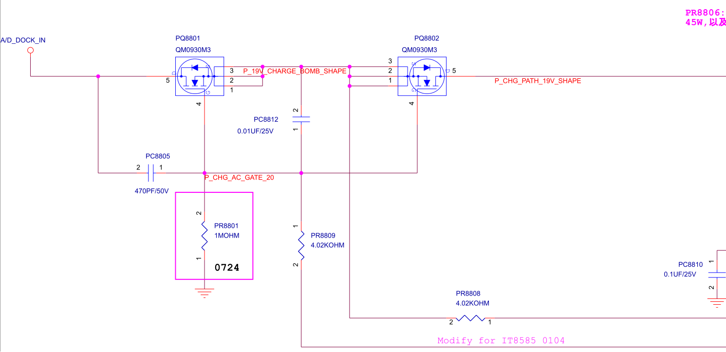

    Hello, I'm having issues with this Notebook, it doesn't power on.All voltages are present, 5v & 3v and no short at any coils.
    It consumes 56 mA when is connected to the power supply and when power button pressed drops to 2mA.
    I have already found a same problem that someone posted in YouTube but I don't understand the language.
    Can anyone translate it please or give me any suggestions?

        1) check the 3*ferrite bead inductors. Are they ok or burnt on your logic board?
        2) he appears to reflash the bios chip he shows in the video. Wait on this step and advice from others.
        update:
        see post # 5 for a clear bios dump (only if required but be sure to backup your original if you proceed)
        https://www.badcaps.net/forum/showth...ghlight=X555LD
        3) believe you are requesting the mosfet question in the post on youtube? Carefully measure the voltage of each pin on the 2*mosfets that follow the 3* inductors on the board.
        Interested in the voltage on:
        Source (1-2-3)
        Gate (4)
        Drain (5-6-7-8)
        Of each mosfet.
        3) what are top side markings of each mosfet?
        4) near these mosfets will be the charger IC. What are the top side markings of the charger IC?
