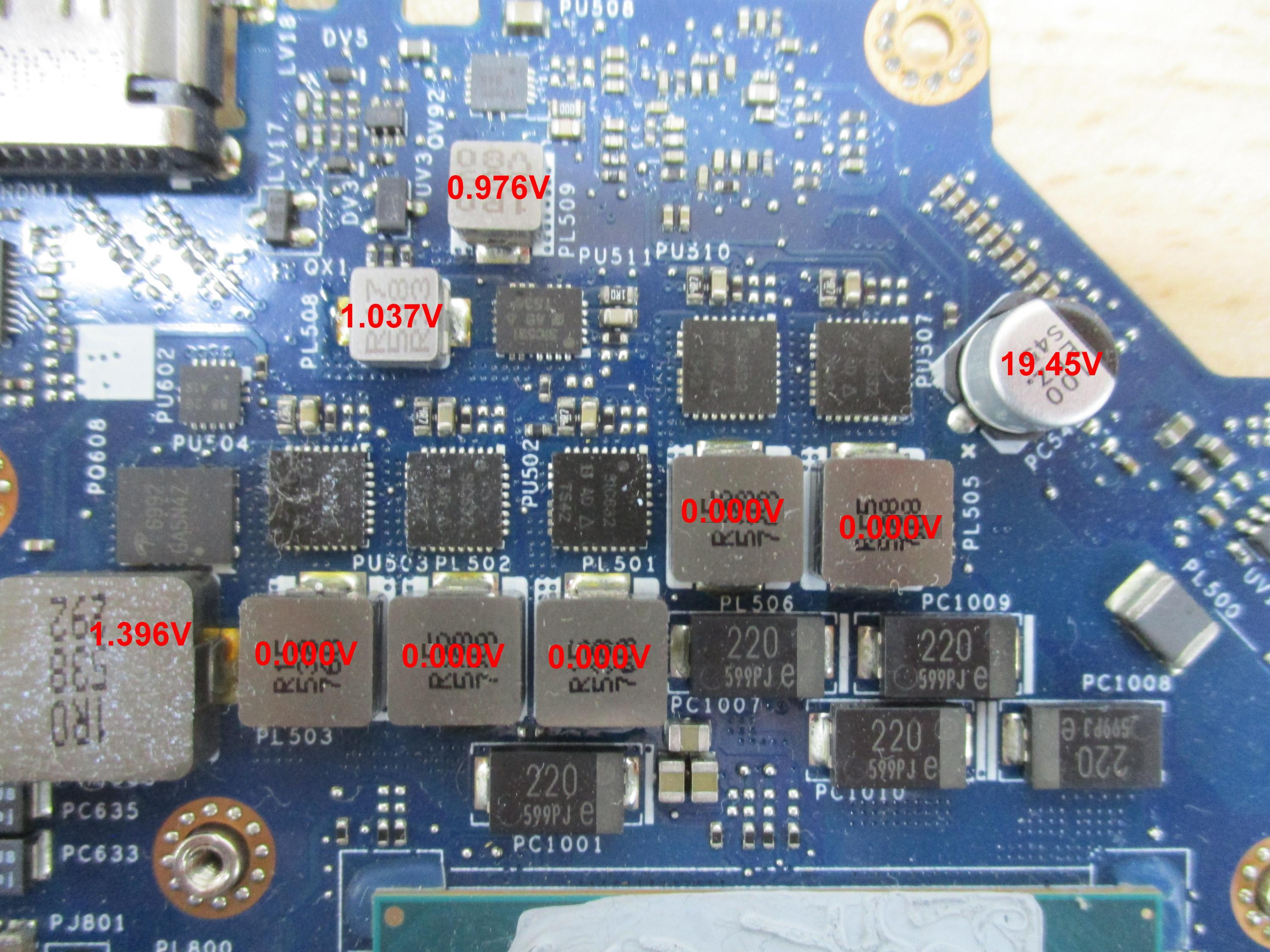

    Computer beeps 7 times, meaning "CPU failure". CPU stays cold, gets no power at all. No CPU short, resistance around 4Ohms. GPU voltage seems to be ok. Gate driver on top of coils are SIC632 but I have no experience testing them. Attached the picture with measured voltages, I appreciate any form of help.
    Thanks a lot!

        Hi, what voltage do you have on both sides of PL500?

              PL500 is before PC542, so 19.45V
