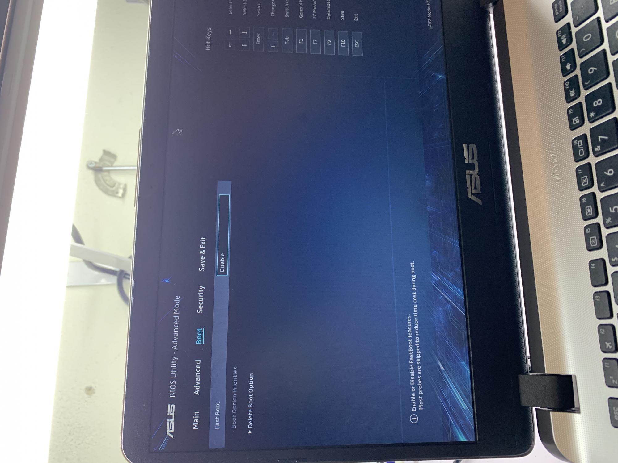

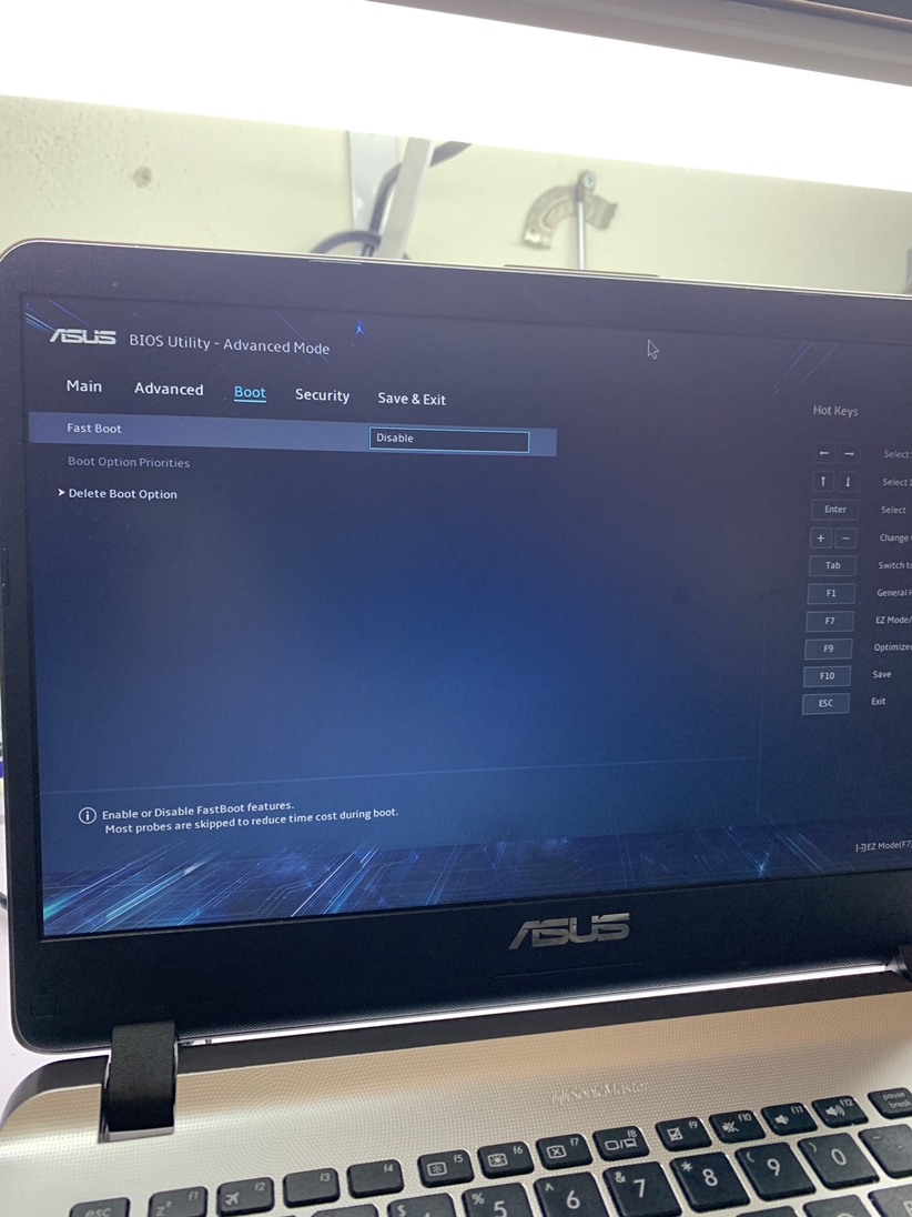

    this laptop have a problem with latest bios version 310...it cannot boot to windows, just stuck at ASUS logo...
    i did flash bios chip with the old bios version 301 and seems okay, but after few second came out notification saying "please restart to update firmware" and after i restart the laptop, system will automatically go to bios and suddenly update bios it self to 310....
    i try to reinstall windows, everything just fine as long im not "check for updates" on windows update....the only problem with the update is "Firmware Update" on it
    any ideas and solution for this without disable windows auto update? :/

    Windows installed using UEFI or CSM mode?? Newer mb's pops up a lot of error when loaded in Legacy/CSM mode.

      windows installed using UEFI ....there's no option to change CSM/LEGACY...
      maybe i found a temporary solution, i have to disable Firmware on device manager....but this problem will happen again if owner want to reset or reinstall his laptop and do updates on windows update....
