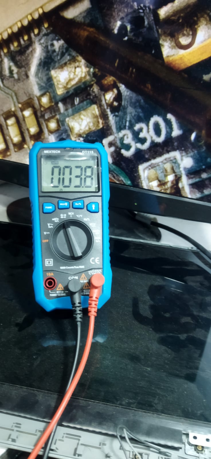

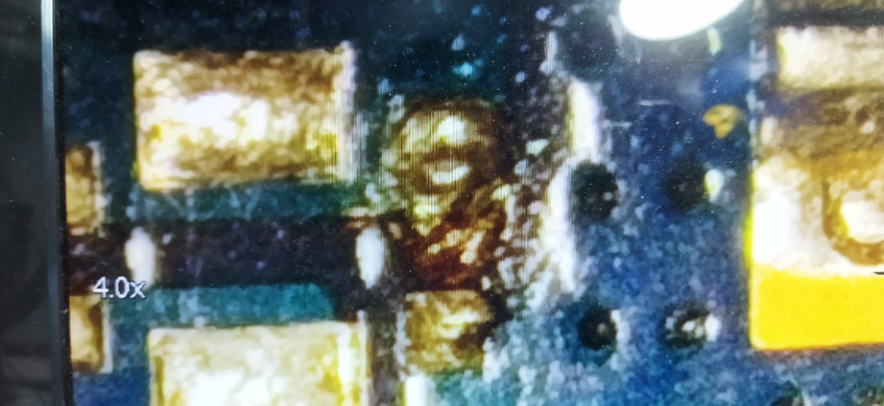

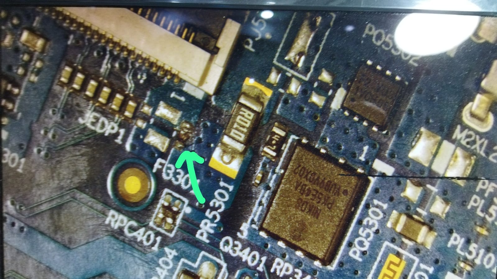

    Hello friends,
    I keep coming back for help and this community has never disappointed me. So I have this Lenovo NM-C121 board which has no display on screen. Works fine on external display though. Found one of the fuse (F3301) is burnt that supplies the power to the screen. (20 V)
    After cleaning the area I can the damage already done. The area between the pads is burnt. What bothers me that it still shows short on the edp connector side even though there is not a single component on this side ( LVDS cable is not connected )
    How can remove the short to ground when there is no component? The fuse directly connects to the edp connector. Any solutions
    PS : Pics and schematic attached

      Re: Lenovo NM-C121 board,Help remove shorting from burnt pad
      Originally posted by mon2
      Use IPA (alcohol) and q-tip (cotton swab) to remove the brown flux. Then take a clear picture and post it of the same area again.
      Thanks for the reply . Thats not brown flux but layer underneath. The top blue layer is gone.
                      So the resistance measurement is 2R5 = 2.5 ohms to ground?
                      What may be happening here is that the top pcb layer has been burnt away and the exposed layer is now layer #2 of this multilayer pcb. Often in the pcb layer stack up, the next layer (#2) will be the ground layer.
                      One of the fuse pcb pads may be touching the now exposed ground plane.
                      Continue in resistance mode on your meter and do the following:
                      1) short the meter probes. What is the resistance?
                      2) place one meter probe in the brown area of the pcb where the fuse was burnt. Other meter probe to ground on the logic board (metal shield or similar). What is the resistance?
                      3) test again with probe on metal shield and other on the fuse pad on the pcb. Resistance reading? Repeat with the other fuse pad. Resistance reading?
                      4) schematic shows 2 * capacitors on the same edp connector pins. Do you have these on your logic board? If yes, remove each capacitor and test again to see if the resistance changes.

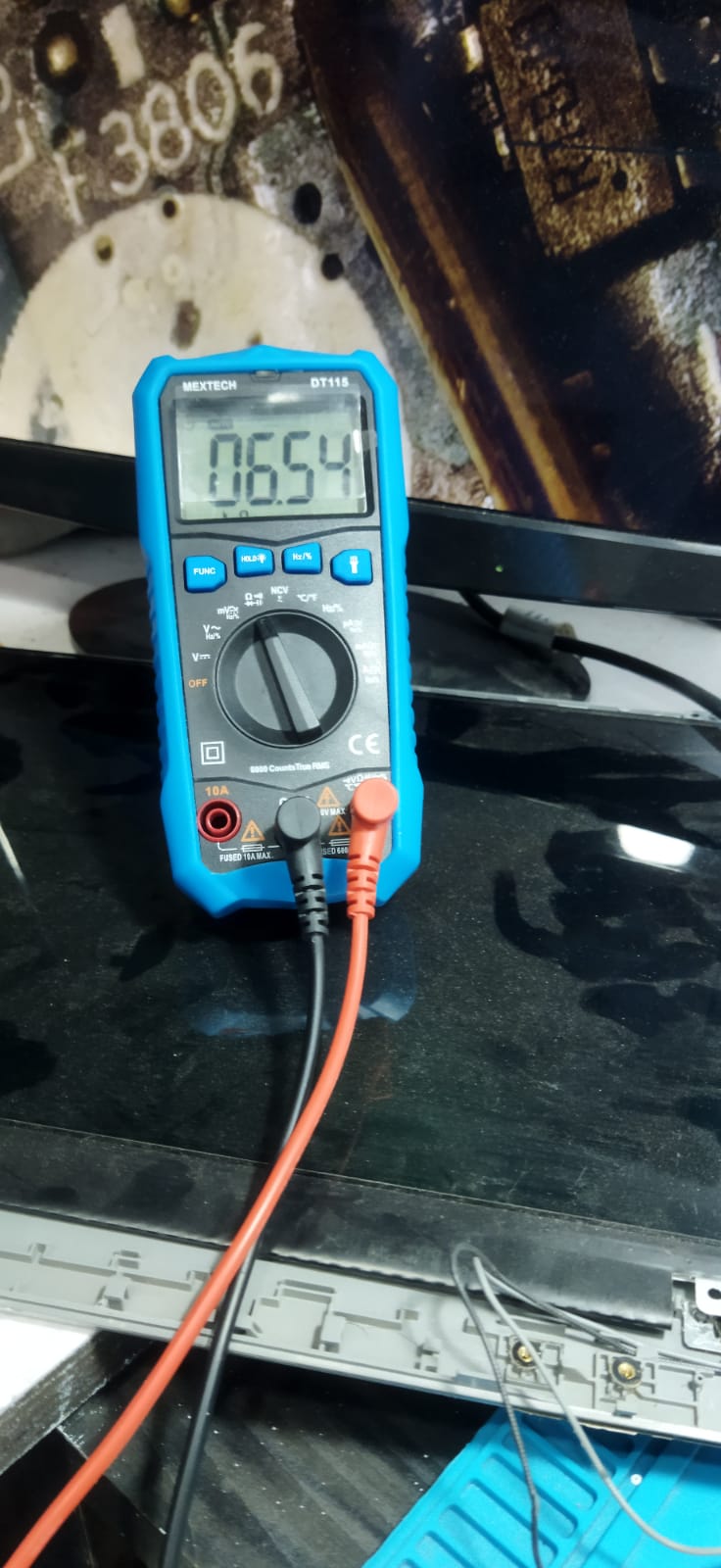

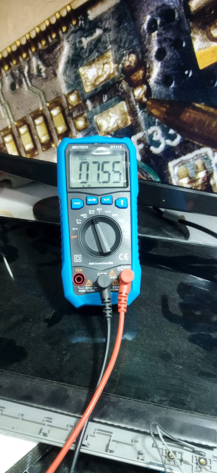

                            Originally posted by SMDFlea
                            You`ve only replied to 4) what about 1) , 2) , 3)
                            Sorry here they are:
                            1 resistance reading when both probes are connected to each other : is 0000
                            2 resistance of the brown area where the fuse was burnt
                            : 2.4K
                            3 resistance at other fuse pad : 6.5K
                            New Images attached
                                There is nothing strange in this issue. Its Ground layer exposed to pad of burnt fuse. Scrap with a sharp pointed knife unless the resistance is OL.
