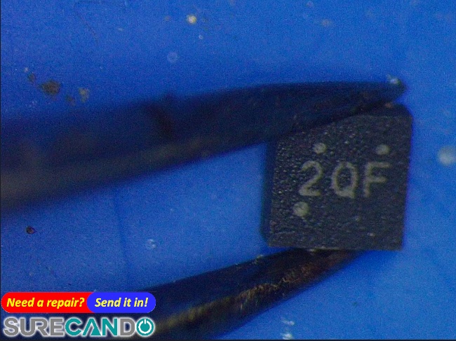

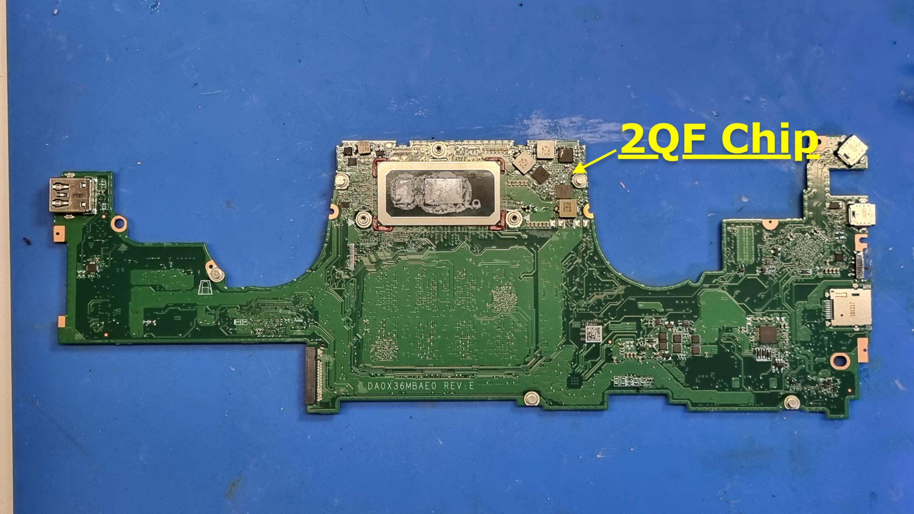

    Hi team. Looking to identify this chip.
    Motherboard: DA0X36MBAE0 REV. E
    Laptop Model: 13-AP0005TU
    Chip label most likely: 2QF
    DFN Type

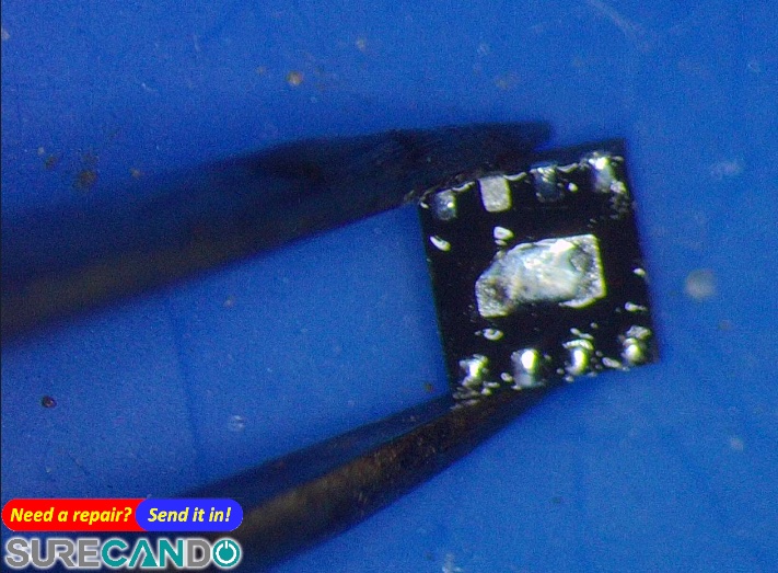

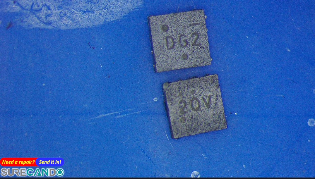

    Would these be compatible by chance? Same pin layout.

      RT9610C https://pdf1.alldatasheet.com/datash...T9610CGQW.html
      2Q : Product Code
      W : Date Code
      2QV maybe. The other chip not sure,looks like an onsemi part by the markings
