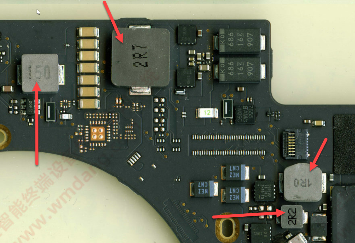

    Hello Guys,
    Namaste !
    I have a macbook 820-00850 which is not switching on.
    PPBUS_G3H is 0 Volts.
    Checked everywhere via the schematics but could not find any short. Kindly help.
    If we remove Fuse F7000, the Voltage of PPVBAT_G3H_CHGR_REG goes to 20V otherwise its also 0V

            Some part is causing this low resistance to ground on the consumer side of this power rail.
            Do inspect around for any visible signs of corrosion or liquid damage. That should be repaired if found. Use IPA to clean up such areas.
            The PPBUS_G3H rail travels throughout the logic board.
            With meter in resistance mode, still with no power. Proceed to measure the resistance to ground of each coil (inductor). Make a note of the coil(s) with a low resistance to ground.

              Can you name a few coils please?
              • mon2
                • Dec 2019
                • 13894
                Re: 820-00850 Dead
                See attached. The coils will be the rather large 2 legged part and often grey in color. Attached are 4 examples on your logic board.
                Each coil (aka inductor) is linked to a local power supply IC.
