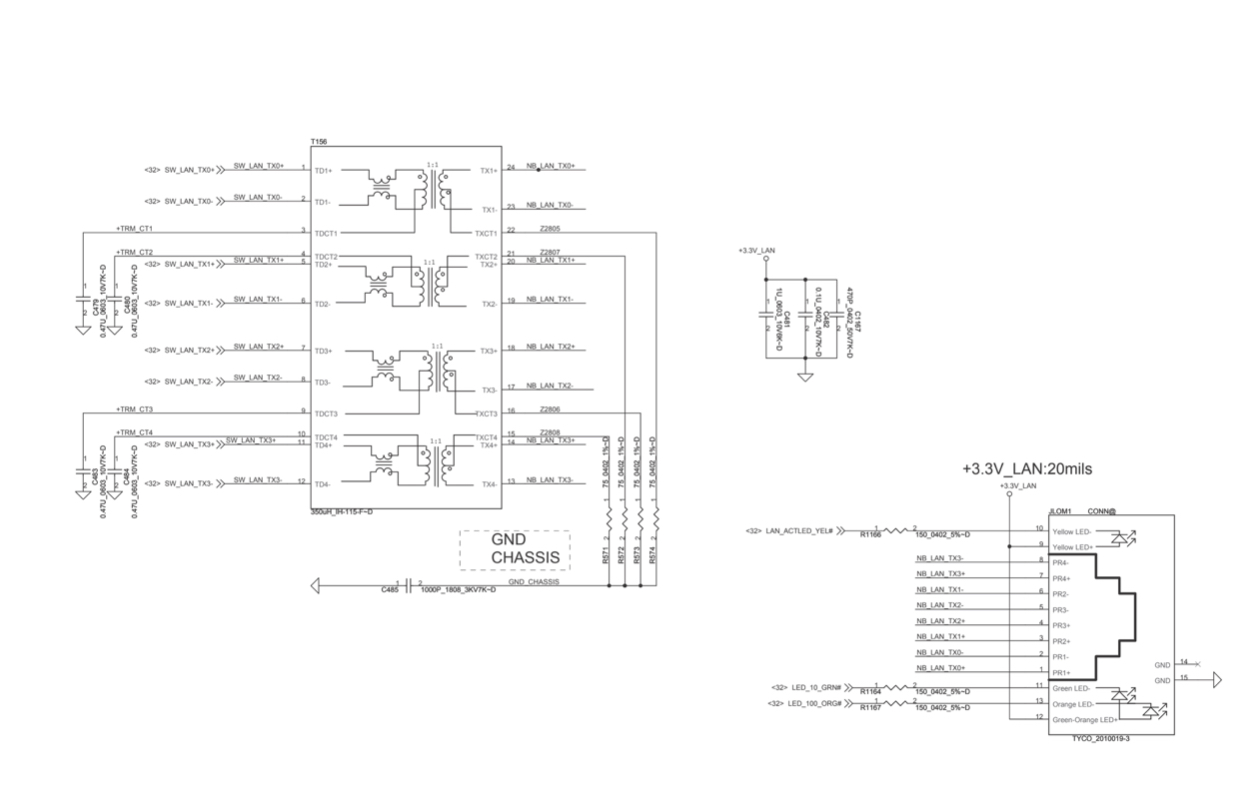

    Hello, I've got Dell E 6520 LA-6562P rev. 2.0 without T156 (lan transformator). Can you help me with replacement this item ? What symbol is it.
    Can i connect this shortly ( or how) to test LAN on Windows ?

    Have you checked Schematics??? See this attachment. It will help.

      Thank, This is correct ?
      1 - 24
      2 - 23
      5 - 20
      6 - 19
      7 - 18
      8 - 17
      11 - 14
      12 - 13
        Re: Dell E 6520 LA-6562P rev. 2.0
        What is the speed of this ethernet port ?
        LAN transformers are quite common and available on the market.
        But first, need to know the speed.
