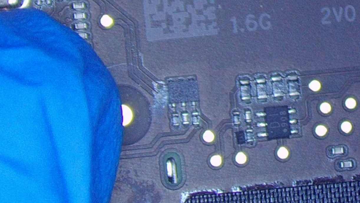

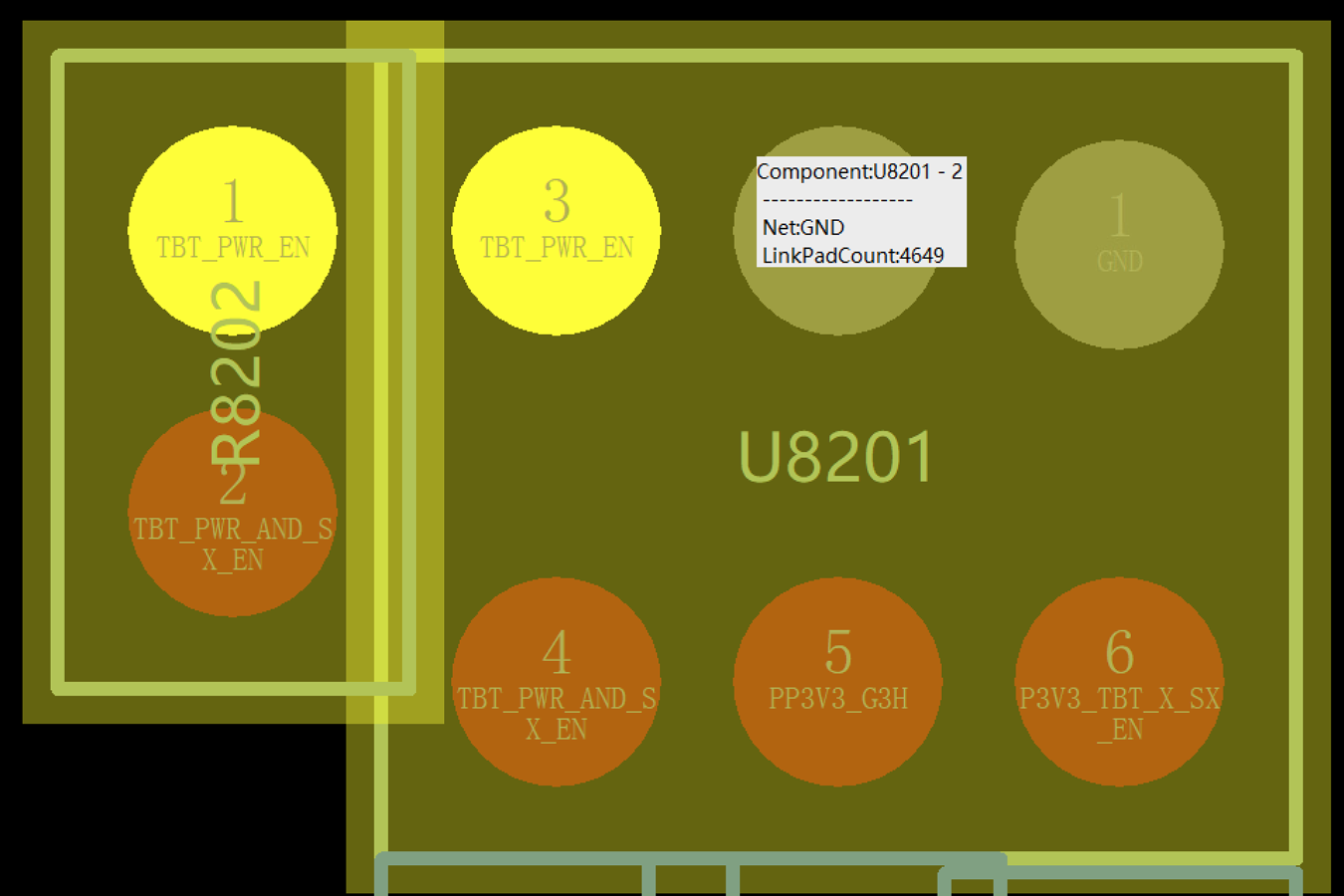

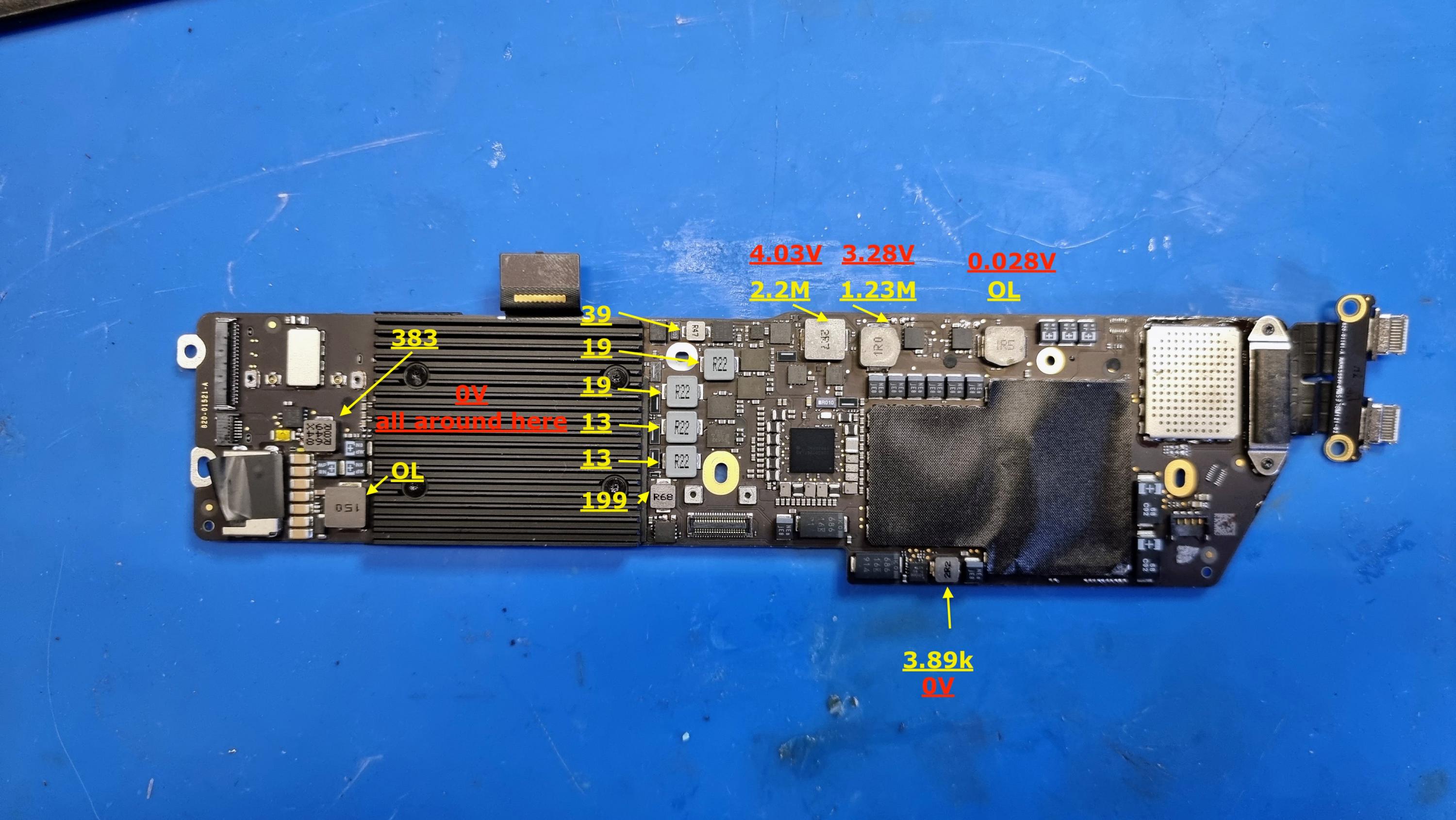

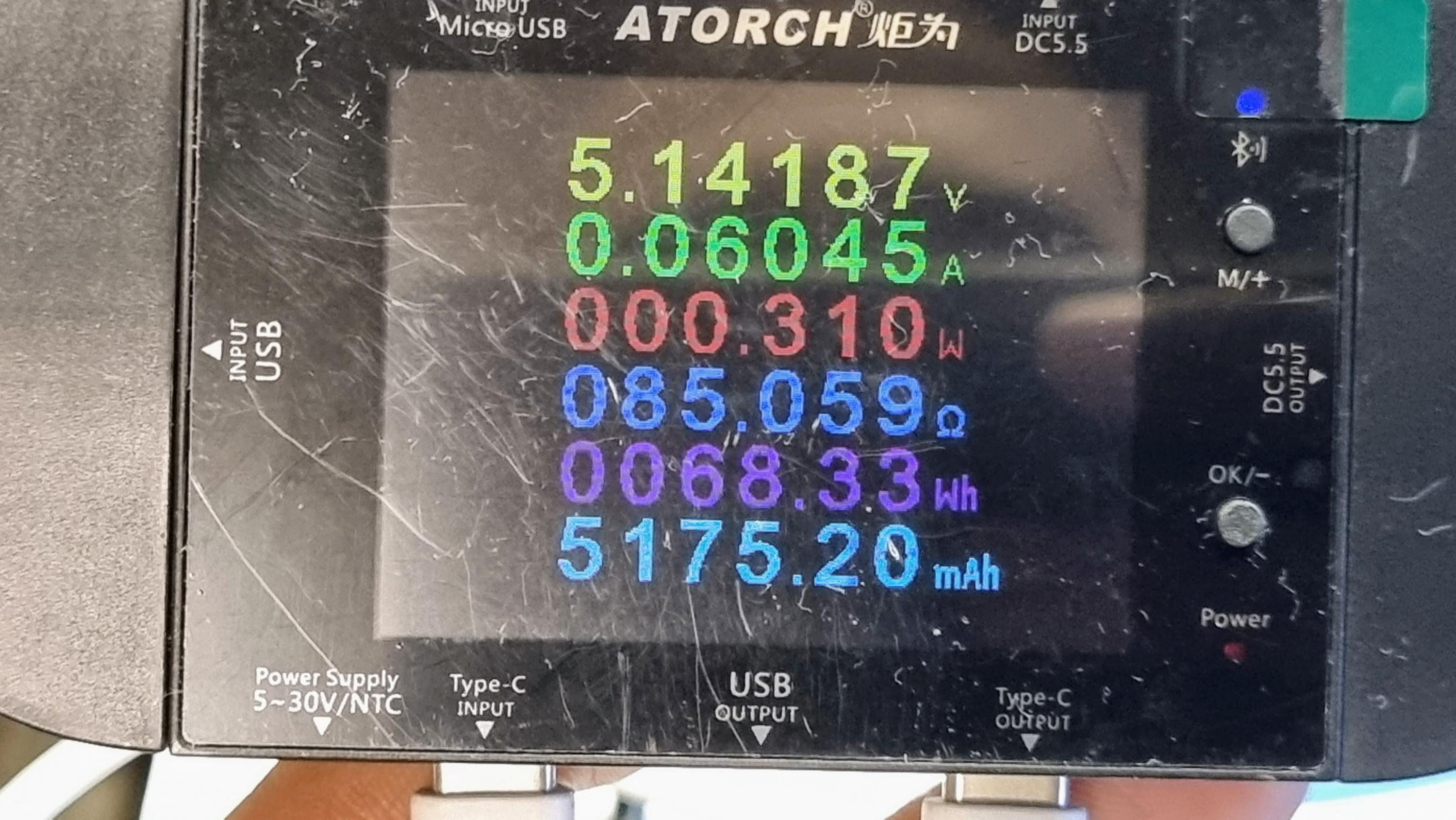

    MacBook Air 2018 A1932 820-01521 Not turning on.
    MODEL: MacBook Air 2018 A1932 820-01521
    Problem: 5.12V / 0.60Amps
    History: Unknown but I can see slight liquid spill on IC U8201/74aup1t97gm
    Things tried: I've cleaned the liquid area, removed the IC U8201/check pads, good/ chip looks good, put back. Replaced CD3215C x 2 times, so 4 new chips just in case. I've attached photo readings of V/resistance and signals as per logi wiki website. Please advise what I can check next. Schematics available upon request.

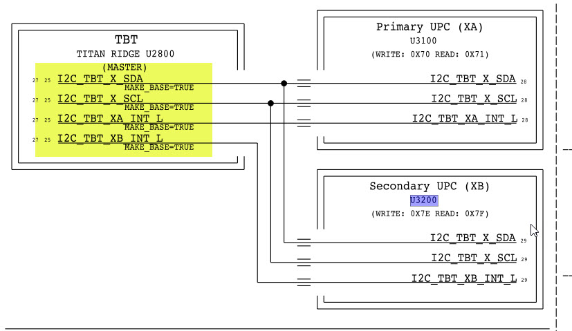

    Re: MacBook Air 2018 A1932 820-01521 Not turning on.
    Each CD3215 controller (U3100 / U3200) must be working before the 20V can be enabled.
    https://repair.wiki/w/A1932_2018_-_2019_MacBook_Air
    * voltages on the CD3215 look ok - the BMC rail will be enabled for the port used to power the logic board.
    1) Check the voltage of PPBUS_G3H.
    2) Check the voltages of the I2C bus lines that mate with the U3100 & U3200 via the TBT bridge.

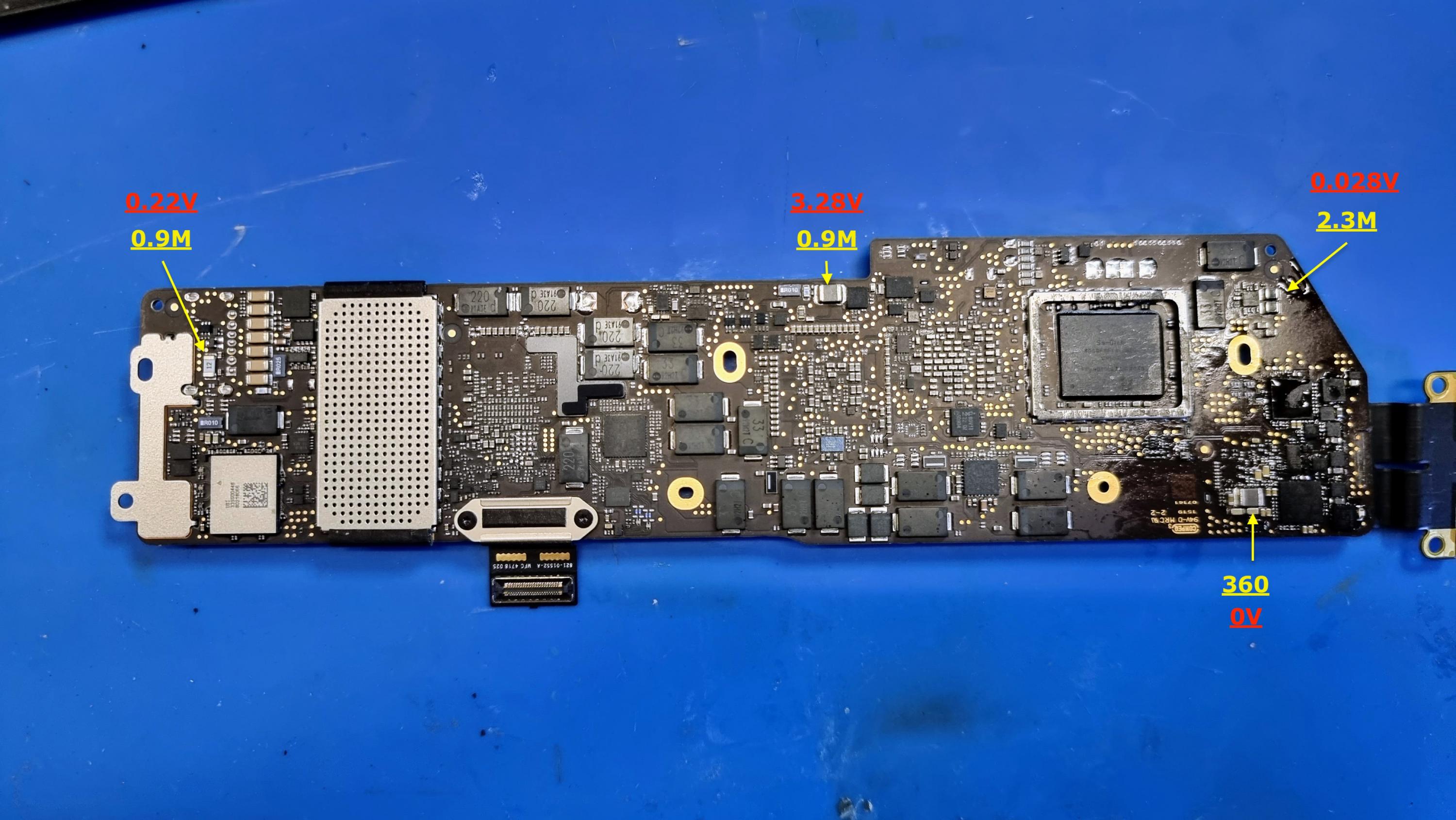

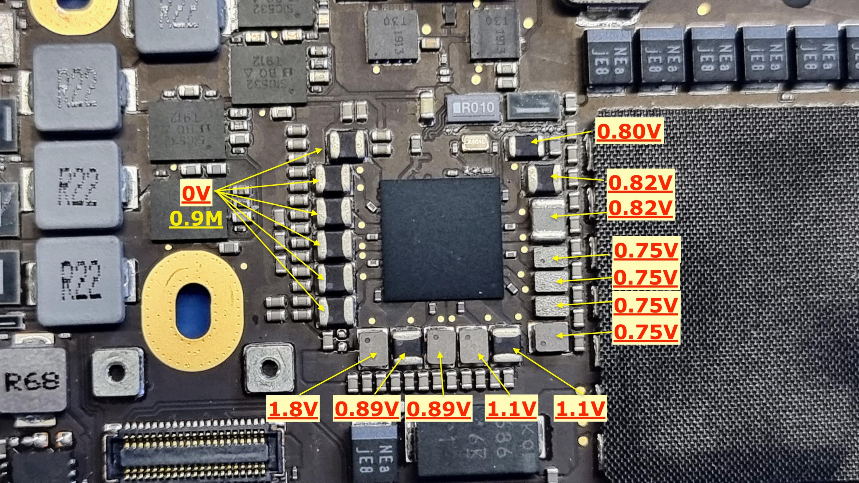

      0.60Amps looks like there's a short on the board somewhere. check all the power rails one by one. If you have infrared camera make it easier to locate the shorted caps.
        1) PPBUS_G3H 12.17V.
        2. All are 0V. Resistance of them for your refence:
        I2C_TBT_X_SDA 32K Ohms increasing
        I2C_TBT_X_SCL 32K Ohms increasing
        I2C_TBT_XA_INT_L 3.63M Ohms
        I2C_TBT_XB_INT_L 3.63M Ohms
        I have reflashed the TBT ROM. No change.

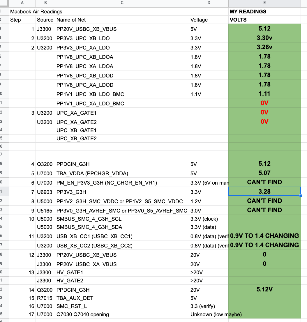

                      • sikocan
                        • Oct 2019
                        • 344
                        PP3v3_G3H_RTC goes to pin 62 of u3200, pin 62 on u3100
                        Both readings are hard to focus on, but resistance mode is varies between 5kohms to 1.5M ohms between.
                        • sikocan
                          • Oct 2019
                          • 344
                          Removed caps on both c3100 and c3200
                          Same result
                          • sikocan
                            • Oct 2019
                            • 344
                            PP3v3_G3H_RTC is now 3.2928
                            • mon2
                              • Dec 2019
                              • 14660
                              Good. Now this is the expected voltage. One of the removed caps must have been bad.
                              What is the voltage now of ppbus_g3h ?
                              Check voltage of PPDCIN_G3H on each of the ports (cd3215).
                              • sikocan
                                • Oct 2019
                                • 344
                                I'll now replace both caps and test again
                                • sikocan
                                  • Oct 2019
                                  • 344
                                  ppbus_g3h 12.268v
                                  PPDCIN_G3H 5.122v
                                  I've replaced both caps.
                                  • mon2
                                    • Dec 2019
                                    • 14660
                                    Measure the voltage of:
                                    PP3v3_UPC_XA_LDO
                                    PP3v3_UPC_XB_LDO
                                    • sikocan
                                      • Oct 2019
                                      • 344
                                      PP3v3_UPC_XA_LDO 3.33
                                      PP3v3_UPC_XB_LDO 3.26
