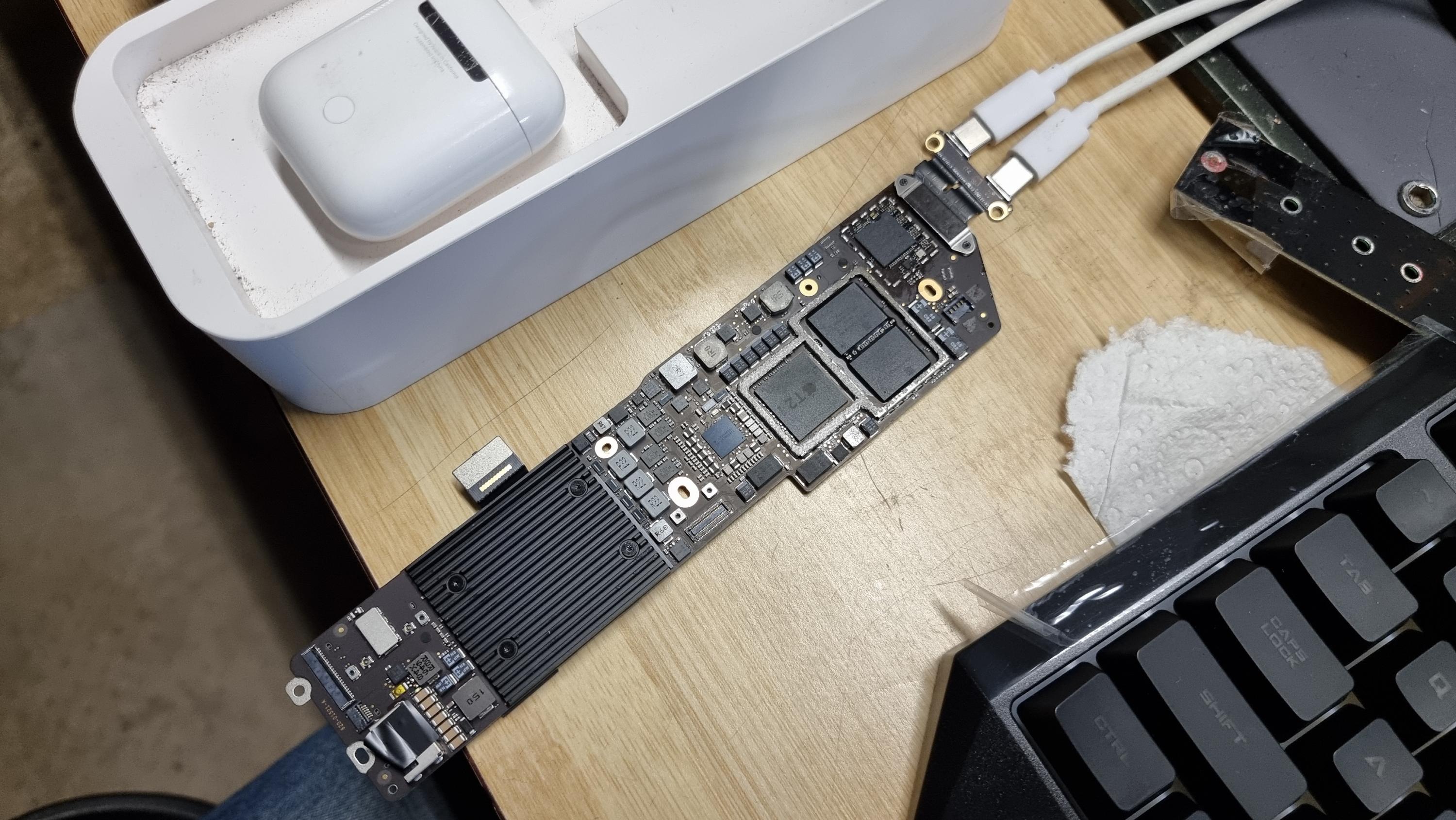

MacBook Air 2018 A1932 820-01521 Not turning on.

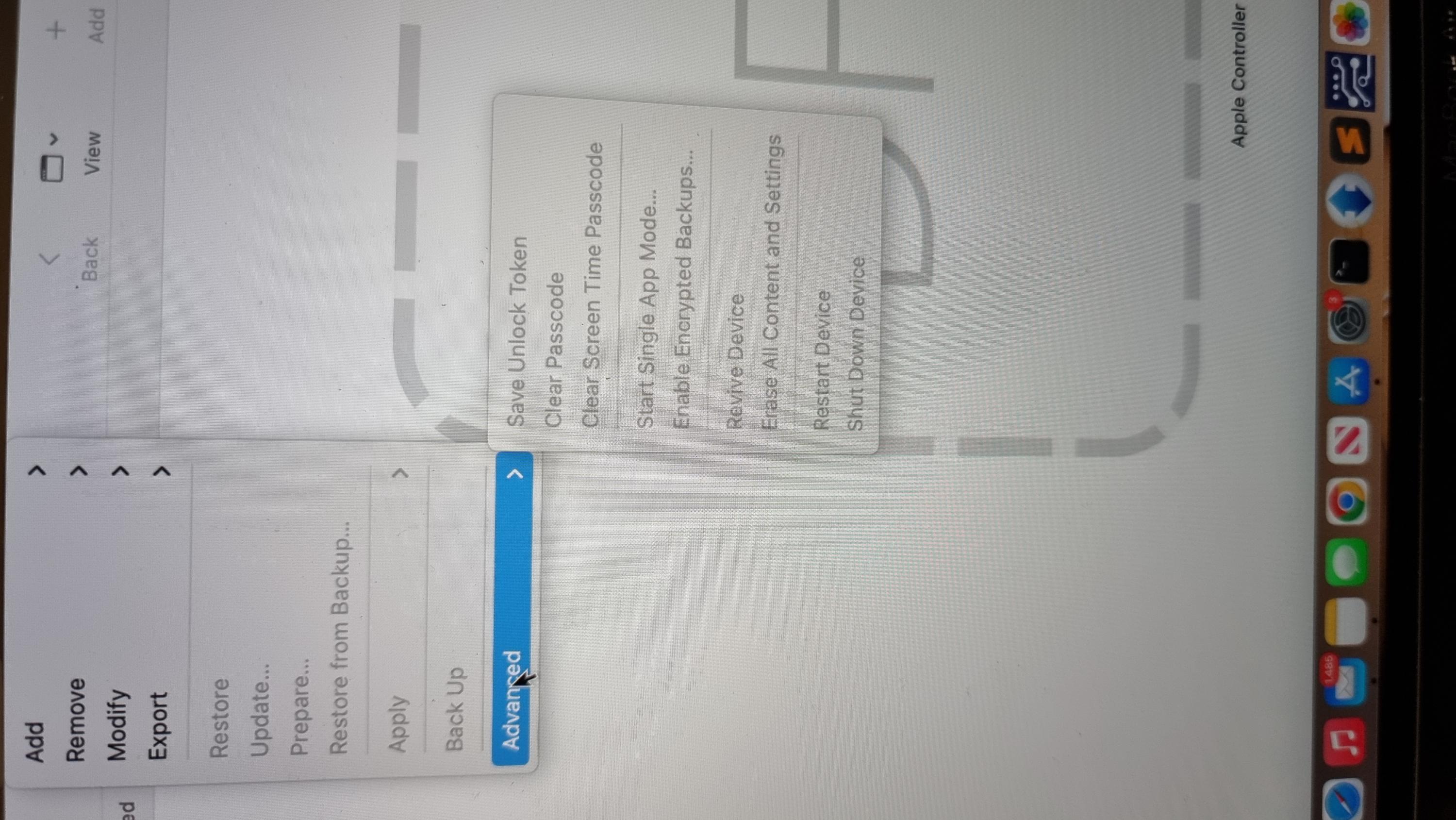

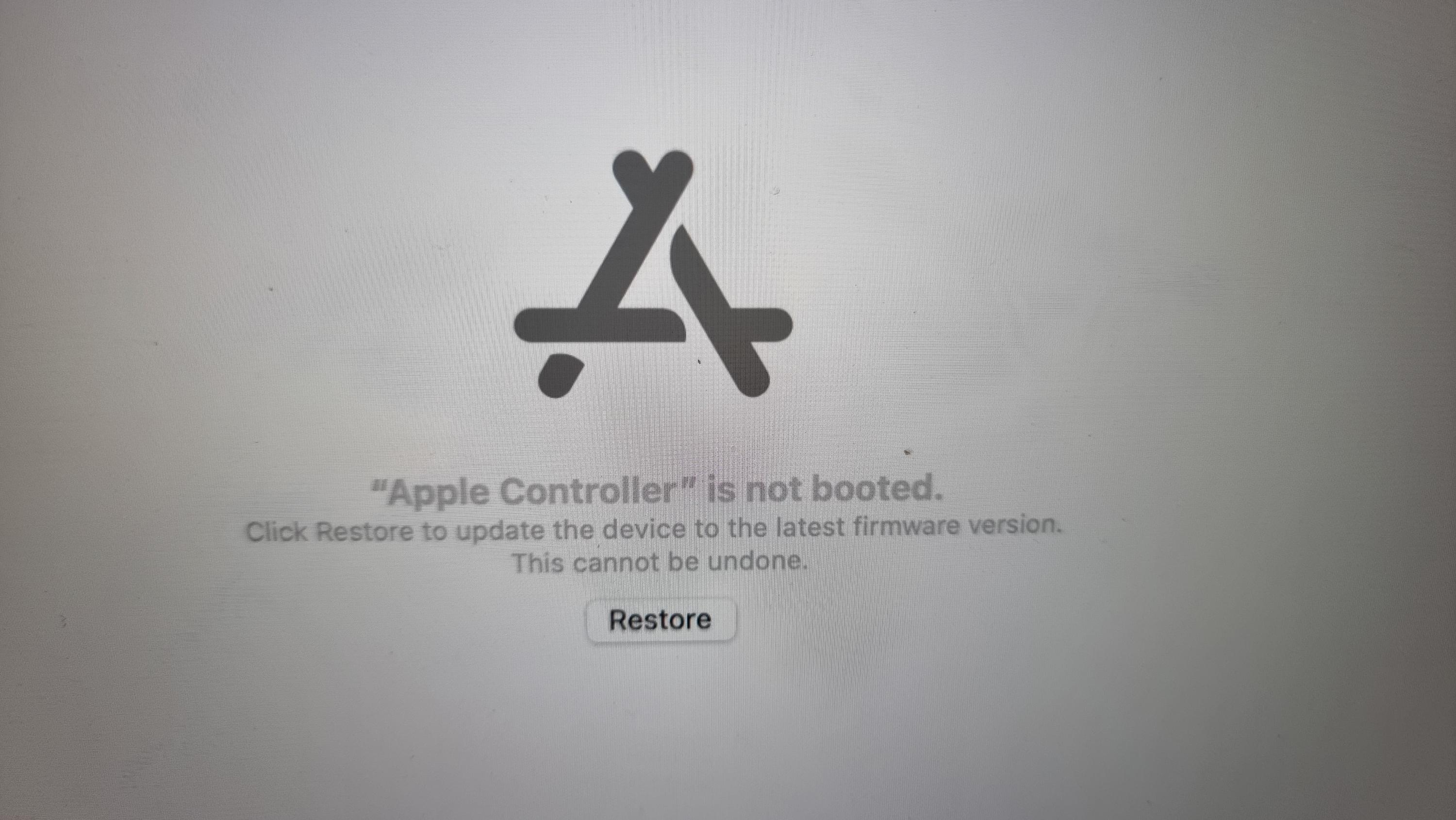

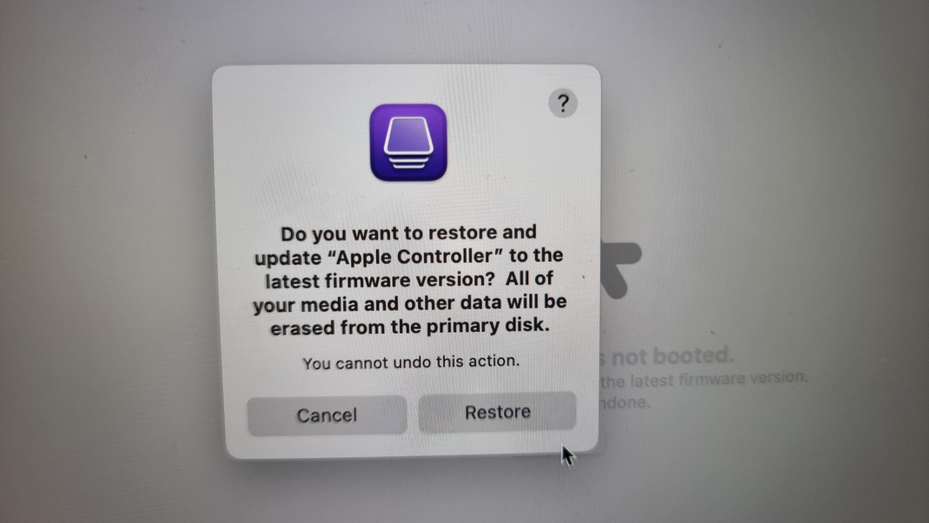

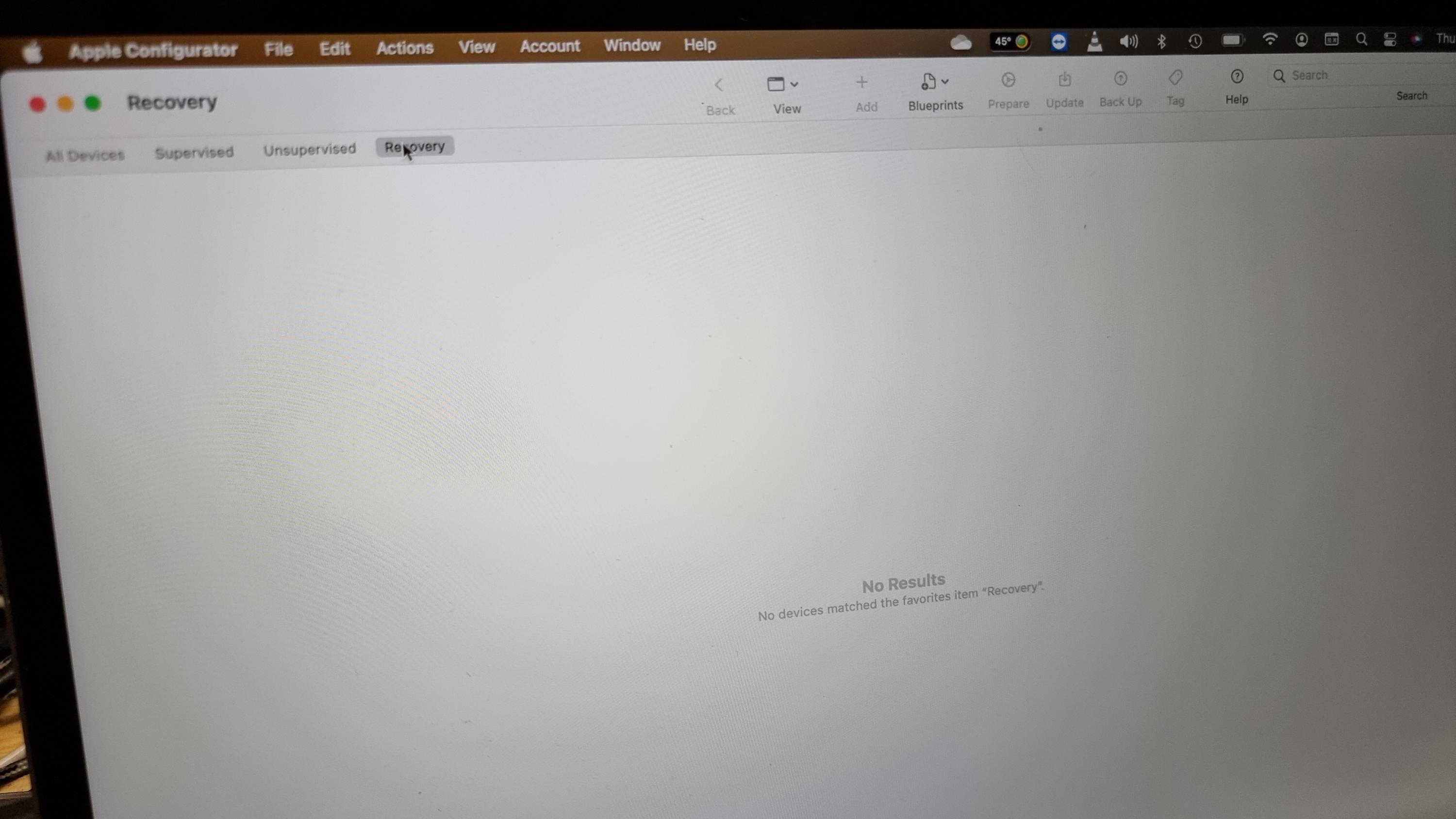

      Re: MacBook Air 2018 A1932 820-01521 Not turning on.
      Loooong 30 mins... still waiting for client to see if Data is important as this step would wipe the drive.
      • piernov
        • Jan 2016
        • 4439
        • France
        Revive/update keeps data, restore wipes data. In case of corruption or damaged SSD, data could already be gone anyway.
        • sikocan
          • Oct 2019
          • 344

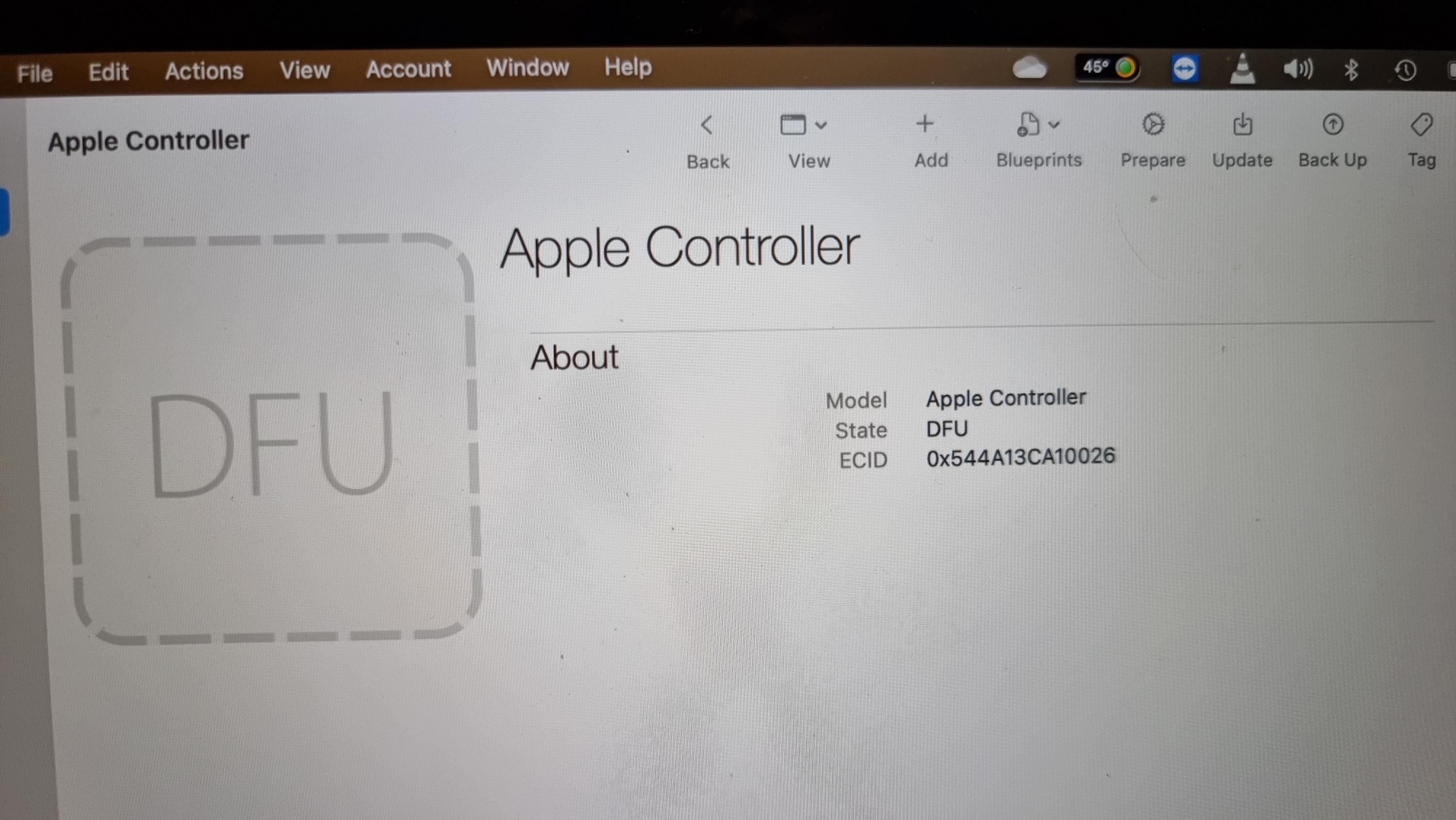

          I can't revive device. It does detect MacBook computer. Here are pictures. If I restore firmware, it'll wipe.
          • duwane
            • Mar 2022
            • 57
            • New Zealand

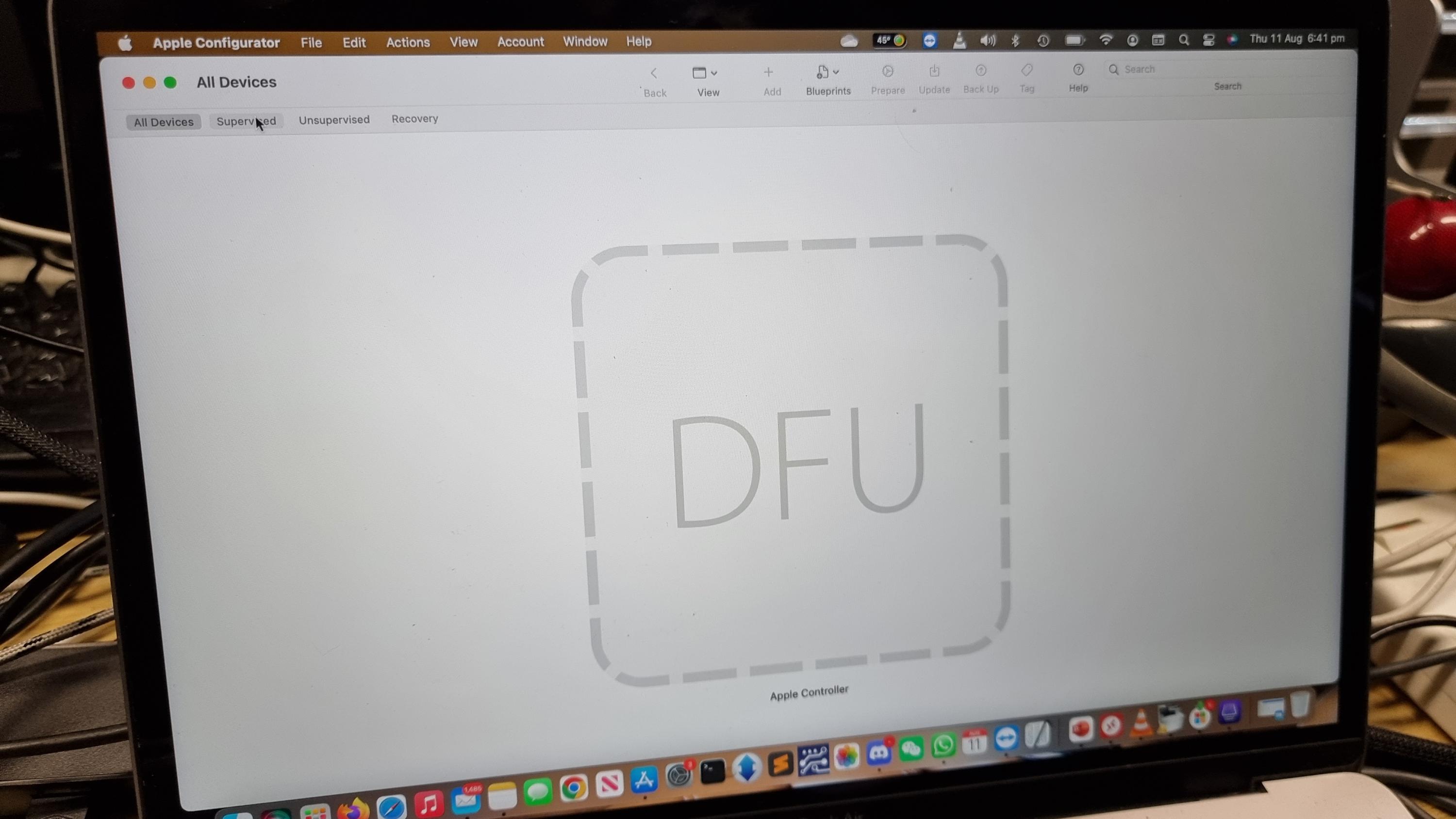

            What machine are you running the configurator software on? I had something similar with a 1932 that I restored.
            I know that Apple's information gives a minumum version of software of like Catalina or something similar, and says you can use any machine to run configurator on, but I found I needed a machine that had only USB-C ports, and ran the latest patched version of MacOS available for the machine I was using.
            • Arshad alam4659
              • Aug 2020
              • 157
              • India
              Originally posted by sikocan
              ppbus_g3h 12.268v
              PPDCIN_G3H 5.122v
              I've replaced both caps.
              Hi I have same board and check ppdcin_g3h 20 v
              Need help no power
                Hi I have a same board a1932 if battery and charger connect l7030 heating need
                help
                  What is the history of the unit?
                  Inspect the board to see if there is any liquid damage or damaged parts.
                  20v is good for the adapter voltage. Be sure the adapter is the suitable power rating for use on this unit.
                  Measure the voltage to ground of ppbus_g3h.
                    Ppbus_g3h 12.19v and and pp3v3_s5 is 3.16v

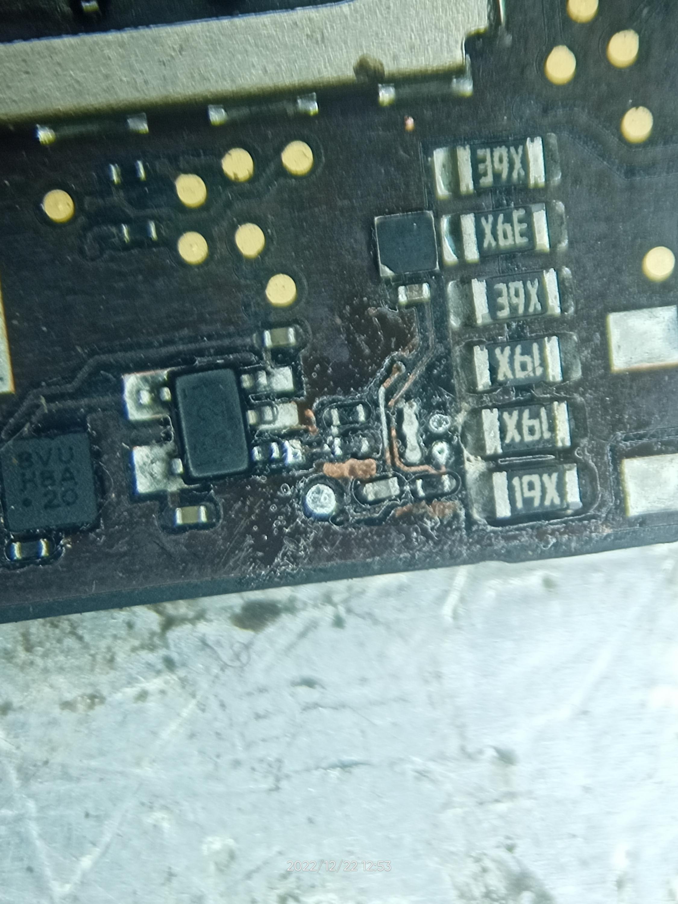

                      Here is one ic is missing
                      • Arshad alam4659
                        • Aug 2020
                        • 157
                        • India
                        #31
                        What is the check if l7030 is heating
                        Someone help me
