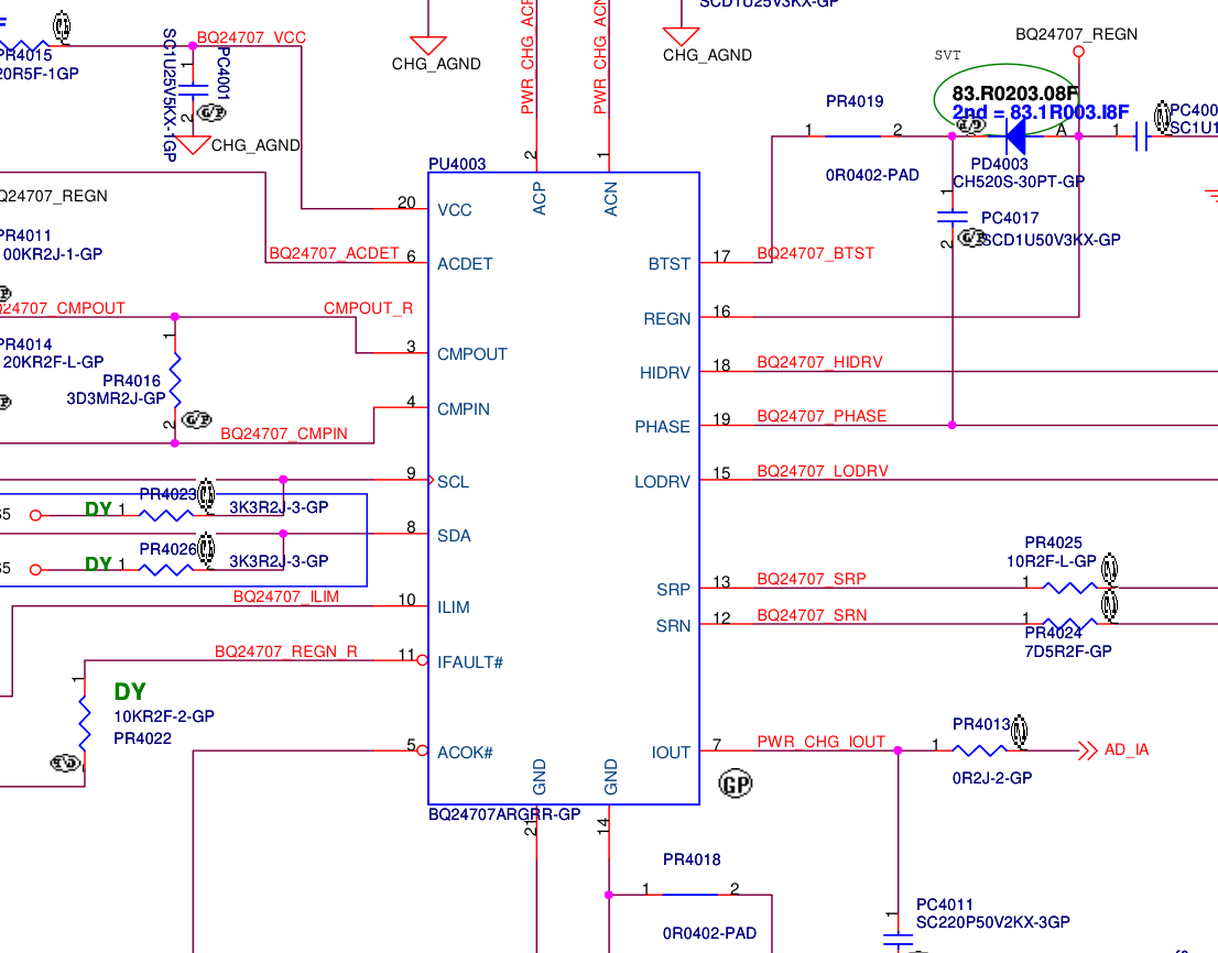

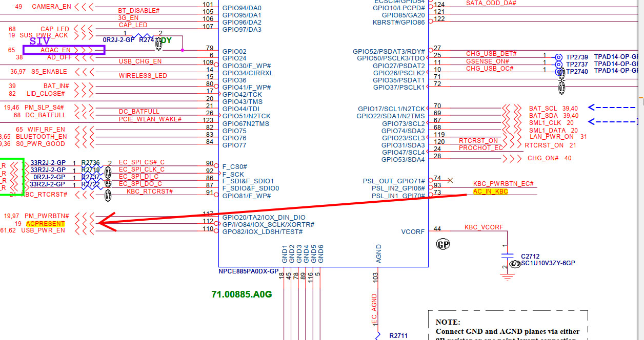

    hi everyone, I am working on lenovo G480 code board = LG4858L UMA MB 12206-1
    measurement results:
    32MHz is ok
    ACOK# = 0
    5V Alw = 5 V
    3.3 Alw = 3.2
    PGood = 3.2
    Ac_in_kbc = 3.2
    ACPresent – 0 V
    did I correctly mark the image as signal path?

    Post the voltage reading from this ic.

      In some mobo ACPRESENT will available after RSMRST#
      Ad_id available on KBC?
      Check KBC requirements lid_swicth, vcc, ec_rst# etc then check the trigger logic and see if RSMRST# is available and the SLP signal generating
