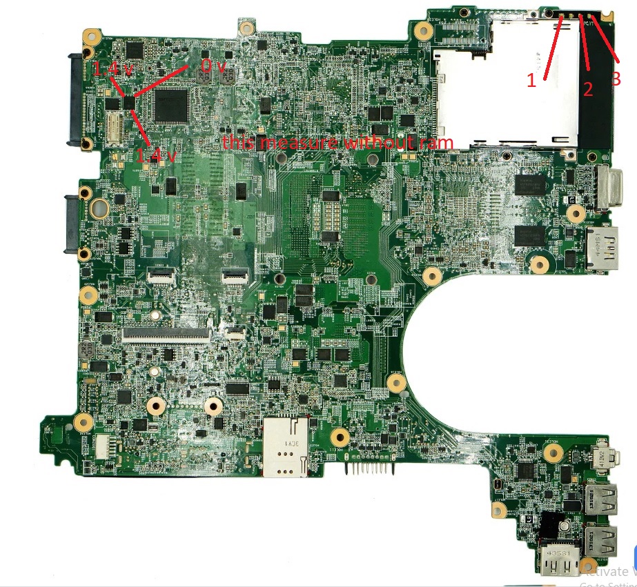

    hi
    i ve hp 8560p with problem
    when i remove ram . lap work fine ( sure no display ) but fan turn normal and no start . and cup get normal hot
    when i connect ( put) ram fan turn high sound and laptop always restating
    change more than 10 ram no new
    flash bios no new
    coil L3201 1.5 volt
    but when i remove ram ( laptop) without ram i measure Q3202 fount D 1.4 - S 1.4 G = 0
    put when i put ram in socket D = 1.4 - S = 0 - G = 0
    changed this mosfet no new
    there is no schematic for this model
    please help

    What are the silk screened markings on the logic board?
    Can you post pictures?
    Without ram, do you hear any post beep codes? Any blinking led pattern to note that the ram is missing?

      this is the motherboard photo
      in the picture number 11 . the led number 1 always on with ram but without ram on for 1 sec and off
      led 2 and 3 alwyas on with ram or without ram
      this mosfet measure without ram
      but with ram no volt on source
      i just have only motherboard no more

        can any one tell me the most important pins on ram ddr3 socket ?
        • mcplslg123
          • Jun 2015
          • 7262
          • india
          Re: hp 8560p proplem please help
          VRef_DQ =PIN 1
          VTT/Termination voltage=PIN 203,204
          VRef_CA. =PIN 126
          VDD SPD =PIN 199
          SDA data =PIN 200
          SCL clock =PIN 202
          DRAM_RST# =PIN 30

            Do a clean me region or flash a new BIOS, that's the first thing you should do
